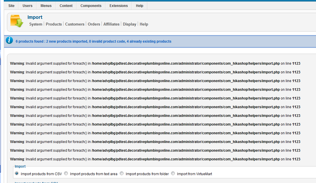

I cannot get an import of variants to work...
I created a test product, then a Characteristic with a couple of variants, and assigned this to the product.
After saving all this, I did an export and attempted to add several additional variants following what the export showed.
When I imported this, here is what showed....
Here is the file I imported...
What am I doing wrong, please!?!

13 years 11 months ago #61689
I fixed some parts of your CSV, but make sure that you realy have the white and gold values into your finish caracteristc.

13 years 11 months ago #61896
I don't find any foreach on my end on line 1123 on 1.5.8 of that file where the message comes from.
Could you give the text that you have on that line ?

13 years 10 months ago #62039
That's because of the line:
}elseif(isset($product->$type)){
which is now:
}elseif(isset($product->$type)&&is_array($product->$type)){
in the latest version of Hikashop.
If you change that these errors won't happen.
