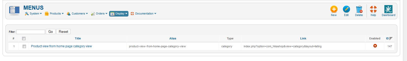

13 years 11 months ago #61663
Could you make me a screenshot of your menu listing?
The number 101 may be found in the ID column on the right.

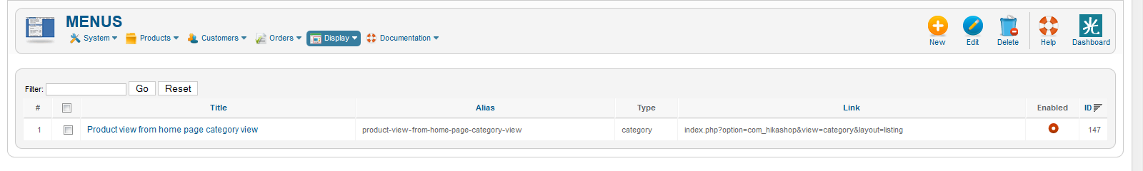

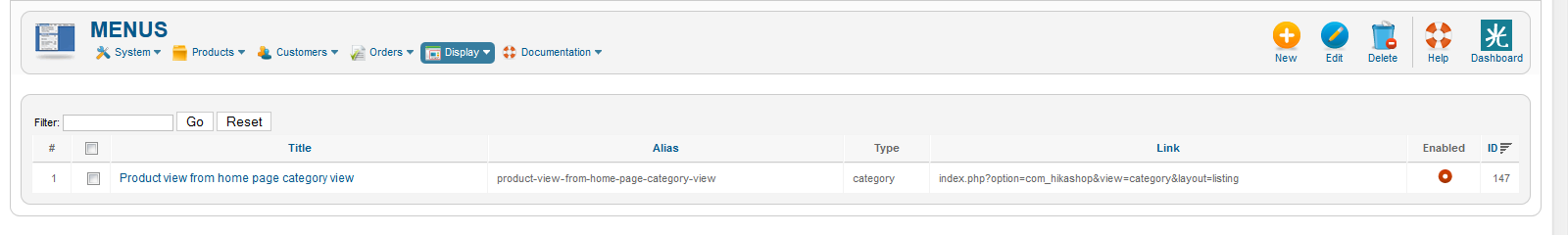

  • Posts: 38
13 years 11 months ago #61676
Hi Eliot
Here's the screen shot. No 101 ID.

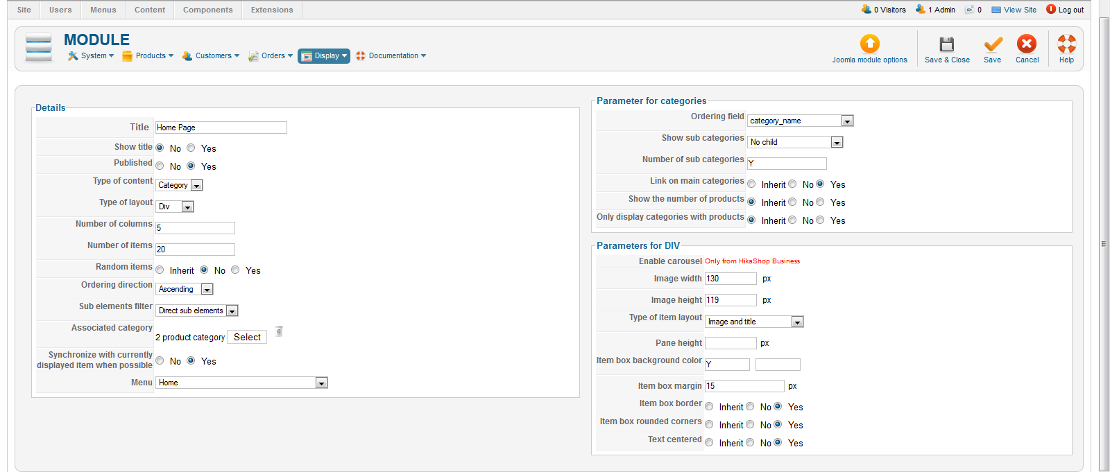

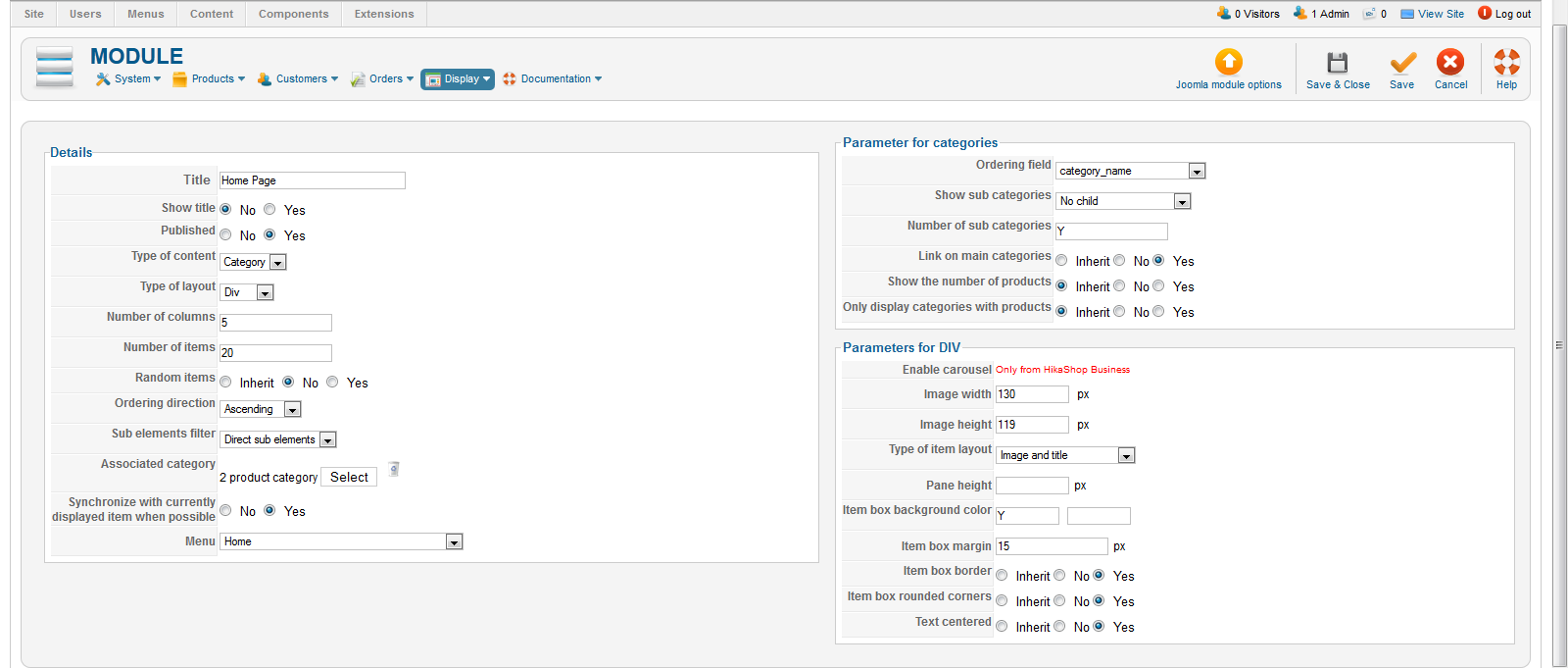

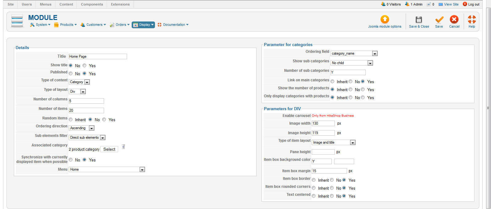

  • Posts: 38
13 years 11 months ago #61717
Hi Eliot
Here it is. Thanks for all your help.
  • Posts: 2334
  • Thank you received: 403
13 years 11 months ago #61732
I see the problem, you associated "Home" to the menu option in your module, that's why your sub-categories aren't loaded well. This menu isn't a Hikashop menu so no parametres are setted.
There are two solutions to your problem:
-Choose another menu to associated (an Hikashop one that you will be able to parametre as you want)
-Change the default parametres for module display in the main configuration of Hikashop. These parametres are the one loaded when no parametres are found. You can do this in Configuration>Display>Modules main default options

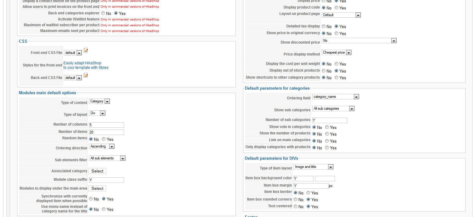

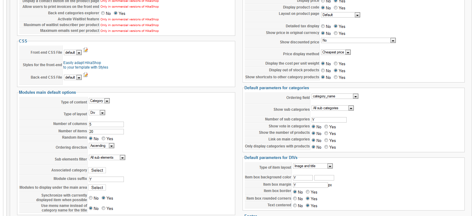

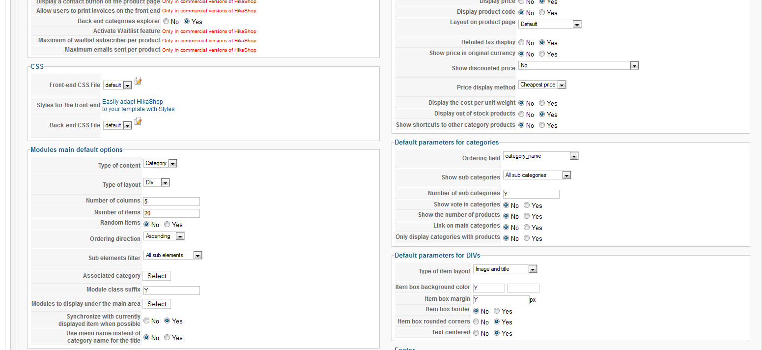

  • Posts: 38
13 years 11 months ago #61748
Hi Eliot
Many thanks for this.
Unfortunately I'm not sure what you mean.
Regards the default settings for module display, i've attached a screen shot.
  • Posts: 2334
13 years 11 months ago #61753
Sorry for my mistake, it can't work since it's the module option and you are using a menu.
In this case the solution is to create a new hikashop menu (Display>content menu) with the parametres you want and set it in your module instead of "Home" (bottom left of the module configuration).
