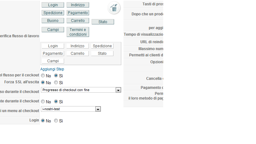

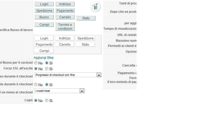

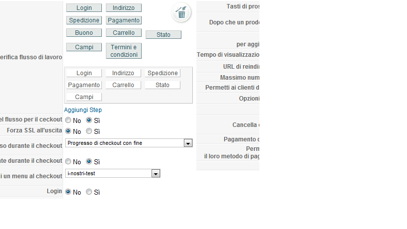

  • Posts: 70
13 years 10 months ago #62303
here's my workflow, I do not think we need to change something.
Bye
