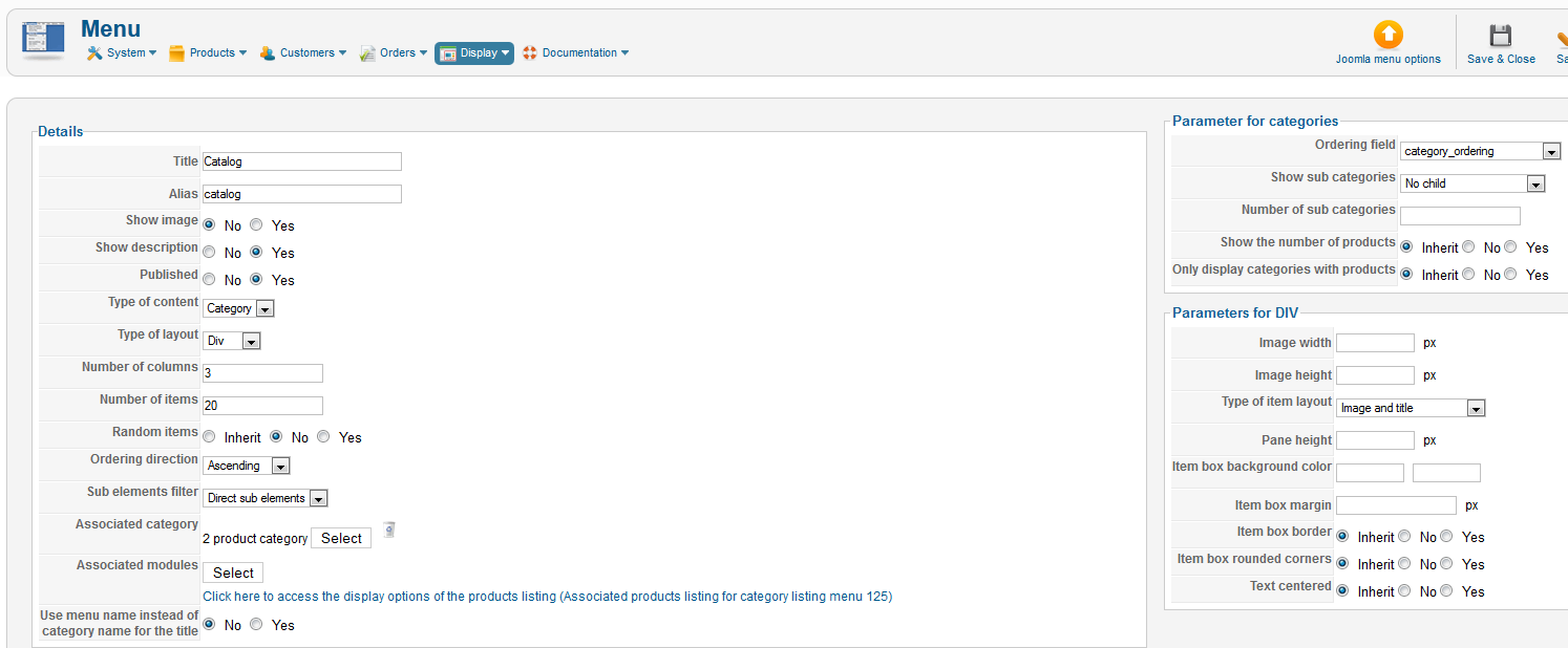

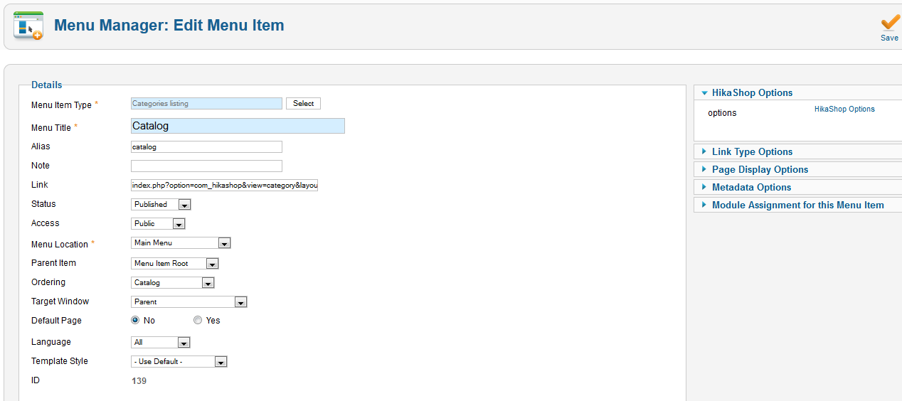

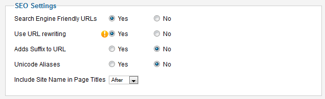

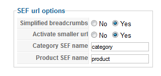

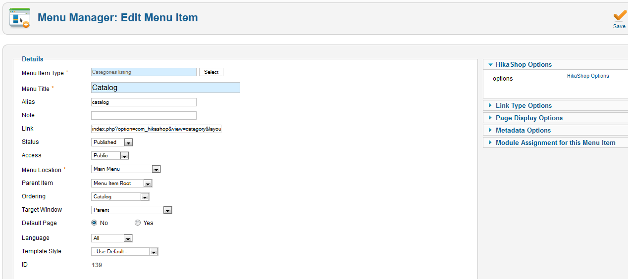

Can you do a screenshot of the joomla options of your menu item so that we can see that ?
  • Posts: 37
13 years 10 months ago #62280
My menu items look like this in the url with 404
test.mydomain.com/Categories/catalog
You default menu items look like this
test.mydomain.com/hikashop-menu-for-products-listing

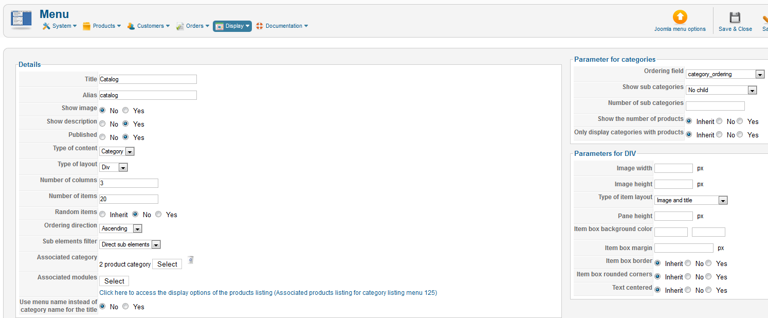

I have attach pictures for what you asked and more. I tried mimicking your menu settings but no lock. I even created a new item inside your default menu and still no luck. I am sure I am just missing something simple.

In the mean time I will give you all the info you asked for, just in case you see something. I was just using default Joolma SEF, see below
