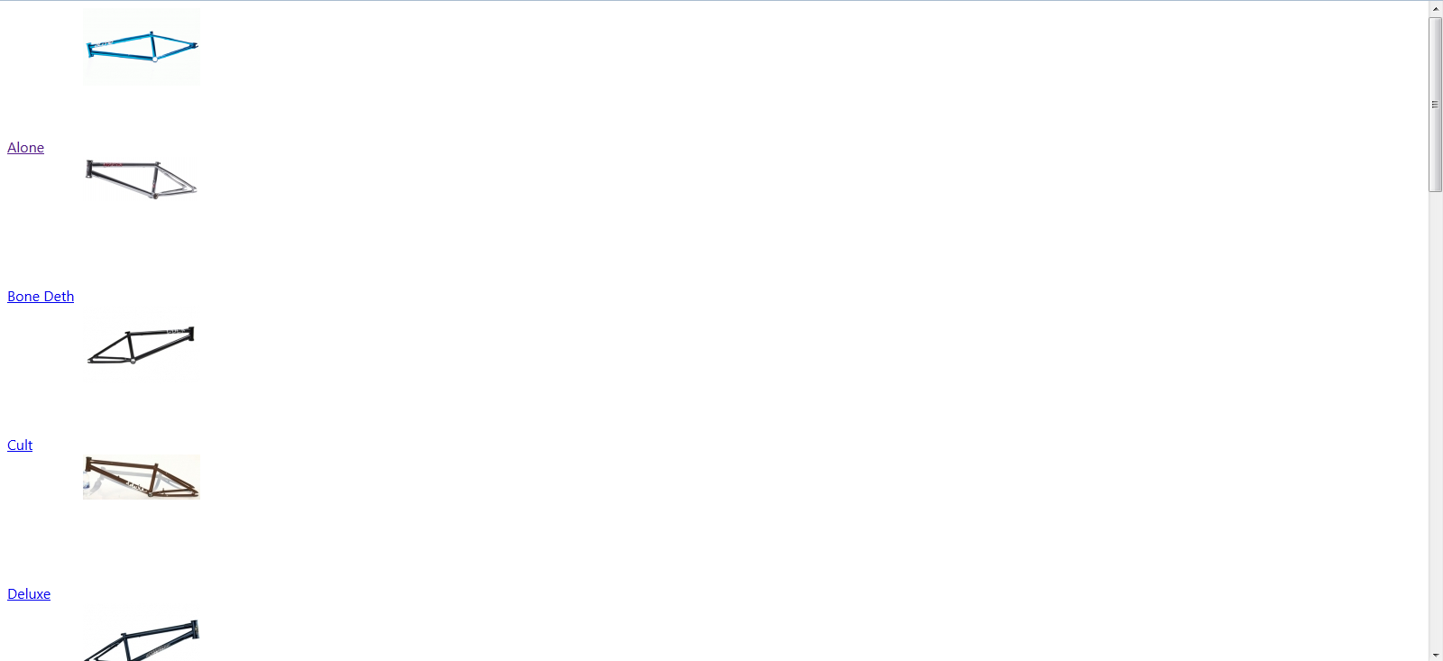

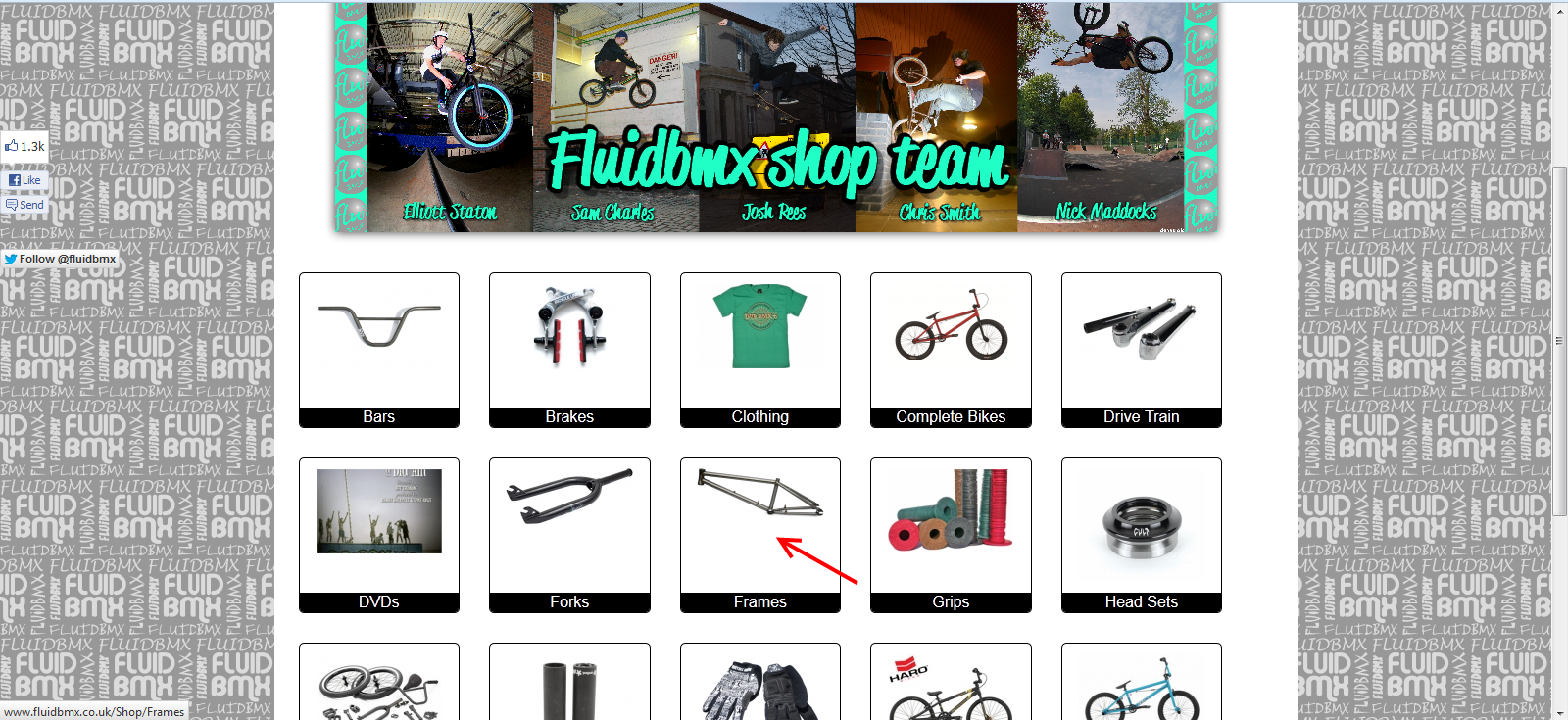

Can't work this out! All pages and category views dispaly as they should except for one category view!! When you click on this particular category the next sub category view loses all CSS. Does anyone have any ideas please?

You do not loose CSS, you have a PHP error which broke the page.
Please check the bottom of your page, an error could be display. If not, you would have to activate the debug mode in Joomla in order to see the PHP error.
At this moment we would be able to help you to fix it.

I have to add that it's only 1 category view that has broken. This seems to have happened after installing and configuring SH404SEF.
