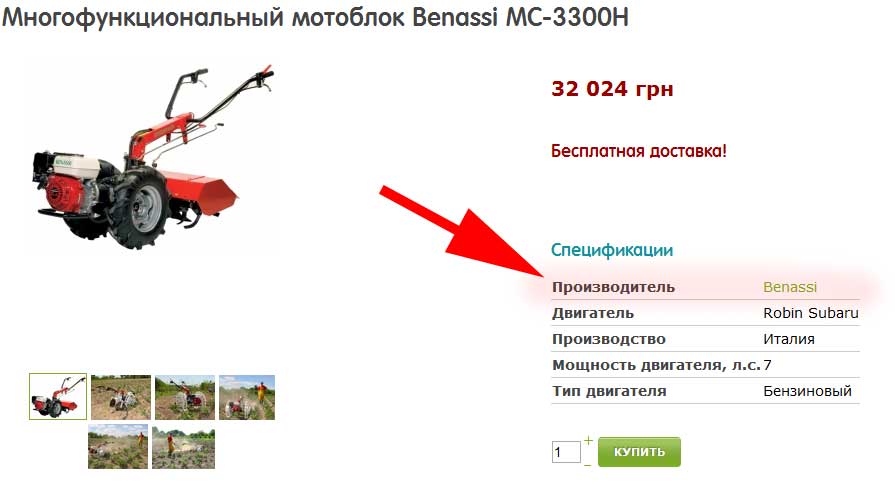

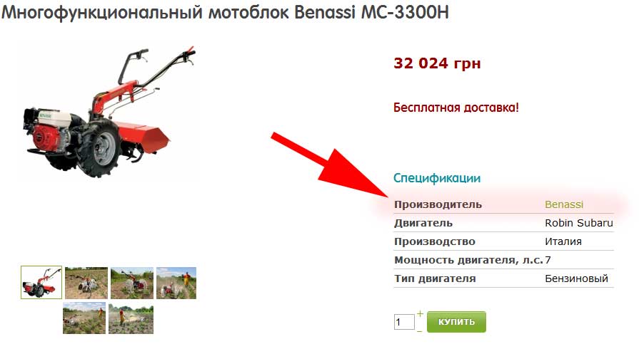

  • Posts: 120
13 years 11 months ago #64217
Nicolas, thank you!
I have managed to have the below code, which creates a link to Manufacturer's page. It shall be inserted into view product/show_block_custom_main after the row <table width="100%">:
<?php
if(!empty($this->element->product_manufacturer_id)){
<tr class="hikashop_product_custom_<?php echo $oneExtraField->field_namekey;?>_line">
<td class="key">
<span id="hikashop_product_custom_name_<?php echo $oneExtraField->field_id;?>" class="hikashop_product_custom_name">
Manufacturer
</span>
</td>
<td>
<span id="hikashop_product_custom_value_<?php echo $oneExtraField->field_id;?>" class="hikashop_product_custom_value">
<?php $class = hikashop_get('class.category');
$manufacturer = $class->get($this->element->product_manufacturer_id);
global $Itemid;
$app =& JFactory::getApplication();
echo '<a href="'.hikashop_completeLink('category&task=listing&cid='.$manufacturer->category_id.'&name='.$app->stringURLSafe($manufacturer->category_name).'&Itemid=261').'">'.$manufacturer->category_name.'</a>';
<br />
</span>
</td>
</tr>
<?php
The manufacturer's name (and link) are shown as the first row of specifications.
P.S. Why don't you include this feature as an option into your next release? :)
