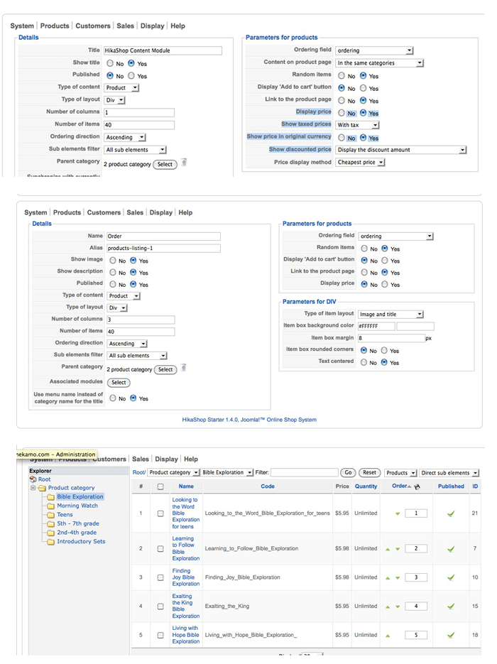

I'm still having trouble with my product order.
I've updated the order in the ordering colum on the products listing and I've updated the setting on the menu/module display to "ordering".
I must be missing something...
Thanks for you help,
Amanda
  • Posts: 86102
  • Thank you received: 14203
15 years 7 months ago #6588
In your menu options, you select the parent category as "Product category" and then selected "all sub elements" in the option "Sub elements filter". That means that hikashop will display all your products regardless of their category. However, the ordering of products is done on a per category basis. So it's normal that you get strange results. Also, you set the option "random items" to on in your menu options. You should turn it off.
Why did you create categories if you're finally displaying all your products as one category ? In that case, you should have only category with all your products in it and handle the ordering of all the products in that category.
  • Posts: 36
15 years 7 months ago #6945
Thank you, Thank you, Thank you!
You're right I shouldn't have added categories if I wasn't going to use them. I've taken them out, ordered within the products listing and the problem was fixed.
