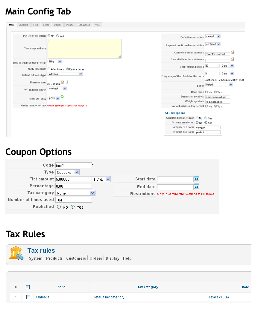

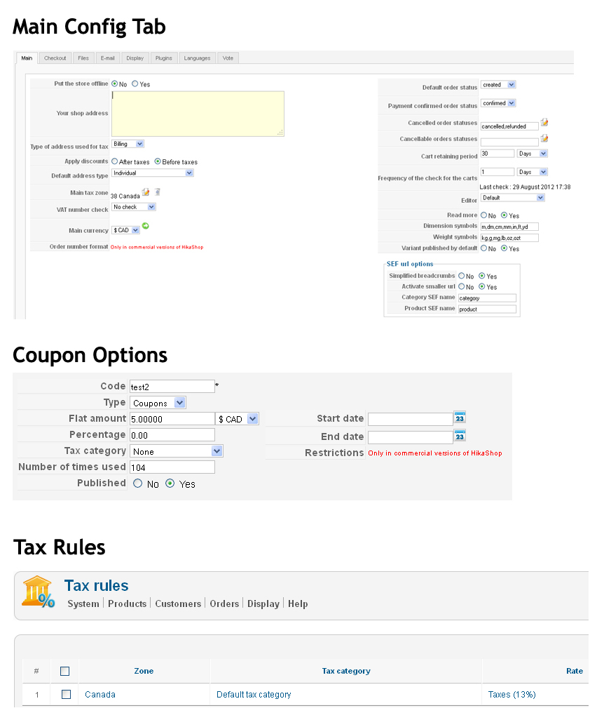

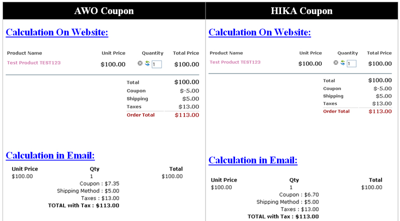

Attached is a pic of the result of my test using the coupon with both awoCoupon and Hikashop.
The coupon is configured to take 100% off the shipping cost which is $5.00. And I checked "apply changes before taxes" and there is no taxes on the coupon code.
No matter what I try the coupon amount is not showing correctly in the Email. The amount shows correctly on the website and on Paypal but not in the email. It keeps adding more to the discount. The coupon discount that I'm testing is $5 when the email comes in it's showing $6.70.
I do not have taxes on the coupon so I don't understand the extra amount that is being added and I don't know what to do next. I've been trying to get this to work for about 4 days now :(

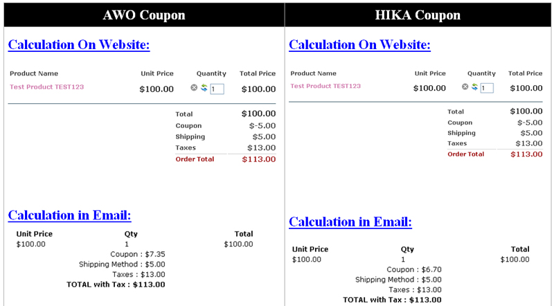

As requested over here http://www.hikashop.com/en/forum/2-general-talk-about-hikashop/61919-coupon-amount-incorrect-in-email.html#62668, have attached the screen shots.

I'm getting the same result. This is what it is showing on the website and on Paypal which is correct.
Total $100.00
Coupon $-5.00
Shipping $5.00
Taxes $13.00
Order Total $113.00
This is what it shows in the email.
Total $100.00
Coupon : $8.00
Shipping Method : $5.00
Taxes : $13.00
TOTAL with Tax : $113.00

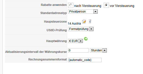

further info: tax rate set is 20 percent and option apply coupon before tax is already chosen in the global config

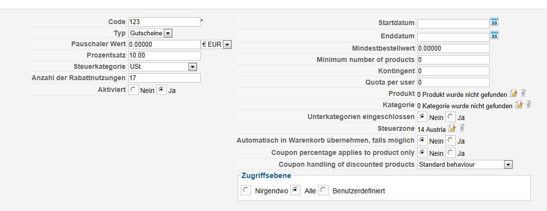

Hi Christoph,
Could you please give me screenshot of your coupon configuration?
Also, an example of case where the price emailed is wrong would be welcome :)

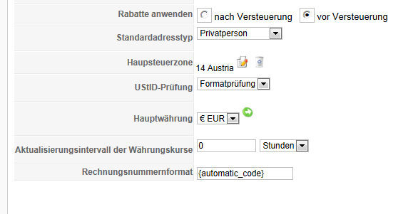

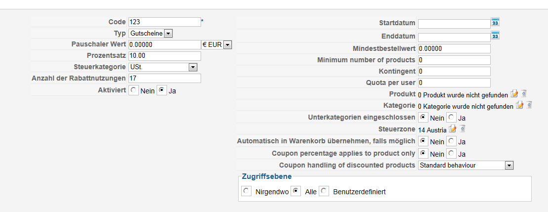

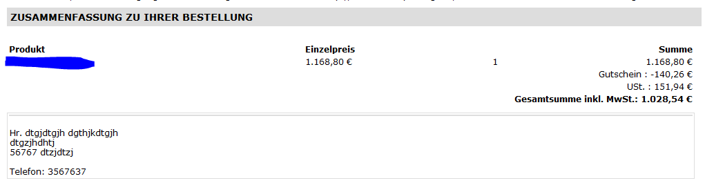

13 years 10 months ago #68227

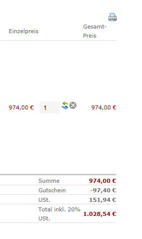

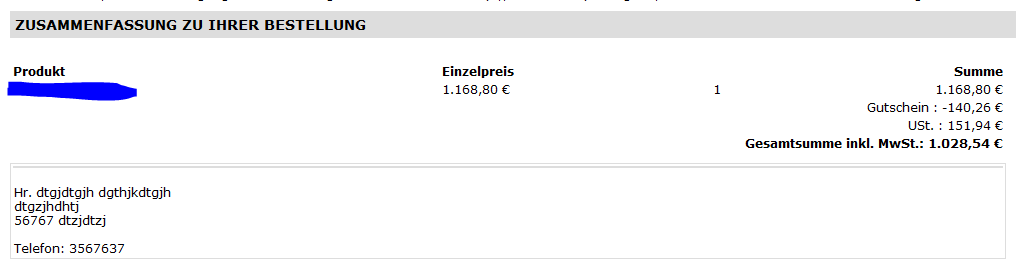

Hi Eliot, tested everything a couple of times but no success. I would like to change to a percent coupon and the tax rule in Austria says that this has to be applied before tax (it does not make any difference in the end but it has to be displayed in that way). I have enclosed 4 pics. On the site the net price and the discount (which is 10%) is displayed correctly but the tax sum and the final total is not. The email order overview shows something comepletly different: price is a gross price (before tax) and discount/Tax/total mixed up.
For further info: I have modified the the checkout/cart.php as instructed by Nicolas in another thread to show only net prices at checkout: $this->params->set('price_with_tax', 0); in the checkout/cart.php.
Thanks for your quick help!
Christoph

I did what you said (update to 1.6.0. and get rid of cutom.) on my backed up xampp environment but as expected it turned out to become a big mess as my site is highly customized with changes in many different files and not all changes done by recommended way via "views" (work on 1.5.8.). also submitting an order has no effect to my cart module...
I am unfortunately short of time (marketing campaign starting in less than 2 weeks) and I need to get the discount system running showing the correct figures on site and the email. I have for now achieved a basic workaround for the email notification (order creation) with the only problem remaining that I have to use a fixed figure and not a variable here (so I can´t use different levels of discounts):
if(bccomp($data->order_discount_price,0,5)){
echo '<tr><td colspan="4" style="text-align:right">'.JText::_('HIKASHOP_COUPON').' : ';
if($config->get('price_with_tax')){
echo $currencyHelper->format(($data->order_discount_price/1.2)*-1,$data->order_currency_id);
}else{
echo $currencyHelper->format(($data->order_discount_price-@$data->order_discount_tax)*-1,$data->order_currency_id);
Can you help and let me know if there is a solution for that. The code in the last line does reproduces VAT-discount*(1+tax rate) - in this case 20%). Also, how can I implement a subtotal without VAT as shown on the screenshot of my previous email. If there a a couple of products added I need this.
