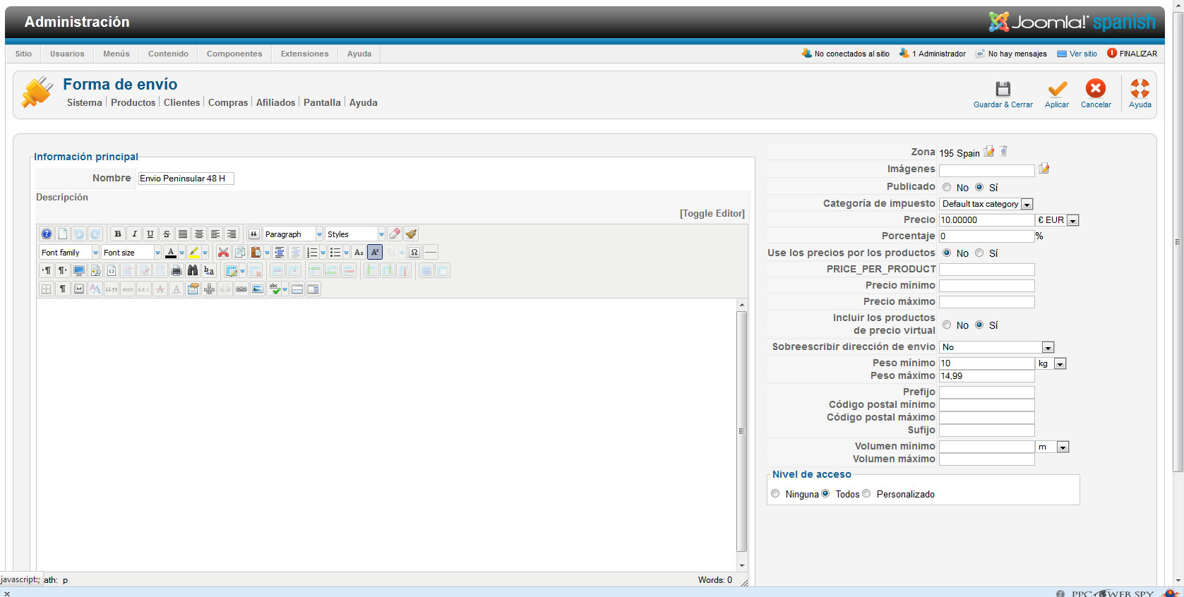

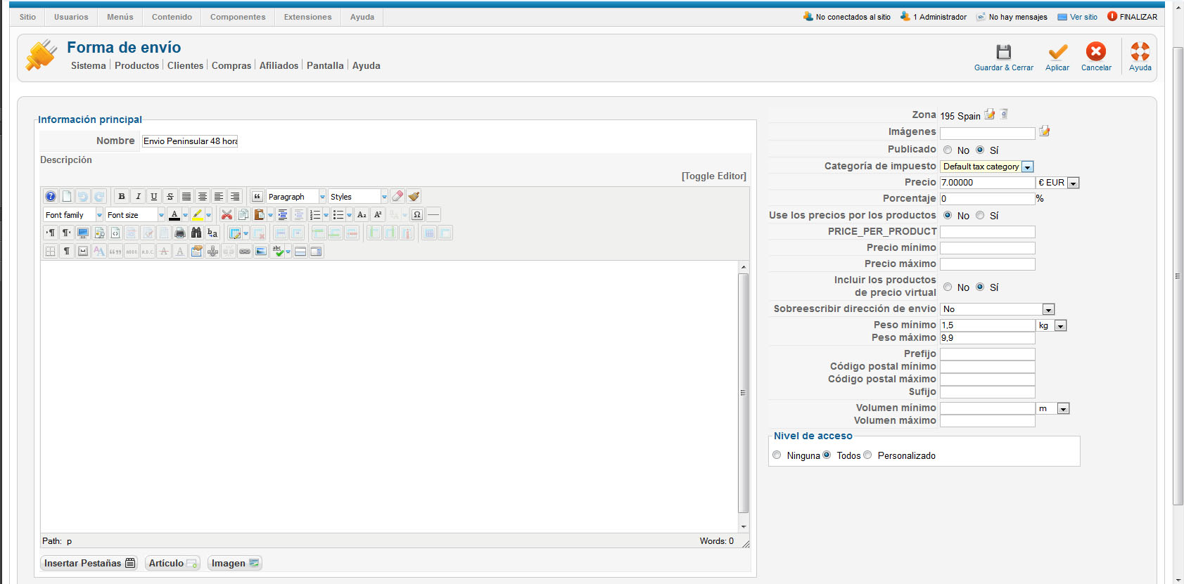

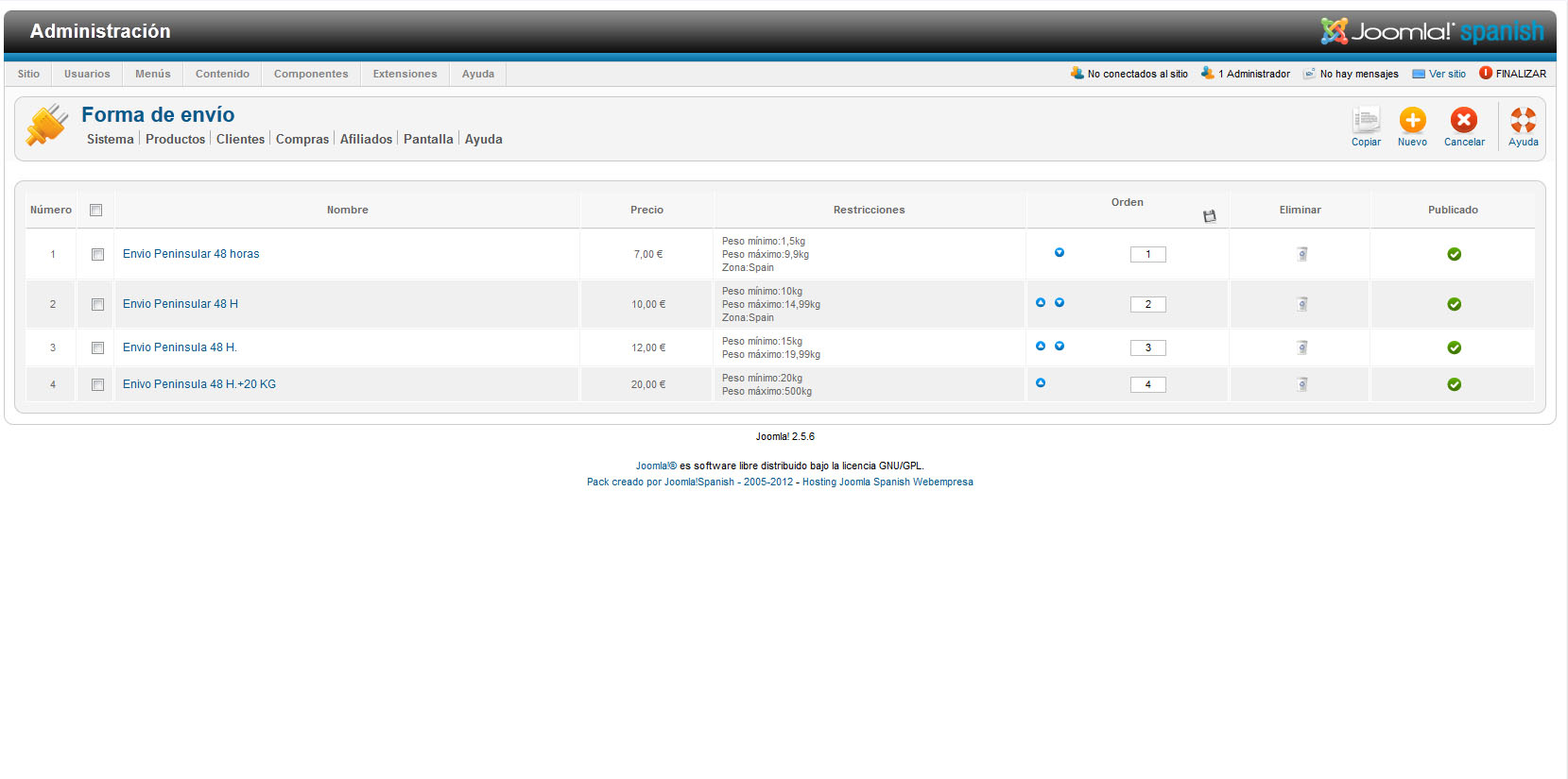

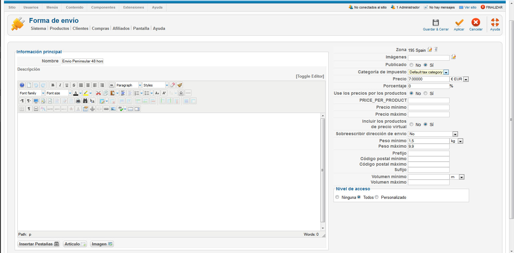

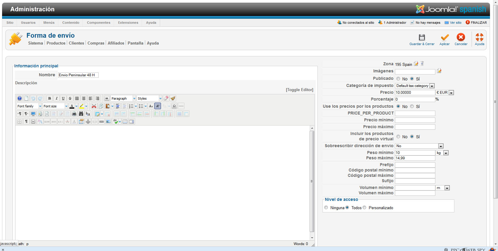

I configurated a manual shipping, inside it i created 4 categories, 1 minimun weight 1,5 max weight 9,99 and so on, last one is 20 kg to infinite. I also put the weight in each product to be 1,5 kg. The problem is that only takes the first one in shipping method.

Can you please show me screenshots of your shipping methods configuration ?

13 years 11 months ago #62872
here you are

13 years 11 months ago #63023
Can you check that the main weight unit (the first one of the list) in your configuration is kg and that you use kg for your products weights.
Can you also try to unpublish the first shipping method and tell us the error you have on the checkout at that point ?

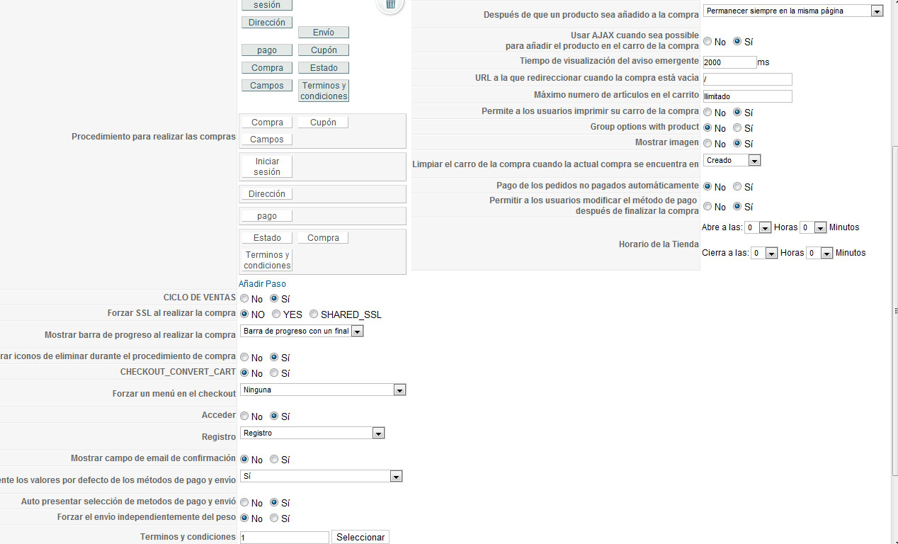

13 years 11 months ago #63877
That's because you don't have the "shipping" view in the "checkout workflow" option of the configuration.
Please add it there and it will work.
If you don't want the shipping selection to be displayed, you can just hide it with CSS, but it has to be there if you want the shipping price to be in the cart.
