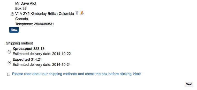

I followed the instructions from last year and it worked great. I've just upgraded to the latest version and would now like to have the "Next" and "Back" buttons formatted by the template, like the "New" button for addresses (see image, which shows template formatted "New" button and plain "Next" button).
I can change the formatting of "Next" using Firebug by changing type="submit" to type="button", but I can't figure out how do do that permanently within the HikaShop php or css codes.
Thanks.
Dave

You have to add new css properties in the hikashop frontend css file or directly in your template file on the following ids:
#hikashop_checkout_back_button, #hikashop_checkout_next_button{
  /* Your properties */
You can get the template properties thanks to firebug and use it for the given ids.
hikashop.com/support/support/documentati...ize-the-display.html

Thanks for your quick reply. I couldn't get your suggestion to work, but you gave me the idea to copy the template CSS for buttons into the front-end CSS custom file of Hikashop like this:
  background:#265c91 url(../images/submitbutton_02.png) repeat-x;
  border: 1px solid transparent;
  padding: 4px 6px;
  border-radius: 6px;
  color: #fff;
  float:right;
From what I see in the CSS of the template the buttons should have been formatted like the others, but I have no explanation why they're not. Thanks again!
Dave
Last edit: 11 years 10 months ago by av.opticom.
