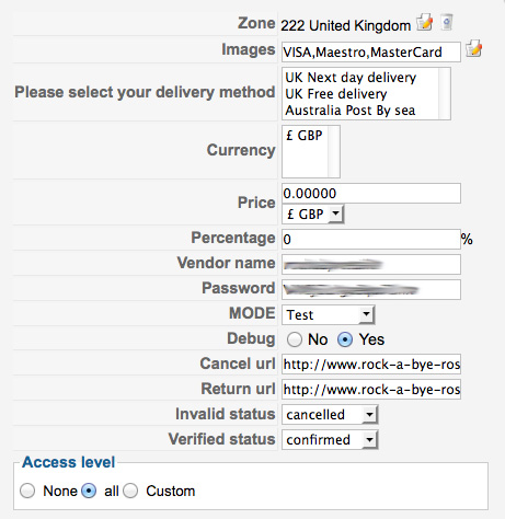

We are going to use sagepay payment gateway on our site. However i have published and configured this payment method with our vendor name and password. I have also set it to test mode and set debug to yes.
When i go through the checkout process and get to the final step the site will not re-direct me to sagepay its simply going to a blank page, with no errors from the debug.
How can i fix this?
Thanks in Advanced
Sean R.
Edit:
I thought a screenshot of the settings could help.
Last edit: 13 years 10 months ago by reders.

You don't have a blank page at the end of the checkout but the error : 500(Internal Server Error)
That error means that there is probably a problem with the saving of the order in the database.
In order to help you, we will need to know the error message which is logged in the PHP error log file of your website. That error message will give much more information on what is going on.
If you don't know where that log file is, please ask your hosting company.
