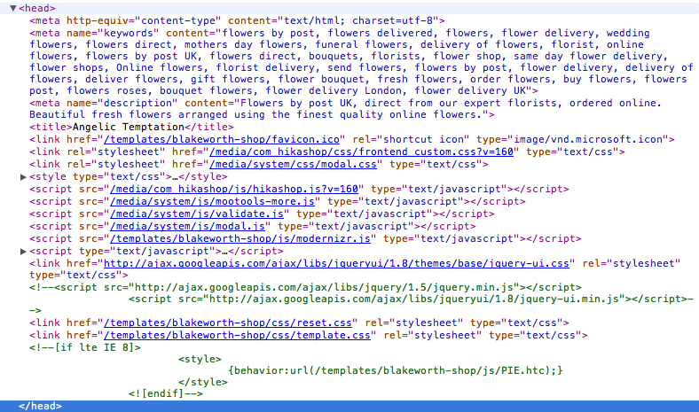

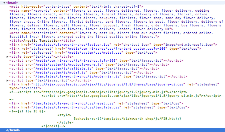

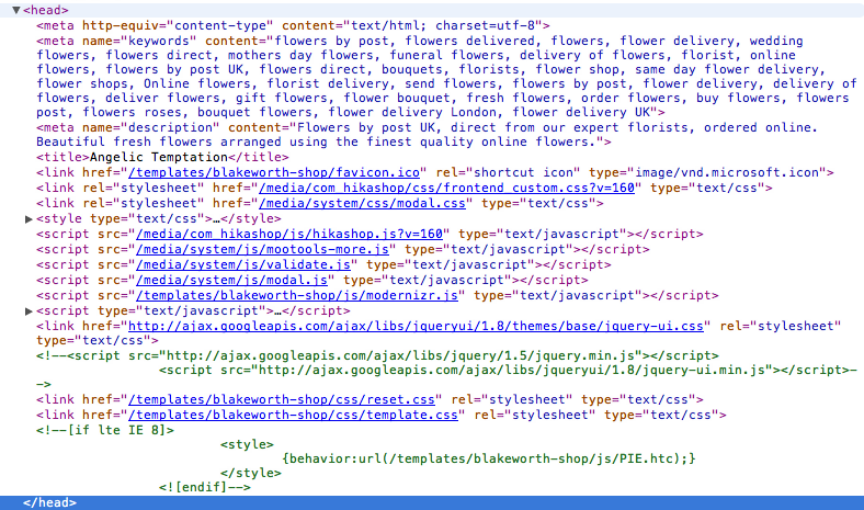

Hi, Thank you for your response.
I have been through other plugins that may be loading conflicting scripts. I have also disabled a couple of scripts that were part of the template.
It seems I still have a problem
I've attached a screen grab of the effective code in the head of this page. Maybe you can see the problem.
