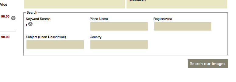

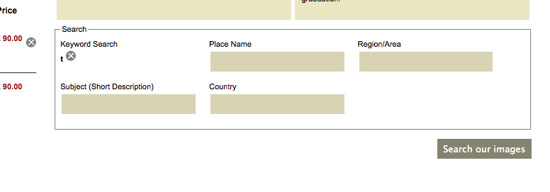

I'm having a bit of an issue with a delete-able field in my library. Basically, when you enter some text into the field, the first letter remains before the cross (see attached). Also, it is possible to change the cross graphic for something else?

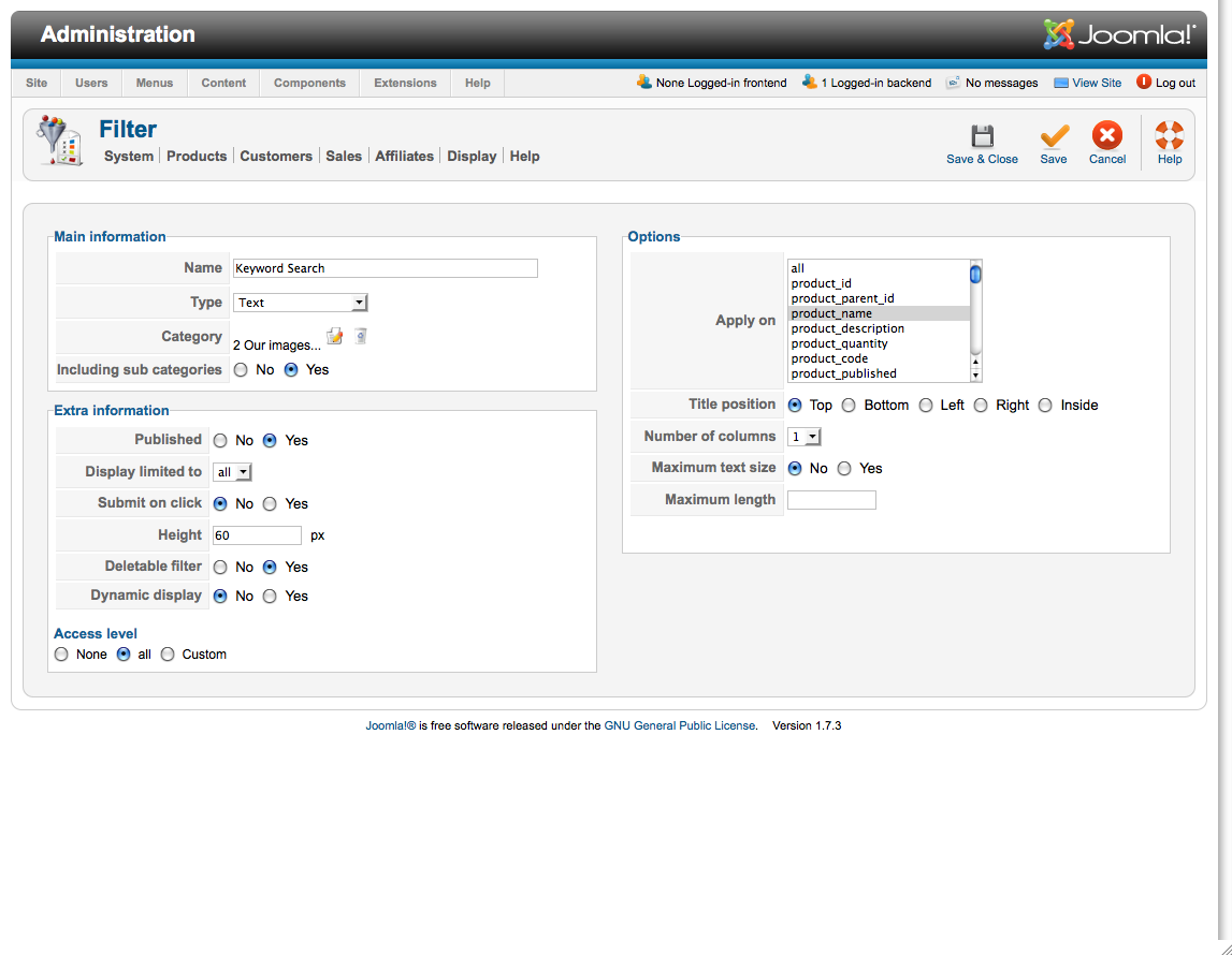

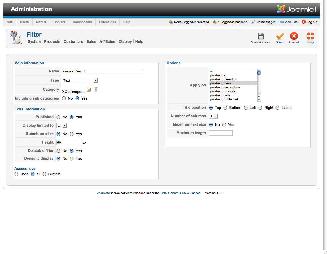

What kind of filter is it? I can't reproduce the bug so could you give me screenshot of your filter configuration and explain me how you end in this?
  • Posts: 88
13 years 10 months ago #64027
Hi Eliot,
Here's the config:
