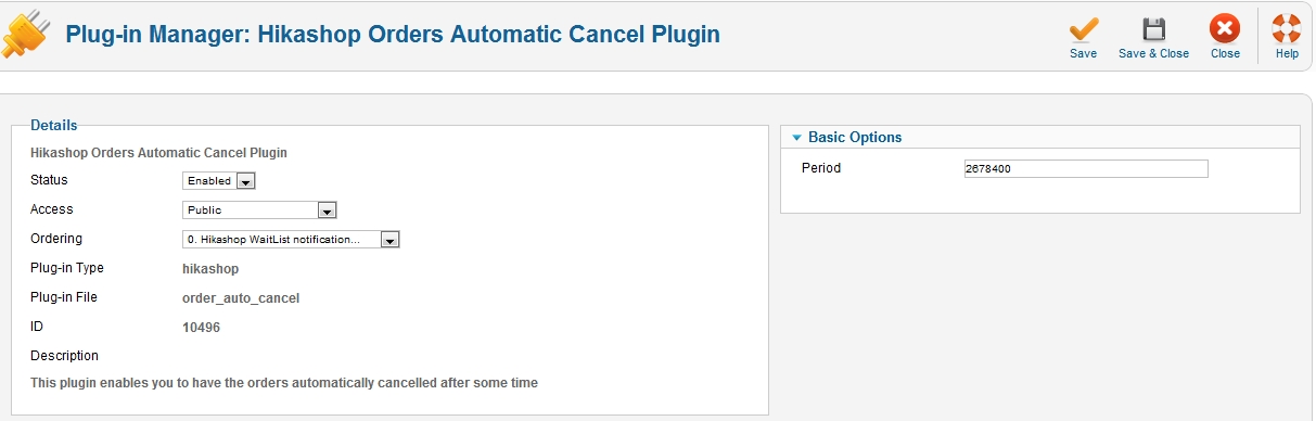

Can you do a screenshot of the plugin's options ?
  • Posts: 126
13 years 10 months ago #64272
This options?
  • Posts: 85949
  • Thank you received: 14139
13 years 10 months ago #64397
The value 2678400 equals to 310 days not 31. You should remove a 0.
