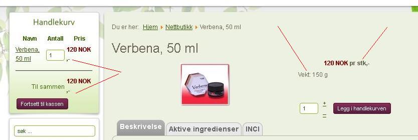

A couple of beginner questions:
1) what should be done to remove (red indications on attached picture):
a) semicolons away from the cart
b) weight dimension away from product page
c) price indication per piece
2) code for Norwegian currency is NOK and the symbol is "kr". So as I understand there should be used symbol "kr", not the code NOK as in my case. If am right, then how to change it?
Joomla 2.5 + Hika Essential
Thank you in advance!

Hi there,
About your first question:
a/I think this is linked to the second problem, wait few lines for an answer ;)
b/Try to disable the "Display the cost per unit weight" option System>Configuration>Display
c/In the same panel, select "unit price only" for the "Price display method" option
For the second thing, you have to look at your currency configuration. Go to System>Currency and type your currency name 'NOK'.
Then in the configuration page, look at the format option. Like the helper said:
Format is the way you want to display the symbol (basically you will have %i which will display the currency code as symbol, %n which will display the currency's symbol and %ni which will display both). For more information, you can look at www.php.net/manual/en/function.money-format.php
So just make it looks like you wanted :)

Question Nr 2 - solved. Thank your for that, Eliot!
Question Nr. 1 - these settings are exactly as you said. But unfortunately no result.
By the way, it's not the price per weight unit I will get to dissapear, this is a price per piece. Well in norwegian it is "pris per stk" as it is on attached image above.

Ok, then you have to add some css. Edit the front-end css through hikashop interface in System>Configuration>Display and add these lines:
.hikashop_product_weight_main{
display:none;
and for the pr stk you ahve to edit the traduction file. Go to System>Configuration>Language and edit your language file.
Look for the "PER_UNIT=" line and just put nothing instead of the current traduction :)

It works! Yeas! :woohoo:
Except the weight - I'm just ordinary user trying to launch my first webside and I'm not so experienced to get at once what you guys are talking about, :blush: so could you please indicate which exactly file should be editet in order to get it away?...

Don't worry, we all started using it without understanding anything :).
About the product weight, you have to go System>Configuration>Display and spot the CSS field.
There, click on the little edit button next to the Front-end Css File.
Add the given code at the end of the popup and save it. Then save you configuration and the weight should not display anymore ;).

Wow! I got it! :)
