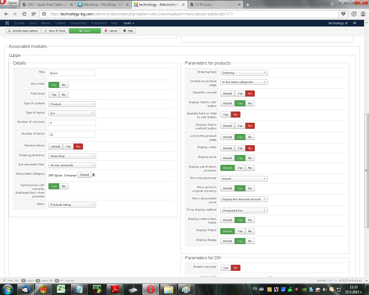

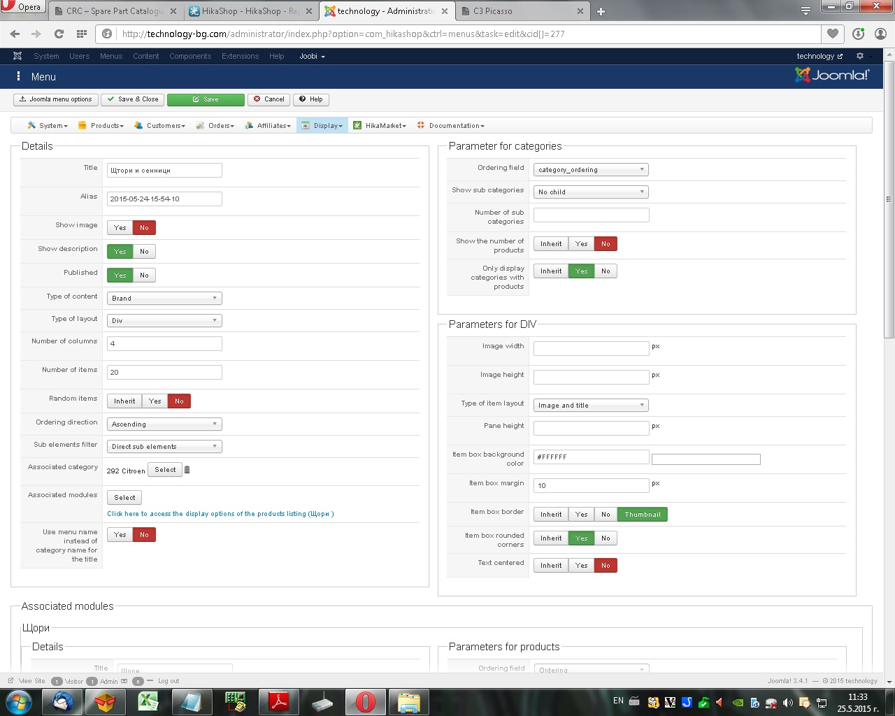

What i have done is this :
I have a menu to Brand listing of the car models Citroen
And in that listing i have configured the Hika Content module to show only items from Category "Щори".
But it shows items from another category of parts not only from the one i have selected.
I tried with all "Content on product page" option to "in the same category" and "in the module associated category" to no result.
Attached are screen shots of the current configuration.
10 years 6 months ago #202795
You should probably set the "sub element filter" option to "Direct sub elements" and test it again.
Last edit: 10 years 6 months ago by Mohamed Thelji.

  • Posts: 84727
  • Thank you received: 13792
10 years 5 months ago #203198
When you create a brands listing menu item, it will display a listing of the brands. So make sure that you select a brand or the main brand of the shop in the "associated category" setting and not a category.
