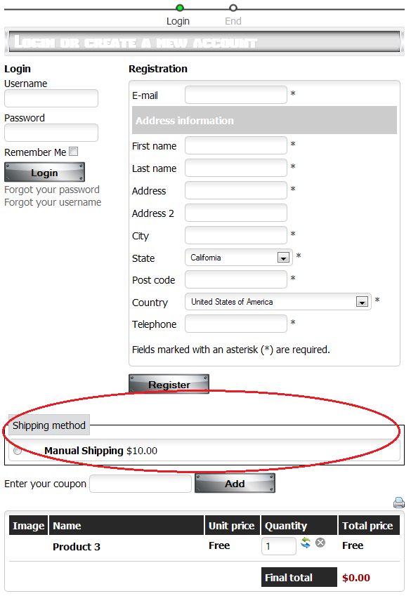

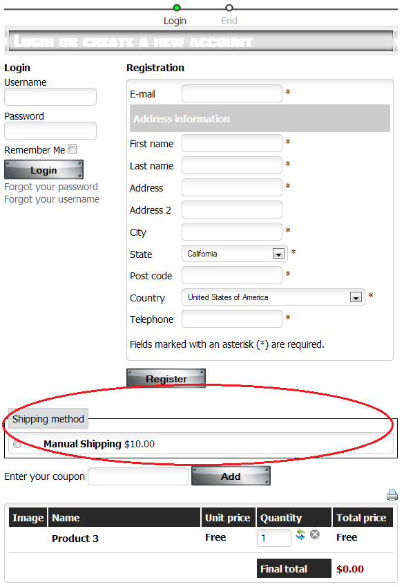

Upon checking out on the layout of "Login", Manual Shipping Method is listed but although all other shipping methods (USPS, UPS and FedDex) are enabled/published. Once logged in, USPS and Manual Shipping appear but not the other ones.
Question:
How to remove Manual Shipping Method on Login layout or make the other shipping methods appear there

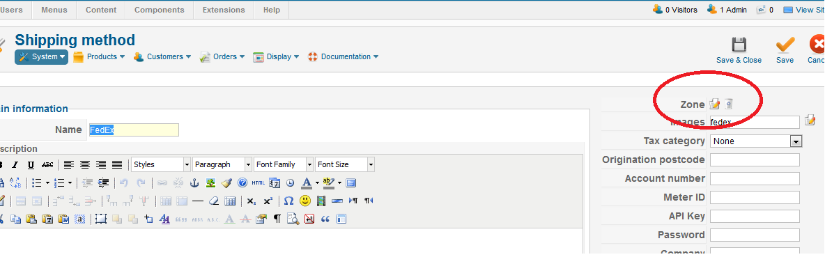

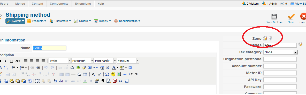

13 years 11 months ago #66114
In the shipping methods, such as "FedEx", check to see if anything is set next to zones, press the delete icon to remove the restriction, save and see if it shows up.
  • Posts: 33
13 years 11 months ago #66115
Thanks, nothing is set in the zones. Also the product has a weight to it of 2 LBs, so weight isn't an issue either.

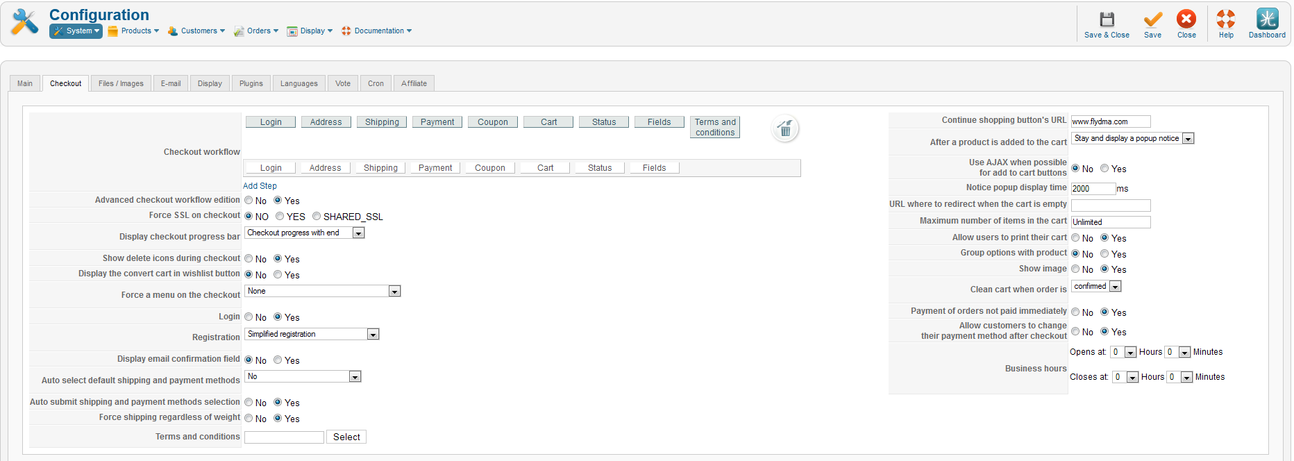

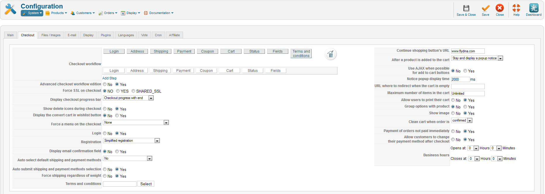

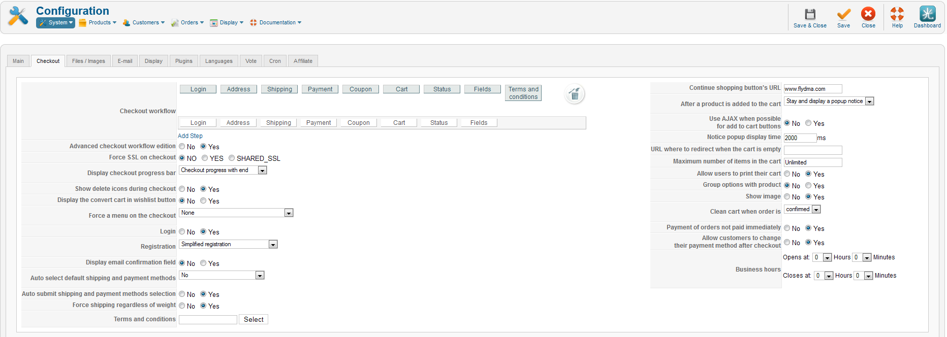

  • Posts: 33
13 years 11 months ago #66118
The Hikashop I'm working on is the Essential version. Yeah, I guess it's different from the Business in this window (see pic attached) as I don't see "shipping" as an option to trash.
  • Posts: 83
  • Thank you received: 10
13 years 11 months ago #66124
its the third one over, in the grey area where it says Login, Address, Shipping, Payment
try dragging the one that says Shipping into the trash can

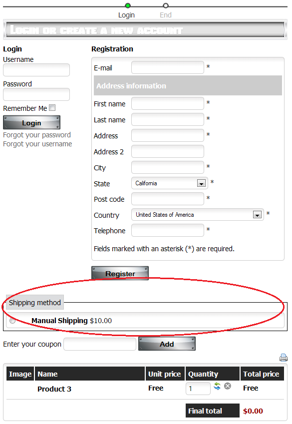

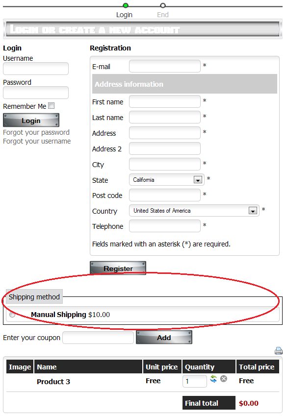

  • Posts: 33
13 years 11 months ago #66126
That "Shipping" you are referring to displays after a user logs in. But my question is referring to the page before the user logged in (pls see attached).

13 years 11 months ago #66127
In your checkout workflow you have
Login, Address, Shipping, Payment, Coupon, Cart, Status, and Fields all on one page like the gray line shows and also shows in the second image you sent.
If you put the Shipping into the trash then it should remove it. (you can put it back again afterwards).
You can have multiple checkout pages, for example, on the first image that you posted there is blue text that says "Add Step". If you press "Add Step" and then drag the Shipping to the next gray line, that might solve the FedEx thing, because I guess FedEx needs to know the address before it can calculate. So try this
Add Step
drag Shipping to that new step
Save
and see if that works.

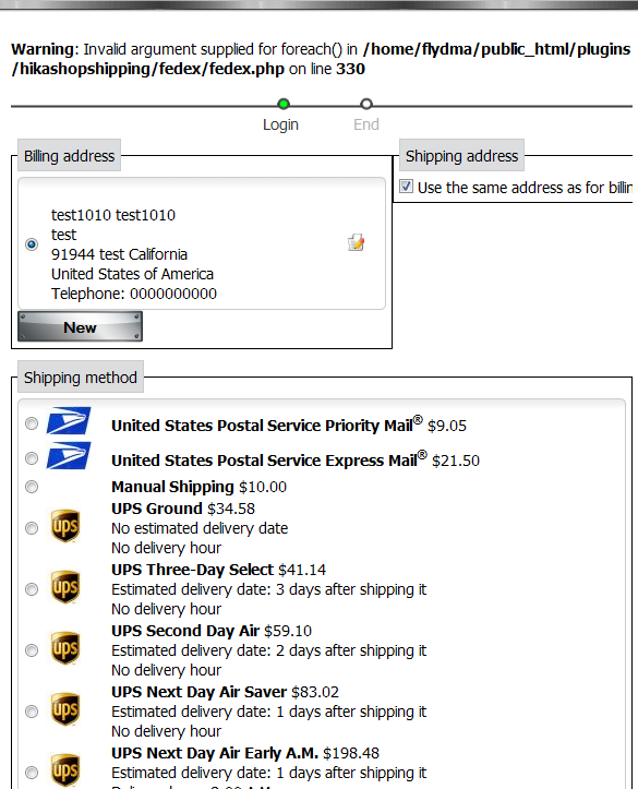

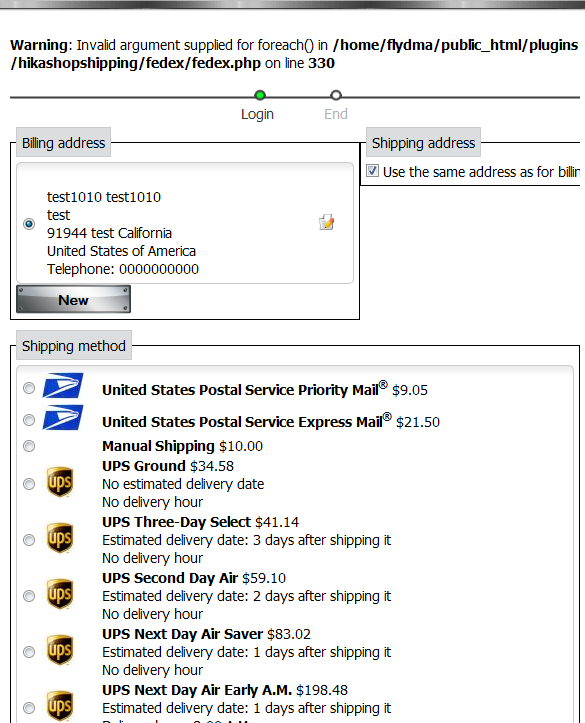

  • Posts: 33

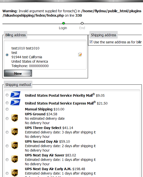

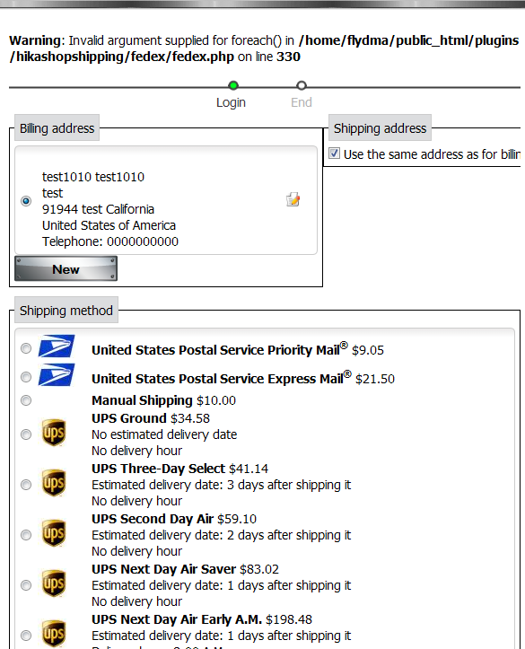

13 years 11 months ago #66283
Hi, I tried the add step, but the result wasn't what I was looking for. Finally now I got the UPS to show, but I noticed this error message. Could you tell me what this means? Could this be why the Fedex shipping method isn't showing?
  • Posts: 33
13 years 11 months ago #66285
Sorry, nevermind. I see that FedEx hasn't been configured with passwords and such. That must've been why FedEx isn't showing up and has an error message.
  • Posts: 33
13 years 11 months ago #66288
So, I dragged "shipping" into the trashcan and the whole area (highlighted in red in the picture attached) did disappear along with the shipping methods that used to be listed after the user logs in on the "checkout" page.
1) Is there a way to get rid of that area circled in red without getting rid of the shipping methods on the checkout page?
2) Is there a way to make USPS, UPS and FedEx appear on the login page (same page as the picture attached)? I did read in other forum discussions that USPS, UPS and FedEx require address to calculate shipping. Is that why they don't appear on the login page (same page as the picture attached)?

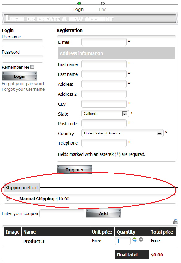

13 years 11 months ago #66304
can attach the pic
  • Posts: 33
13 years 11 months ago #66306
Oh sorry. Here it is!

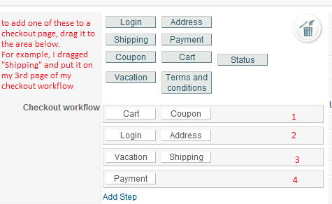

  • Posts: 83

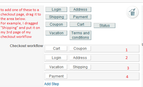

13 years 11 months ago #66487
on the first page of checkout say you want Login, Cart, Coupon and Address
and on the second page of checkout you want shipping and payment.
In System, Configuration, Checkout Workflow, you will see the words "Add Step" near the area you were previously working at. Press that, it will create a new gray line. Drag the Shipping into that, and also the Payment. Save it.
So you should have Login, Address, Coupon, Cart on the first page, and Shipping and Payment on the second page of checkout.
  • Posts: 83
13 years 11 months ago #66488
I've attached an image of my checkout workflow to explain more. I've put my comments in red.
I have four stages of my checkout process, which I've numbered in red. It appears you would like two, so use the "Add Step" button to add a new stage to your checkout workflow and drag Shipping and Payment to that stage

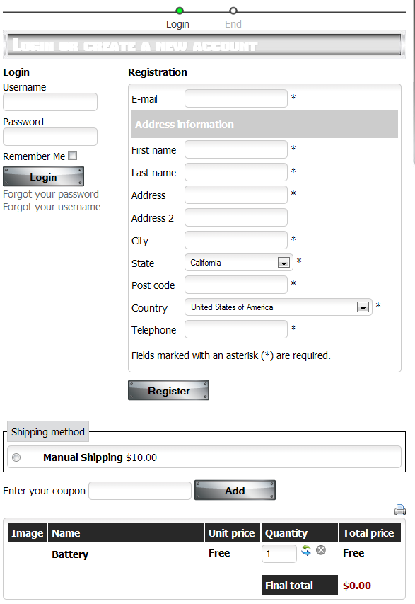

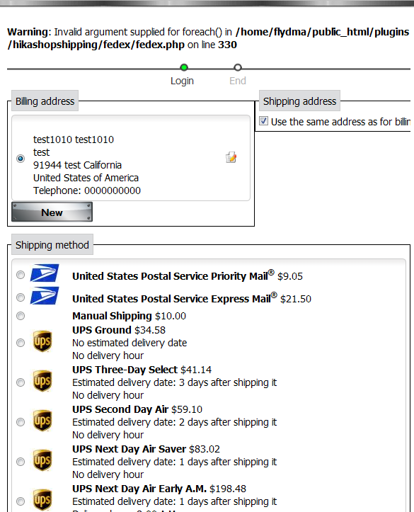

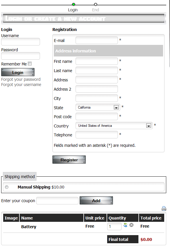

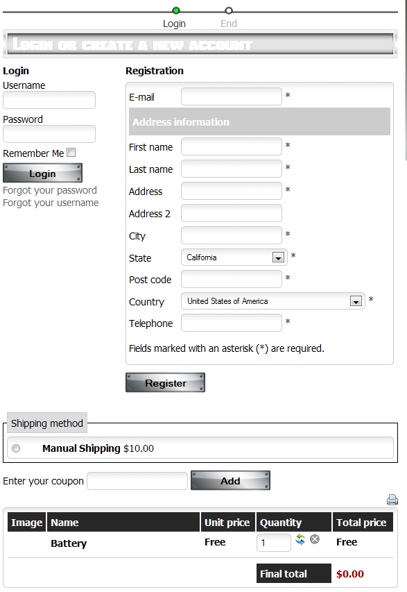

  • Posts: 33
13 years 11 months ago #66489
Hi Jrod,
I don't think I'm getting across what I was asking. Let me try again. Please see both pictures attached. I'm exploring the option of having the red circled area be removed (no shipping methods) in the first picture and at he same time having the page represented by the second picture look like that (with shipping methods).
  • Posts: 83
13 years 11 months ago #66490
You want Login, Registration, and Cart on the first page of your checkout (everything that is in your first picture, minus the read area). Correct?
Then after the user logs in it shows address, shipping methods (usps, fedex, etc.). like your second image. Correct?
  • Posts: 33
13 years 11 months ago #66491
Yes.
