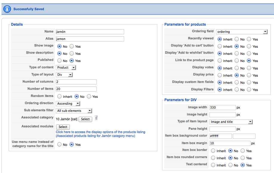

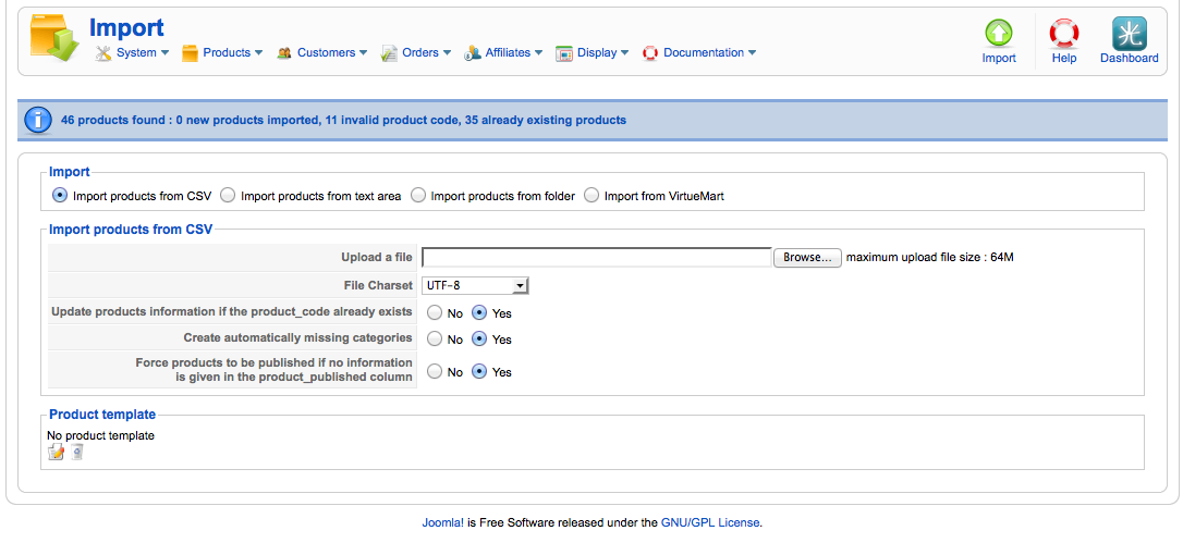

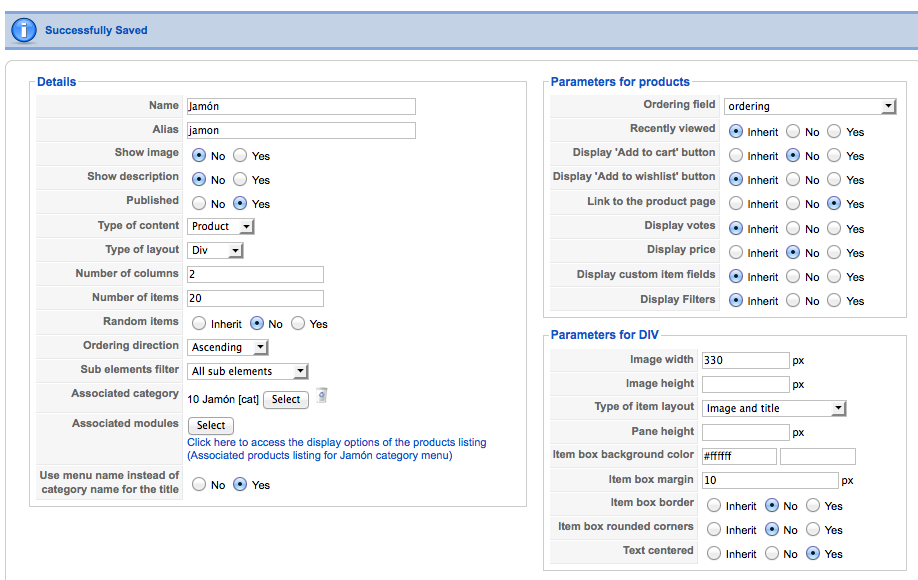

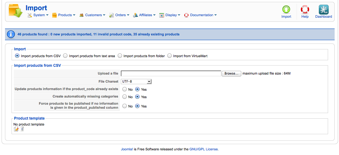

I have now been working on my exported CSV file, opening it as an OpenOffice spreadsheet. I have made some modifications, eliminating unused variants, changing product descriptions, etc. After working on it in OpenOffice .ods format, I re-saved it in .csv format with UTF-8 encoding, and when I went to import it I got the following error message (see attachement). Zero products imported. I would think that importing the same file I exported would not lead to errors, but I must be doing something wrong. It cites "invalid product codes" but I did not touch the product codes in the file I worked on. Ideas? Thanks!
Edit 19:05 - Now I see it has imported some of the information properly. The products which were alone in their categories all were imported correctly, it seems (these are HS Product/Show pages). However, most of my categories have two subcategories, and one of these has many variants. Now if you select these categories from the main site menu, you get a blank page (these are HS Product/Listing pages).
Another factor, I edited category and subcategory names, perhaps with the import errors the products are now not finding their categories?
However, if, rather than selecting a category from the site menu, you select from the shop module at left, you get a correct page for the same item. Choose a category from the menu -> blank page, choose it from the shop module -> correct page.
I have looked at the HS display options for the "Shop left" module and compared it to those for one of the categories that comes out blank when selecting from the menu. The only difference was All sub elements vs. Direct sub elements. I change the menu item to conform to the options of the Shop left module (All sub elements), but I still get a blank page. Second screen shot of options attached, file name ending in 19.27.50. Thanks

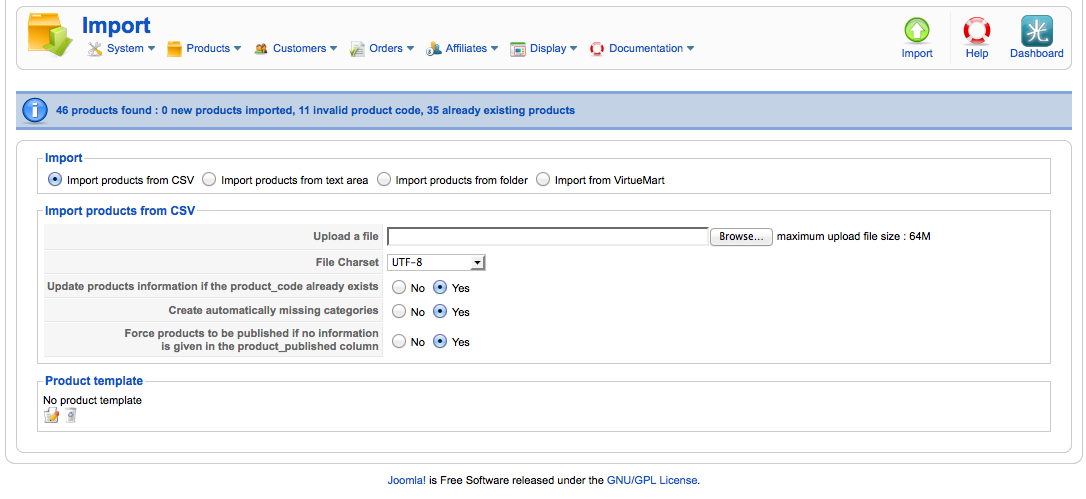

The message didn't say "Zero products imported". It said "Zero new products imported". And that's normal since the products where already in the database.
So it's not an error. The error messages appears in red, you can't miss them :)
For the blank page, I would recommend set to "maximum" the "error reporting" option of the joomla configuration.
Then, on the bank page, you should see the error message which would help you/us understand what's going on.

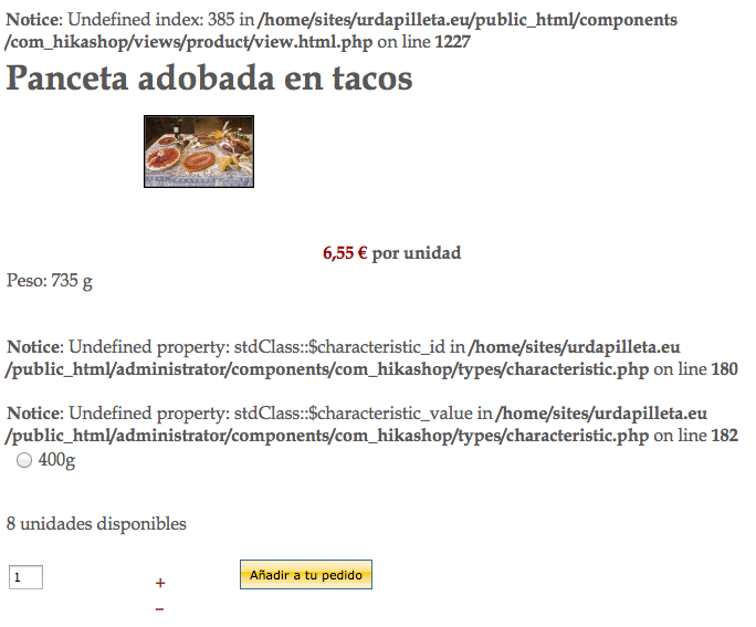

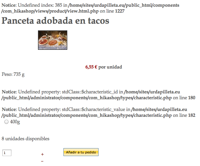

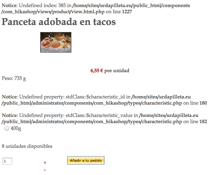

Also, I have 9 products that show error codes on their product page. I believe they all cite the same errors, sample screenshot attached.
Text of one of the errors:
Notice: Undefined index: 259 in /home/sites/urdapilleta.eu/public_html/components/com_hikashop/views/product/view.html.php on line 1227
[Product name]
[Product photo]
[Product price] [Weight]
Notice: Undefined property: stdClass::$characteristic_id in /home/sites/urdapilleta.eu/public_html/administrator/components/com_hikashop/types/characteristic.php on line 180
Notice: Undefined property: stdClass::$characteristic_value in /home/sites/urdapilleta.eu/public_html/administrator/components/com_hikashop/types/characteristic.php on line 182
Note I have 6 product variants that are alone in their category and 6 that are alone in their subcategory. All 9 of the products with the above error codes are products that are alone in their category or subcategory. OTOH, there are 3, two that are alone in a category and one in a subcategory, that display correctly with no error codes. I think I set them all up in the same way, so I don't understand the difference, but perhaps I've done something wrong. I've set up all products as variants because the product pages look better that way. Some categories have no subcategories and just one single variant; selecting the variant is the only way to select the product.
The subcategories with multiple variants are all displaying with out error messages.
Thanks for your help.

These errors means that the variants/characteristics data of the product is not correct.
It must come from the CSV that you used which has something missing leading to the import not able to import properly the variants/characteristic data of your products.
Because of that, the system is searching for data which doesn't exist and produce these messages.
One solution would be to remove the characteristics of your products and add them again via the interface so that HikaShop creates all the data properly. Another would be to fix the CSV and run again an import.

I've looked over the CSV really carefully to see if I could find any common theme in the variants that worked well vs. those that worked poorly, and the same for the categories they belonged to. I couldn't find any differences that would explain what happened.
I have fixed the 9 offending products via the interface. They had one thing in common -- they were all defined with a price at the product level. Perhaps this made HS reject the variant prices on import and pay no attention to the new info re existing categories/products (i.e., the price field was left blank, meaning no price). Perhaps I should have zeroed out these prices instead of leaving the field blank to make sure the existing data were overwritten?
Anyway, the error codes in these nine product pages are now gone, and the errors in the shop module and main category page are gone too, so I suppose we can close this one. If you know, I would still appreciate an answer to the question in paragraph 2 though, for next time. Thanks.

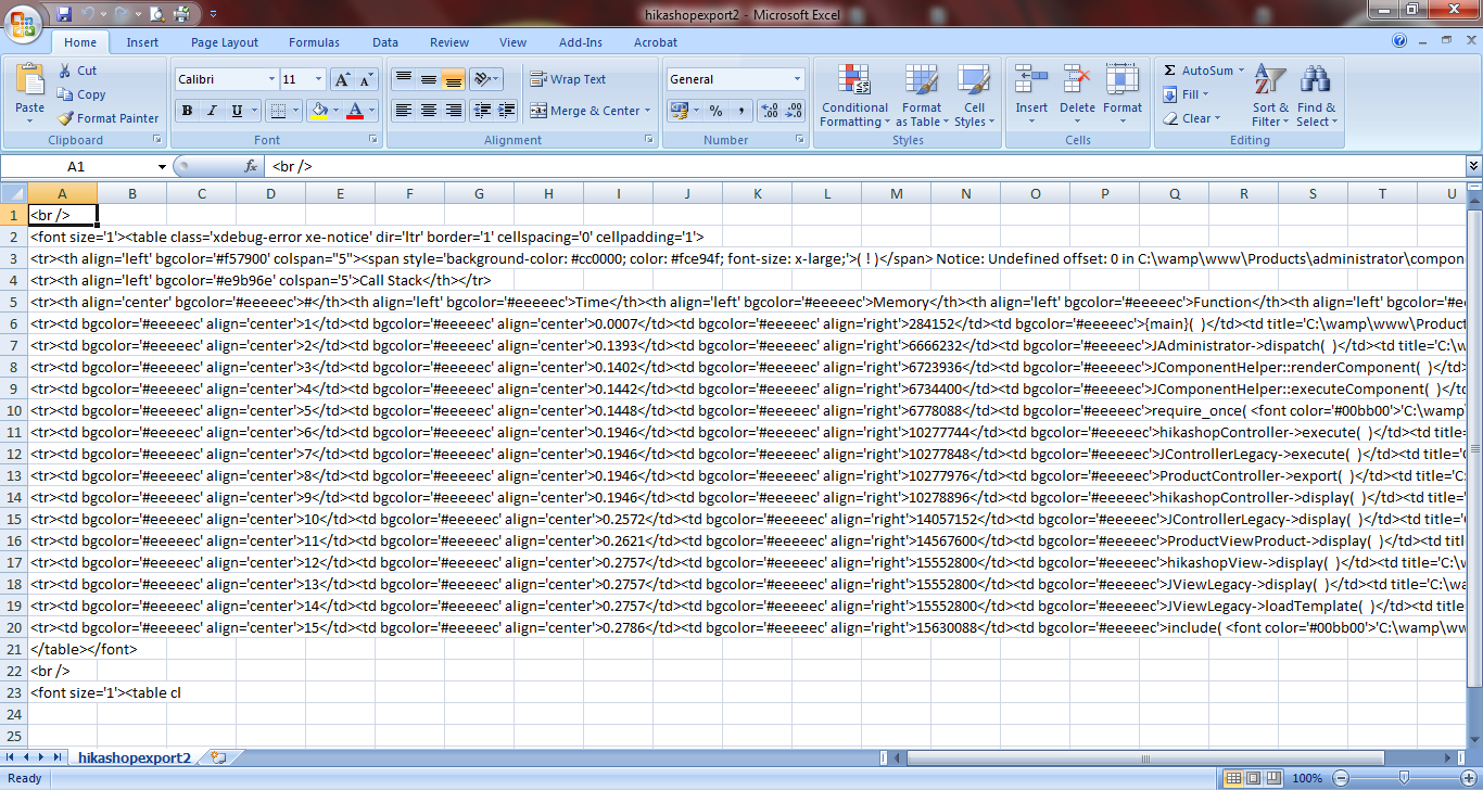

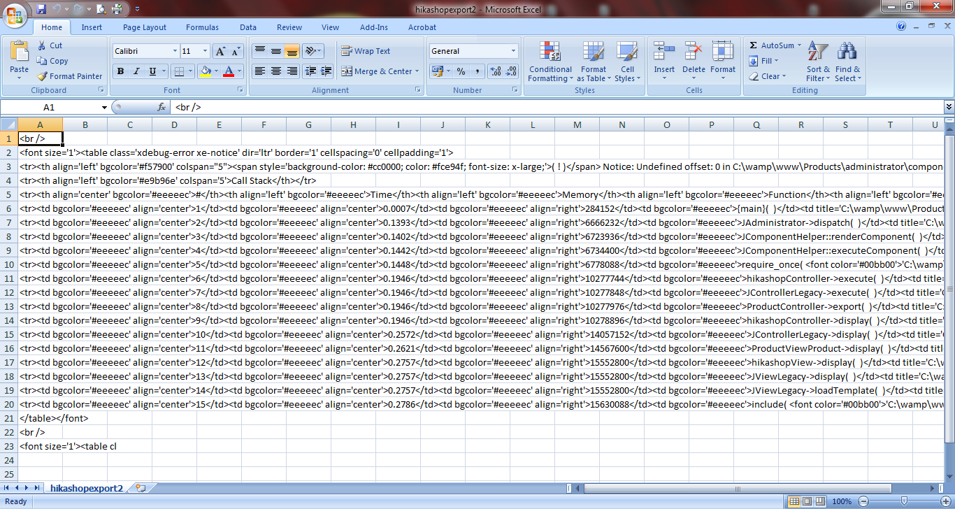

I want to import some products to my Hikashop. I tried to export my products but I'm unable to read that file. I have attached the file. Please help me out.[img]http://
  • Posts: 26384
12 years 11 months ago #123140
It looks like the product you are trying to export have a currency id "0", which is not possible.
Can you correctly open your product you are trying to export, in the backend ?
