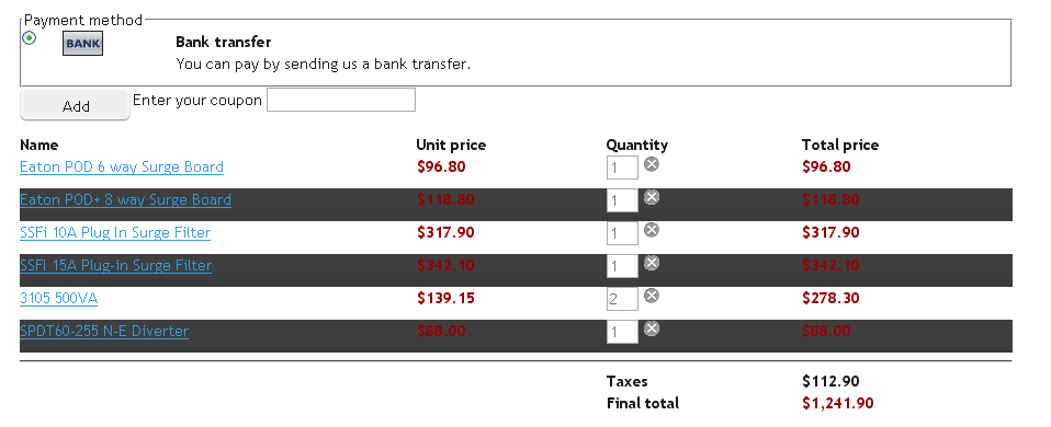

Back again,
I've got an issue with checkout, the alternate product rows are displayed on a black background. It looks like our template has a module 'row1' that is clashing with hikashop 'row1' used for every second row. What is the best way to get around this?

You should try to override the row1 css of your template by adding the CSS below to the hikashop front end CSS in the config under the tab display:
#hikashop_checkout_cart tr.row1 { background : #FFF }

15 years 7 months ago #6750
No that didn't work, would it be easier to stop the rows alternating ie declare them all as row 0 rather than 0,1,0,1?

15 years 7 months ago #6754
Did you save your configuration so that the new CSS file is used and did you clear your browser's cache ?
Maybe your modification isn't visible because of that...
Otherwise, yes, you can go in the menu Display->Views and edit the file cart of the view checkout and remove the class on the tr tag.

15 years 7 months ago #6757
I work in Firefox and test changes in a clean IE just to avoid the cache issue.
Class removed and now working OK, thanks Nicolas.
