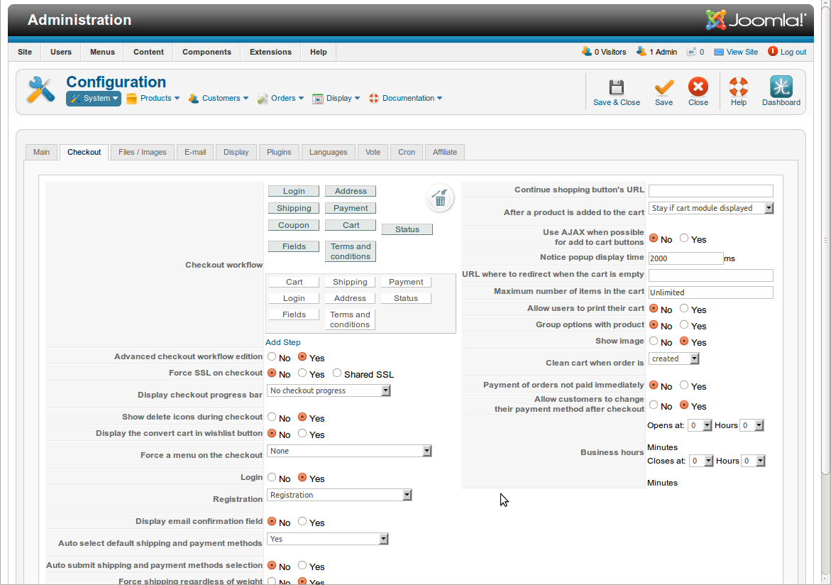

in Configuration/Checkout there's the area of the workflow. can you do a screen shot of your checkout workflow?
to see if you have one step or multi step checkout setup

Here is the screen grab. Maybe I am not understanding how the checkout workflow works, but I believe i have login after the payment option. My other payment option (pay by cheque) appears before the user is logged in.
Steve
  • Posts: 83
  • Thank you received: 10
13 years 11 months ago #66933
it seems you understand how the checkout workflow works ;)
you do have payment in a step before login.
since your other payment methods show up before the user logs in then either
a) the WorldPay payment plugin is assigned to zones. Delete those associated zones, or
b) WorldPay does not show until it knows which country the user is in, which can not happen until the user logs in.
I suspect it is b......
