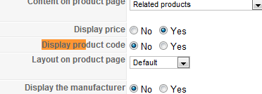

  • Posts: 97
13 years 11 months ago #66939
please have a look at the attachment.
I have already turned it off, but it still shows the code.
13 years 11 months ago #66940
Then you should look at this thread :
The product code should not be visible by default.
If you see it, it's because of your template's span processing option. Please deactivate it and it will remove the product code.
Hope this will help you.
