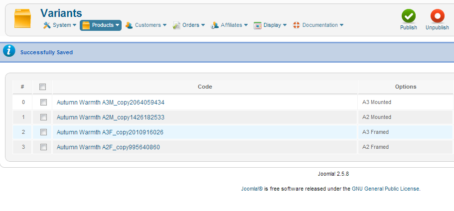

Think sgascotland may have come up against the same problem as me...
If you create a product with say 10 variants for that product/characteristic, and then copy the product using the the copy button, it creates 10 variants with the previous name for the item code. This means that we need to change each one of those variant item codes individually to reflect the actual product it belongs to. As one person tried to cancel an order as they thought they were getting the wrong product when they looked at the code on the invoice :-(
Is there a way we could put an "update all variants" button which just renames the variants to the main product name after the copy, or easier still, could we update the variants attached to the copied product on the initial save after the copy :-)as the copy would have to be saved because of the new image/product name or other detail :-) (a quick reflection just before sending this...the button would be a good option because if we changed the product name for any reason we could then change the variants to match :-) )

13 years 9 months ago #78713
The name on the variant I do leave blank. It's the actual auto generated variant code that gets copied that needs to change.

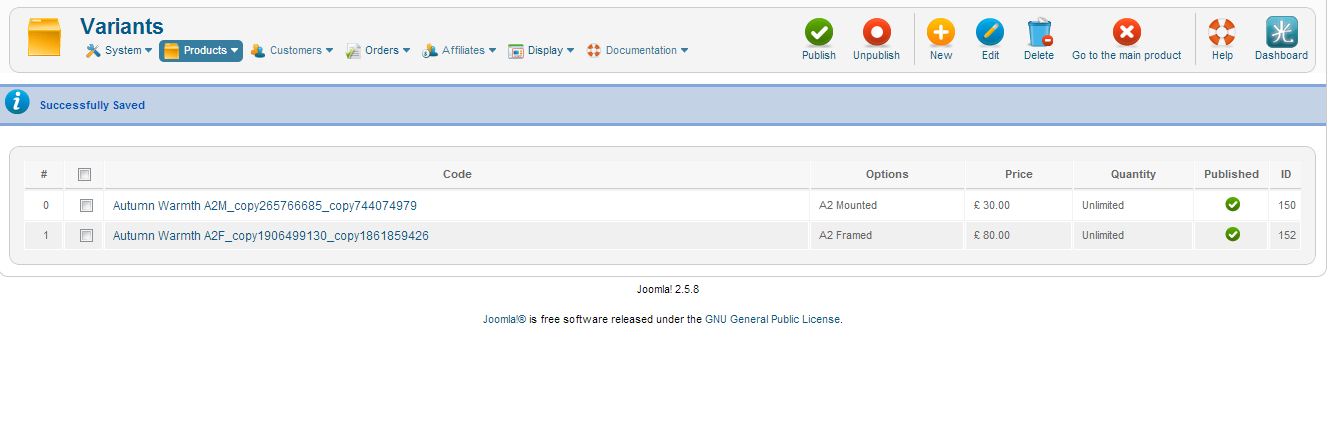

13 years 9 months ago #79226
Yes, the variant codes no longer match, and I would like to bring them in line with the product name, also if you copy a copy it starts increasing the field value, I know in an ideal world we wouldn't do this and try and use a base to copy from, but my customer is whingeing at me lol...because he can. And also if there are variants of cloth etc that have say 10 different colours, then it can become a bit tiring renaming each code.

13 years 9 months ago #79706
For the copy, I can propose you to change the code of the function copyProduct in the file administrator/components/com_hikashop/helpers/import.php
There you can change the line:
$newProduct->product_code = $this->template->product_code.'_copy'.rand();
and the line:
$copy->product_code = $copy->product_code.'_copy'.rand();
in order to set the product code format you want when you copy products.
For the modification of the main product code to be propagated to the variants, that's a lot more complex. You can always do it in the saveForm function of the file administrator/components/com_hikashop/classes/product.php but that's quite complex to do and you need to load the variants, change their code and save them back yourself.
