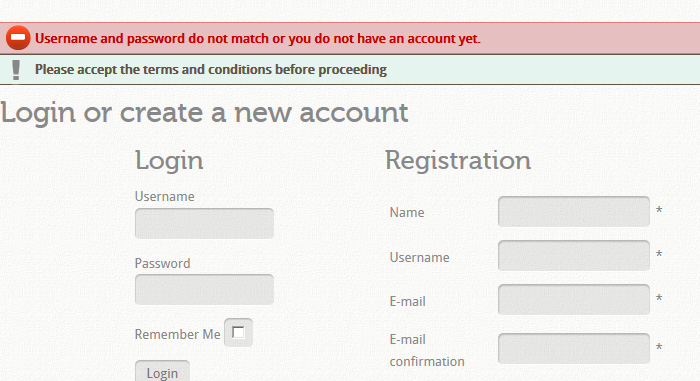

Another issue is when the user has a login failure (wrong password etc)
I now get the error message about the incorrect password and also the error message telling them to accept my terms. Please see attached.
This seems like a bit of a bug from a user point of view. Is there any fix? I need to have buyers accept my terms at the point of sale.
Thanks in advance
Kind regards

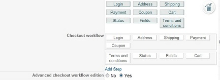

13 years 11 months ago #67412
Did you configured your checkout workflow like this for example ?
Last edit: 13 years 11 months ago by Mohamed Thelji.
  • Posts: 272
  • Thank you received: 7
13 years 11 months ago #67441
Mohamed - a thousand thank yous. I have only just realized you can add a step in and therefore break up the payment process. That has solved my problem.
