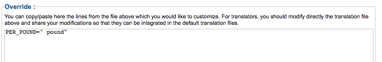

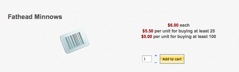

I followed the directions within the FAQ located at www.hikashop.com/en/support/documentation/faq.html#each
I continue to get 'each' as the unit of measure, rather than the 'pound' i setup for a given product.
I did make the changes to the language area and added PER_POUND to my override area for US English as well.
AT the present time the site is not online with DNS as I'm working with the client to convert over to a new system. I can provide the site and IP address if needed in a PM to gather any assistence if needed.
I'm on Joomla! 2.5.6 and Hikashop Business 1.6.0
cheers and thanks,
Kurt

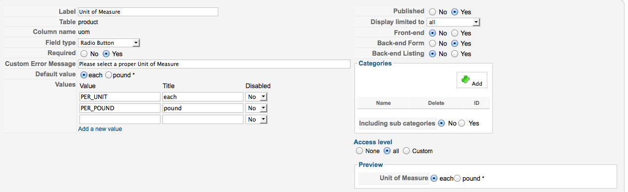

If you want to have help on the coding customization you did, we would need to know precisely what modification you did to which file and how you configured your custom field.
Could you please post some screenshots ?

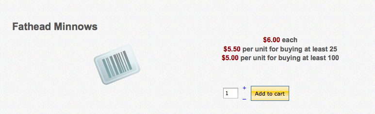

13 years 11 months ago #67311
Nicolas,

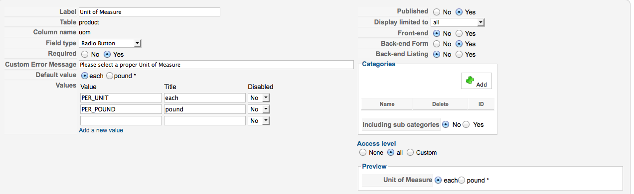

Attached are screen shots and the php file as defined by the FAQ www.hikashop.com/en/support/documentation/faq.html#each
I setup a custom field called "uom"
I edited the product / listing_price.php file and it's attached as an .rtf with my changed colored in blue
I added "PER_POUND" to my language file.
I double checked the back end SQL record and it shows the column 'uom' populated with 'PER_POUND'

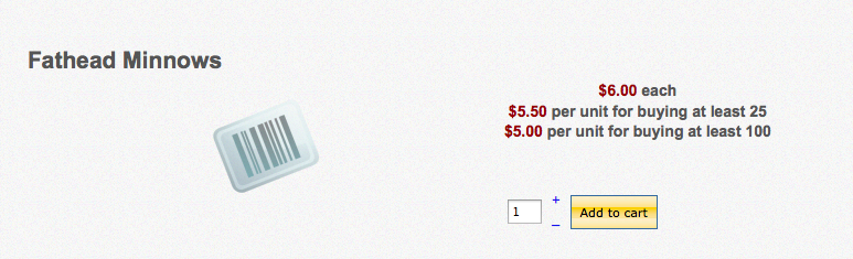

I included the front end behavior shot as well to show what is occuring.
Attached are screen shots and the php file in rtf format.
Thanks again, Kurt
