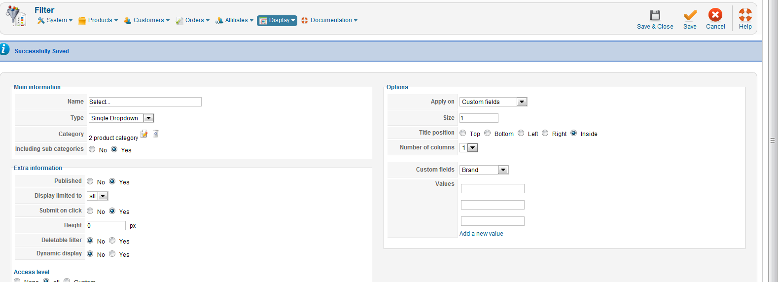

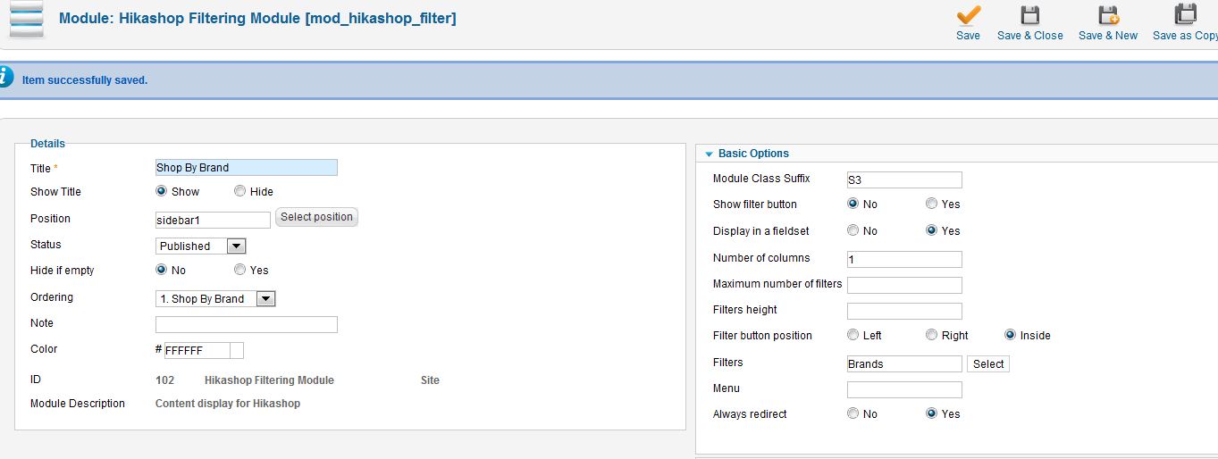

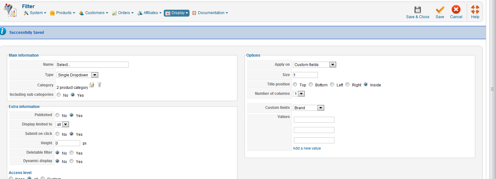

i am trying to create a filter based on brand, using a single dropdown
i am able to create the dropdown with all the brands, however when you choose the brand, nothing appears. i have assigned brands to the products.
here are the filter and module settings:
please help...
site is a test site at www.plumbing-deals.dreamhosters.com/ , and products are ONLY in brand Amba/Jeeves at this time

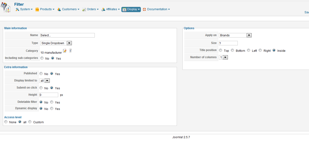

13 years 11 months ago #67271
Brands are working like categories.
For this filter, the best way will be to create a new custom field called "Brands" and apply it on the table "product".
Then create the filter on this custom field.
Hope this will help you.

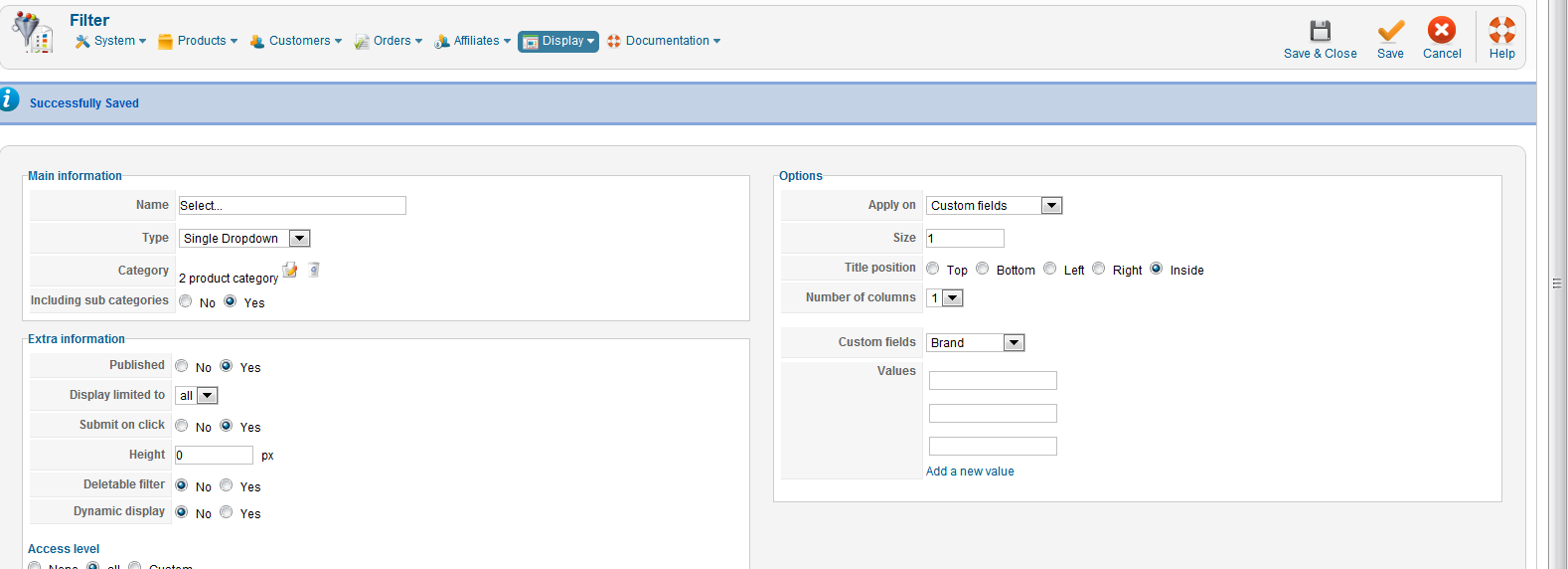

13 years 11 months ago #67343
this did not work
now nothing appears at all, and yes is filled in custom field "brand" on the product
also, what if anything is needed in "values"...there appears to be no documation for this field
thanks..
13 years 11 months ago #67370
Oups, my mistake.
Your configuration was good, you just have to set your products categories instead of "manufacturer" for the "category" parameter in the filter configuration.

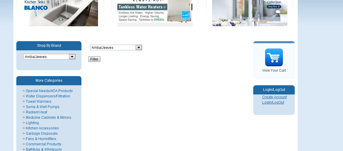

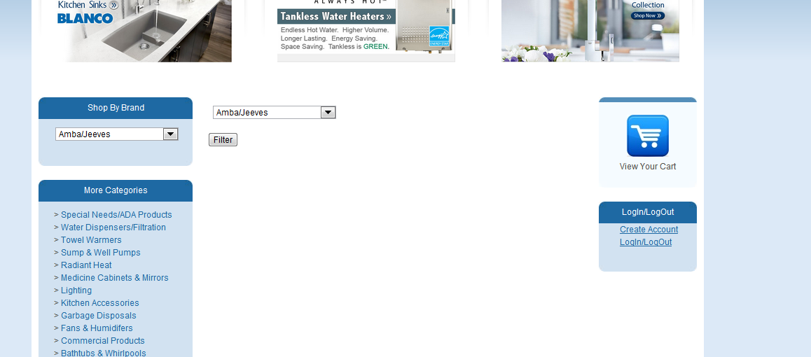

  • Posts: 223
13 years 11 months ago #67423
yes...
here is the result when you choose amba/jeeves from the dropdown list:

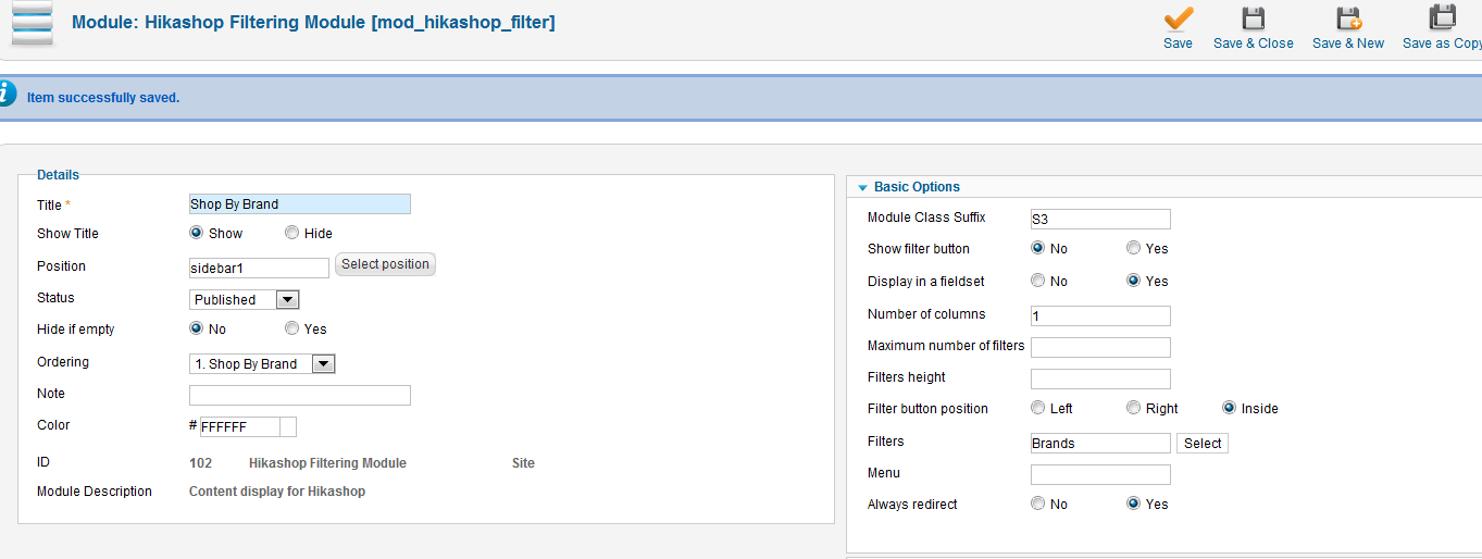

  • Posts: 86114
  • Thank you received: 14210
13 years 11 months ago #67659
The problem is that in the "menu" option of your filter module, you should enter the id of a products listing menu which displays all the products of your website.

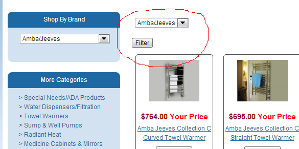

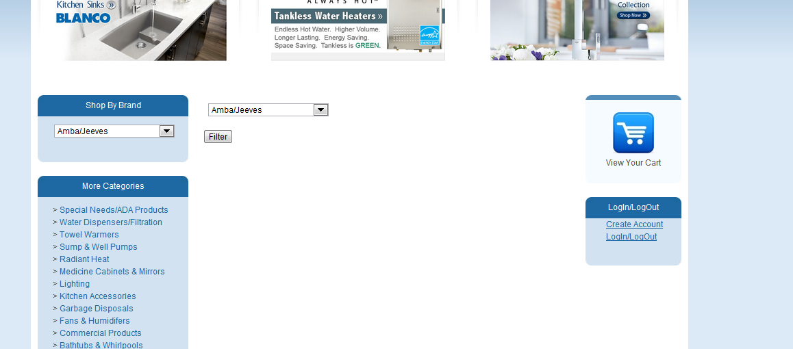

13 years 11 months ago #68267
Got it...now it works!

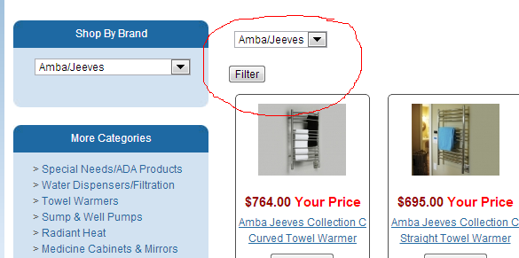

Final issue....
can i edit result page to remove parts circled in red....
thnaks...
  • Posts: 86114
13 years 11 months ago #68452
Yes, you can remove that.
The one at the bottom is a hikashop filter module. If you unpublish it, it won't display.
For the one at the top of the products listing, you can do as explained in the documentation of the filters:
On the other end, if you want to hide the filters on the main area of your page and only display the filters via the module, you can add such CSS (replace the X by the id of your menu) in the front end CSS file of HikaShop via the Display tab of the configuration :
#hikashop_category_information_menu_X .hikashop_filter_main_div{ display:none; }

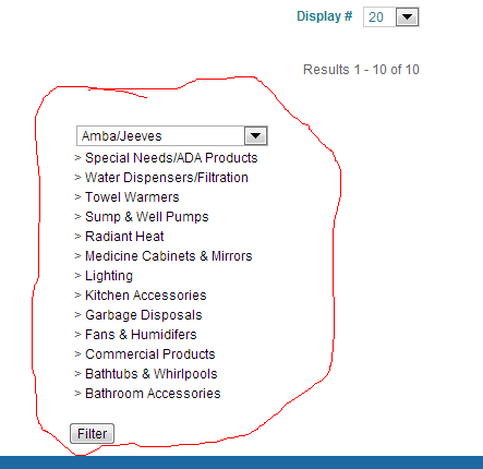

  • Posts: 223
13 years 11 months ago #68493
thanks, using css i was able to remove the top one.
the bottom however is not a single filter module...they are unstyled versions of the 2 filters on the left side of the page.
any ideas...?
thanks
Walter
  • Posts: 86114
13 years 11 months ago #68721
Go in the menu Display->Content menus, edit the file with the id 108 and disable the module with the id 88 in the "associated modules" option and that should solve the problem.

  • Posts: 86114
13 years 11 months ago #68947
In the mean time, you have created a new menu. It's now the menu with the id 109 where you need to disable the module with the id 89 in the "associated modules" option and that should solve the problem.
If you look at the HTML of the page, you can see these in the attributes of the HTML tags.
