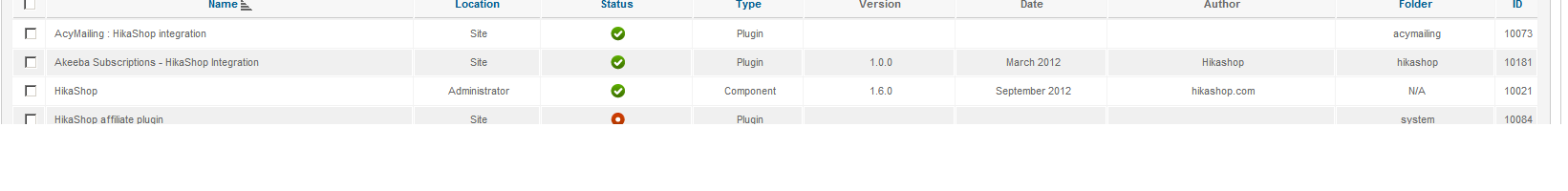

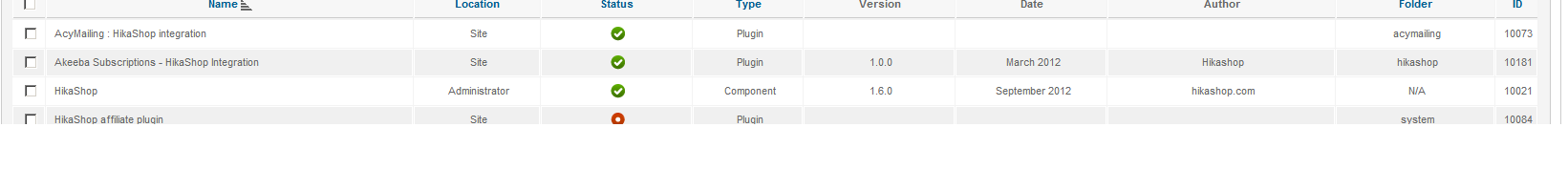

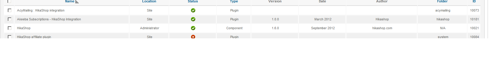

Hello Xavier
I changed the version in my database, in the table '#__hikashop_config" the row "version", set 1.5.9.
Now I have 1.6.0 in the Joomla extension manager, is it important?

No that's ok.
I checked your checkout and didn't had the display problem that you said you had in your email (screenshots).
So it seems that the problem is solved.
