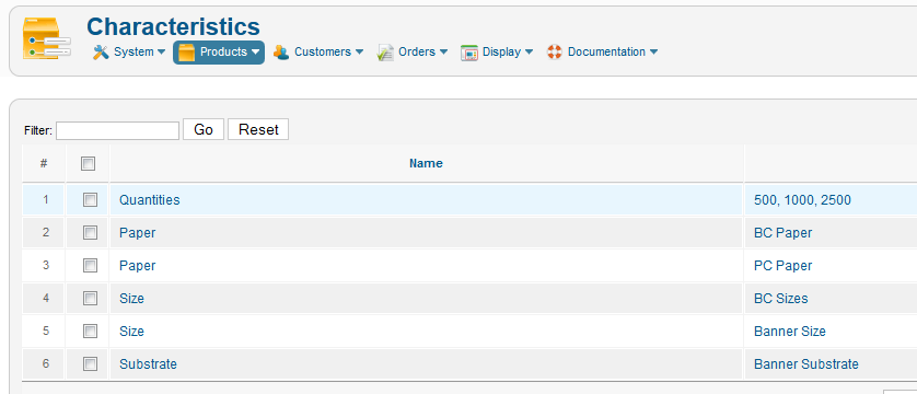

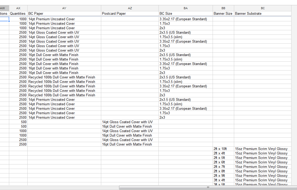

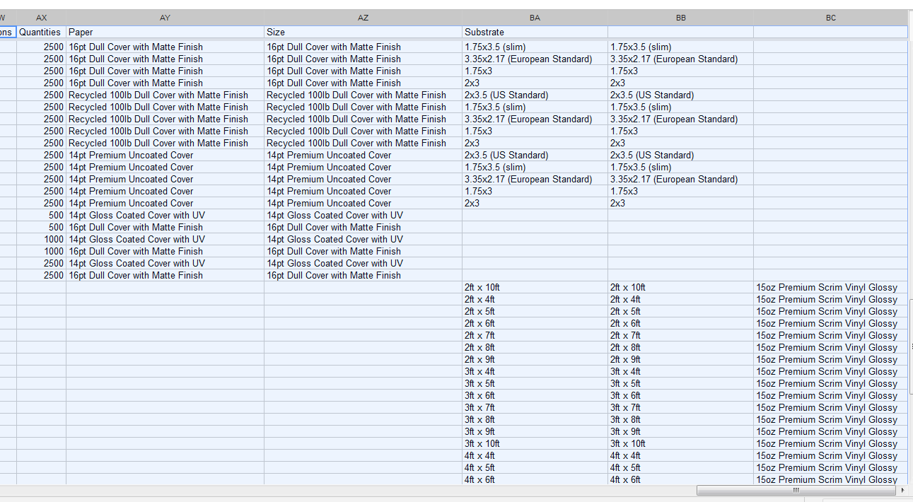

When I export my products the column heading for characteristics don't line up. This is because I use "Size" and other names multiple times with different Aliases. I do this because it is what the end user sees. Putting "Itemname Size" for all my items with different sizes seems odd.
Similar to this threads issue, although he was importing.
www.hikashop.com/en/forum/4-how-to/58574...s-with-products.html
I used the file from that thread hoping it would export them properly but it did not. I can put everything in using the interface but would rather use CSV since it would be much quicker.
I will also have to associate multiple files for download for each size variant of each item and having to do it in the interface is going to take forever. If I could attach it to a characteristic then that would work out well as all 2x3 or whatever would show it, but that is not an option that I can see currently.
Being able to use CSV will a be a great time saver if I can get it to work with my shop setup.

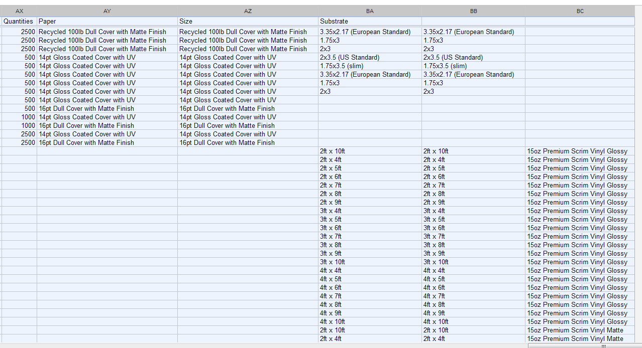

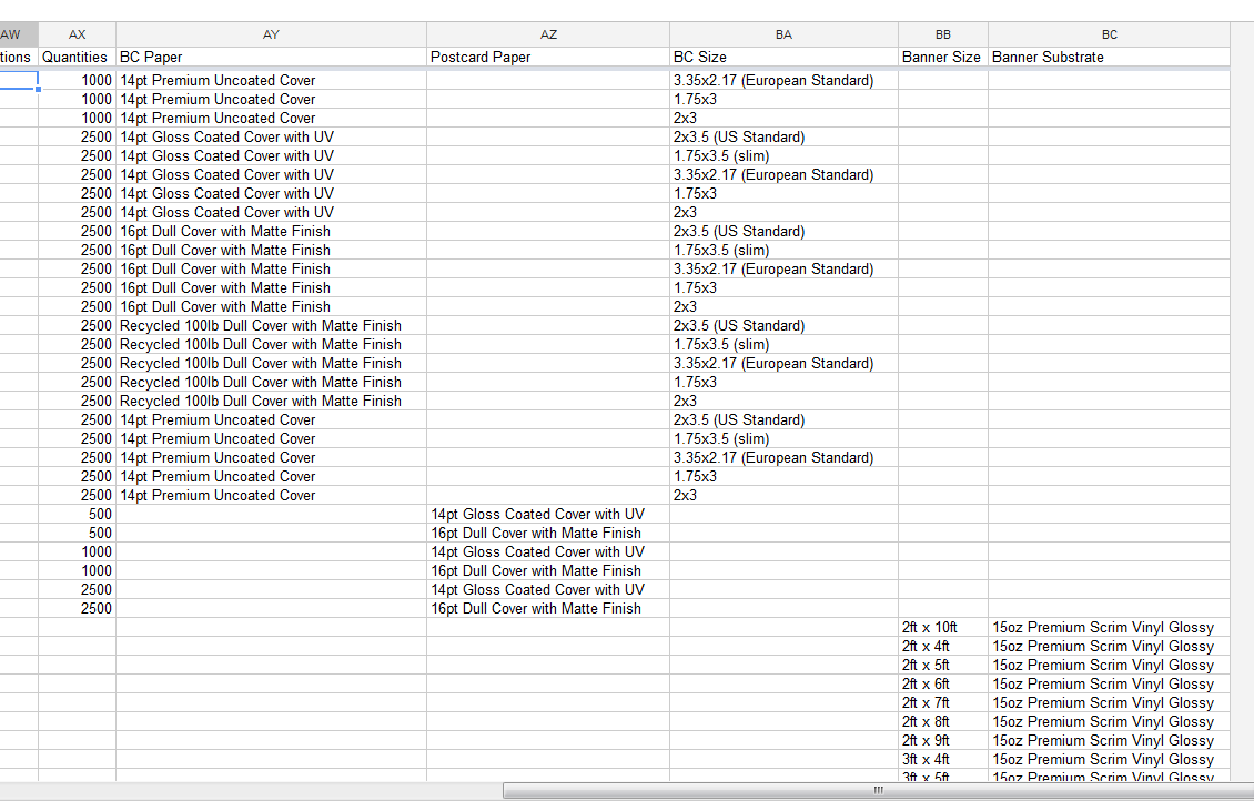

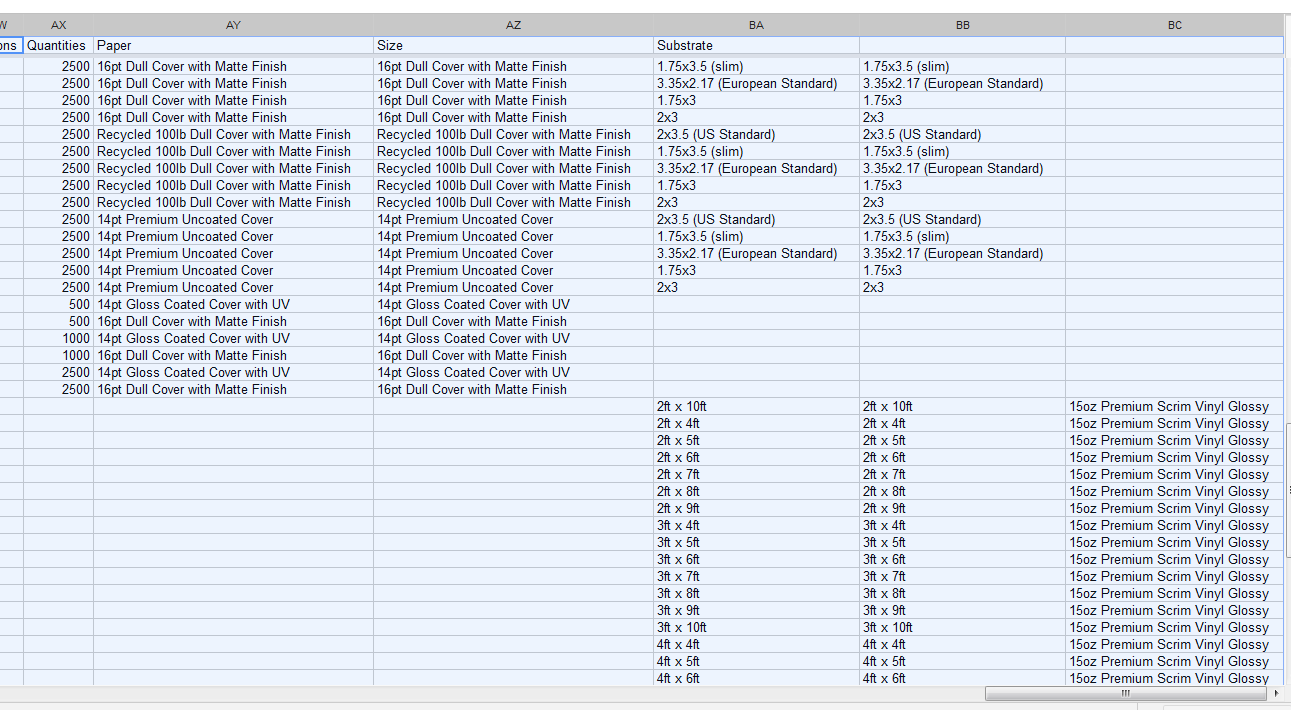

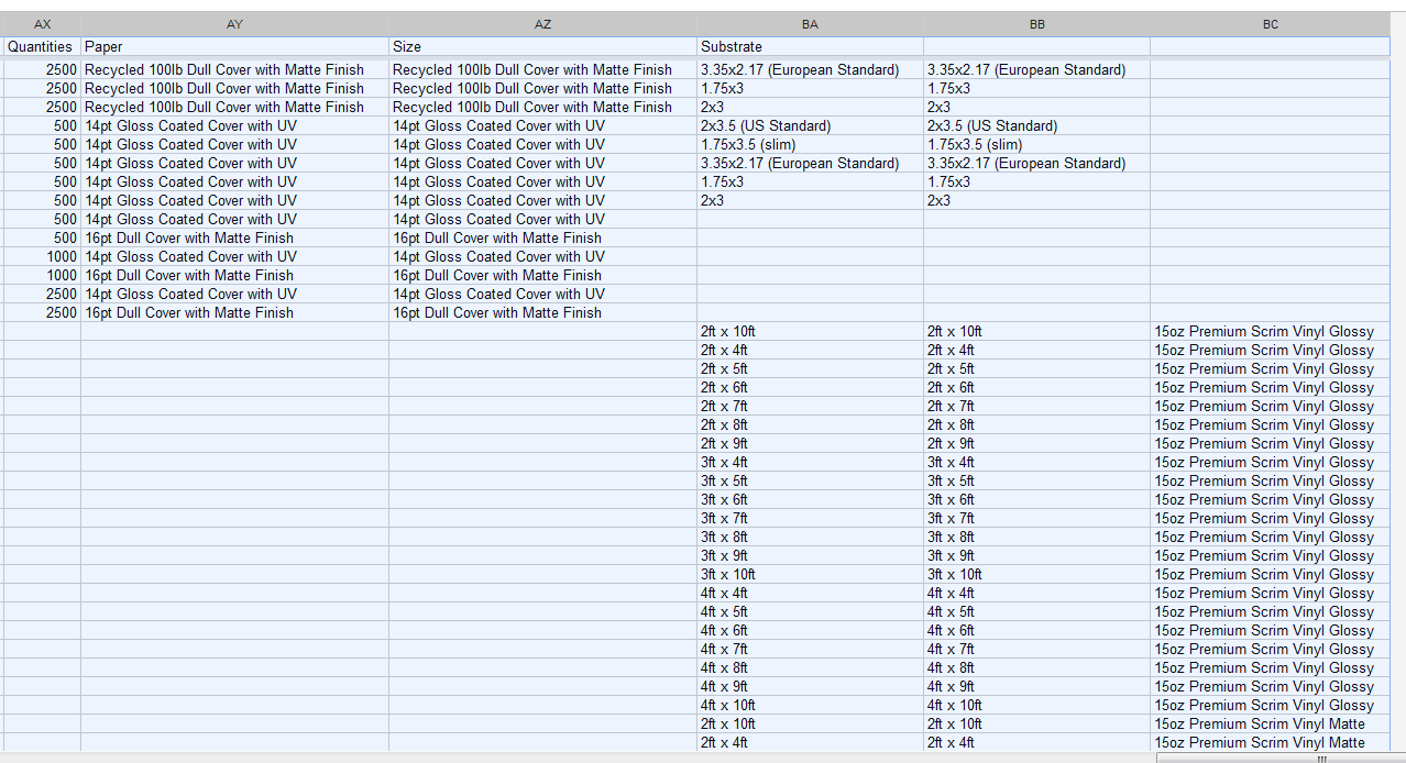

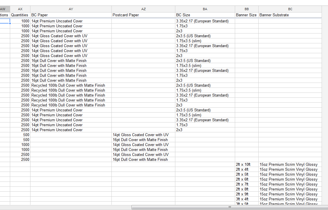

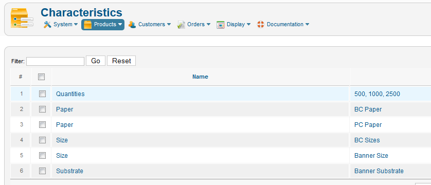

The export works fine even before all of this if using different names vs just different aliases.
BAD EXPORT with Changed Export PHP
GOOD EXPORT when using different names.
So currently what I have is not working for same name but different aliases. Let me know if I did not do something right. I would prefer to use aliases for visual appeal. If not I can use different names.

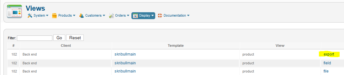

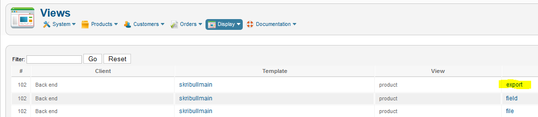

Based on your screenshots it seems that you're using the default template of the backend.
That template is either Khepri (joomla 1.5) or Bluestork (joomla 2.5).
On your Views listing screenshot, I can see that you're editing your view for another template called skribullmain.
So that's why it's not working since your backend template is not seeing your modification.
  • Posts: 37
13 years 11 months ago #68503
I knew I had to be doing something wrong. Let me try that.
EDIT: Export looks good tyvm.

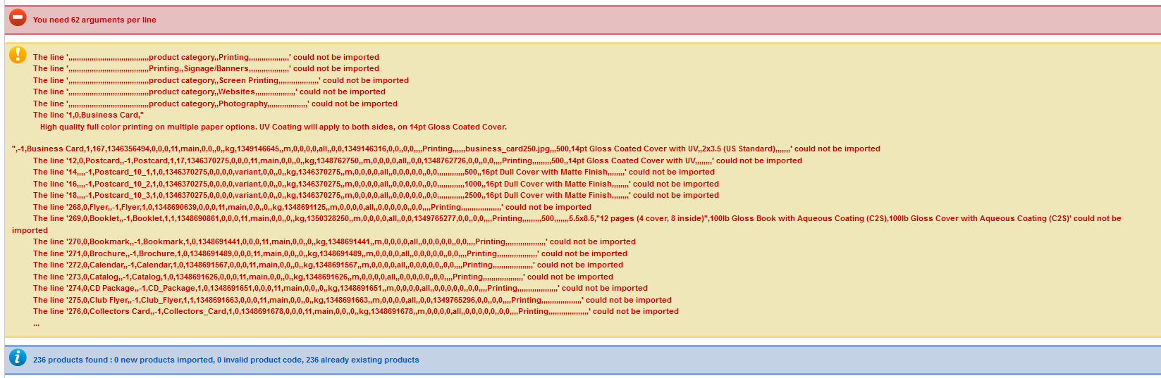

  • Posts: 37
13 years 10 months ago #70190

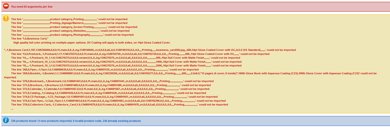

Ok, it exports and I get the right characteristics in the CSV.
Importing no longer works.
I even tried switching between orginal and new characteristics.php from this thread
I made no changes to the file, just tried importing it. I then tried changing one price with the same error.
Last edit: 13 years 10 months ago by blbeta.
