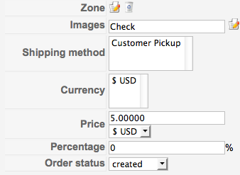

Good evening,
In the check payment plugin as well as the paypal plugin, there is a provision to add on a fee either as an amount or a percentage.
Can this amount or calculated percentage be shown on a seperate line item on the invoice, both during the checkout process and in the emails sent?
For example:
Name Unit Price Qty Total
Walleye 3-5 inch $2.50 10 $25.00
Check Payment Fee $5.00 1 $5.00
Final Total $30.00
I entered a fee on the screen and it's not being computed within the invoice.
Attachment shows the payment method setup.
Thanks,
Kurt
