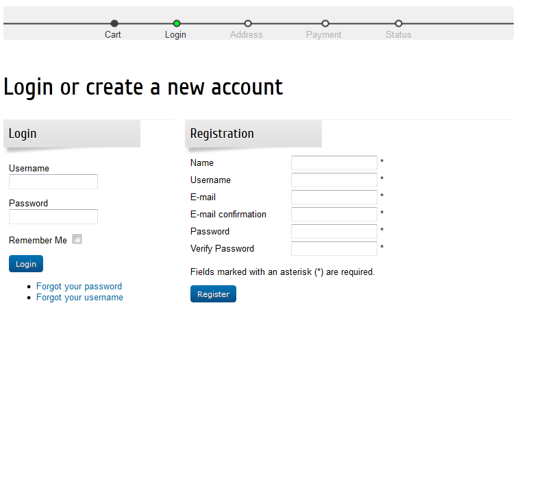

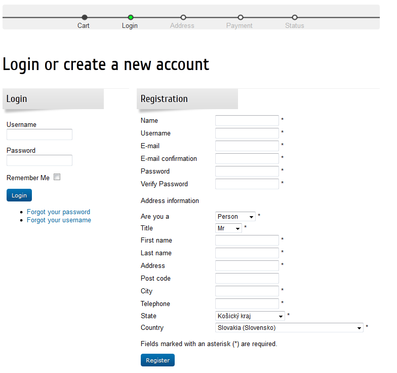

I would like to know if i remove the address block from login/registration view (wanted screenshot), is it enough to have as next step (in checkout process) the address view (to allow user to add new address) ?
i want to be sure that user can't skip the address step without having a valid address for invoice.
i did some test to remove it but when clicking on "register" button, joomla asks me to fill all needed field (from address template even if it is removed)...
(original screenshot)
thx
