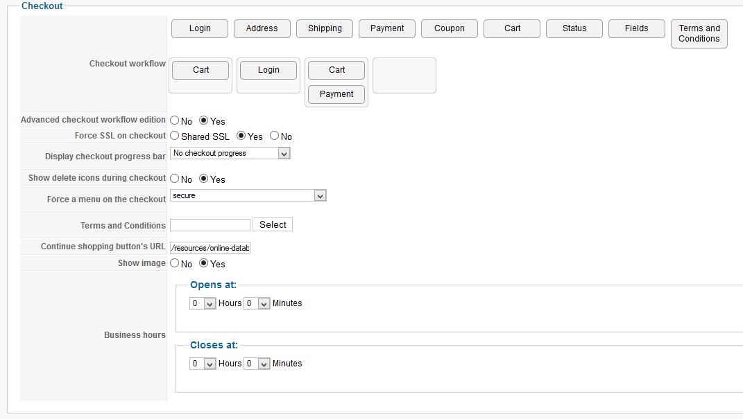

I am having the same issue as the OP.
When I have the checkout workflow set up the way I would like it:
Step 1: Cart + Login
Step 2: Cart + Payment
Then if a user logs in they access the payment page fine - but if it's a new user registration then it skips the payment page and goes straight to the Thank you for your order page as mentioned above.
But If I alter the checkout workflow and (for example) spread it out across 3 steps instead of 2. Then the final page includes every possible selection even though it is not enabled PLUS it changes the currency to Euro even though that currency is disabled.
So for example Step 3 has just Cart and Payment in the workflow - but it displays the following:
  • Checkout Progress bar (even though it is disabled)
  • Billing Address (even though it is not in the workflow)
  • Payment
  • Coupon Code Input (even though it is not in the workflow)
  • Cart
  • And the currency is in Euro (even though AUD is default and Euro is Un-published)

  • Posts: 35
11 years 10 months ago #168881
Hi Xavier, It's v2.2.0 and the workflow is attached.
11 years 10 months ago #168941
Thanks to update your HikaShop versionn the latest one is 2.3.2 and this bug has been corrected. ;)
