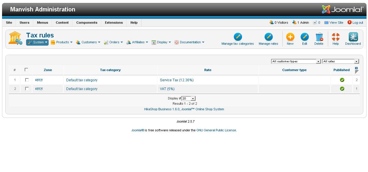

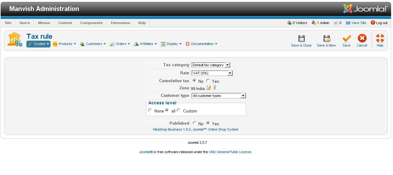

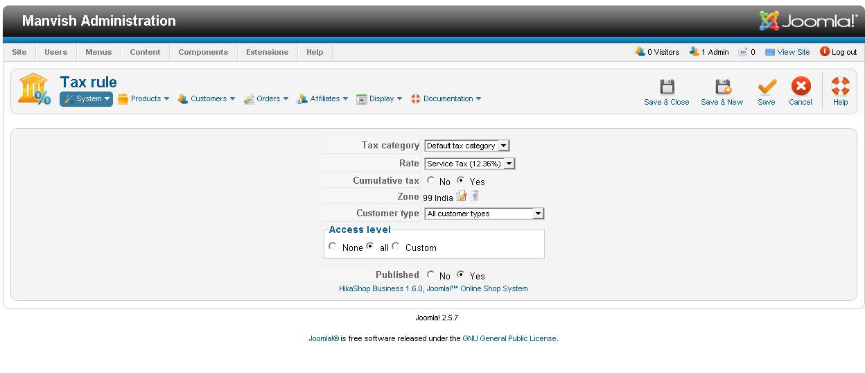

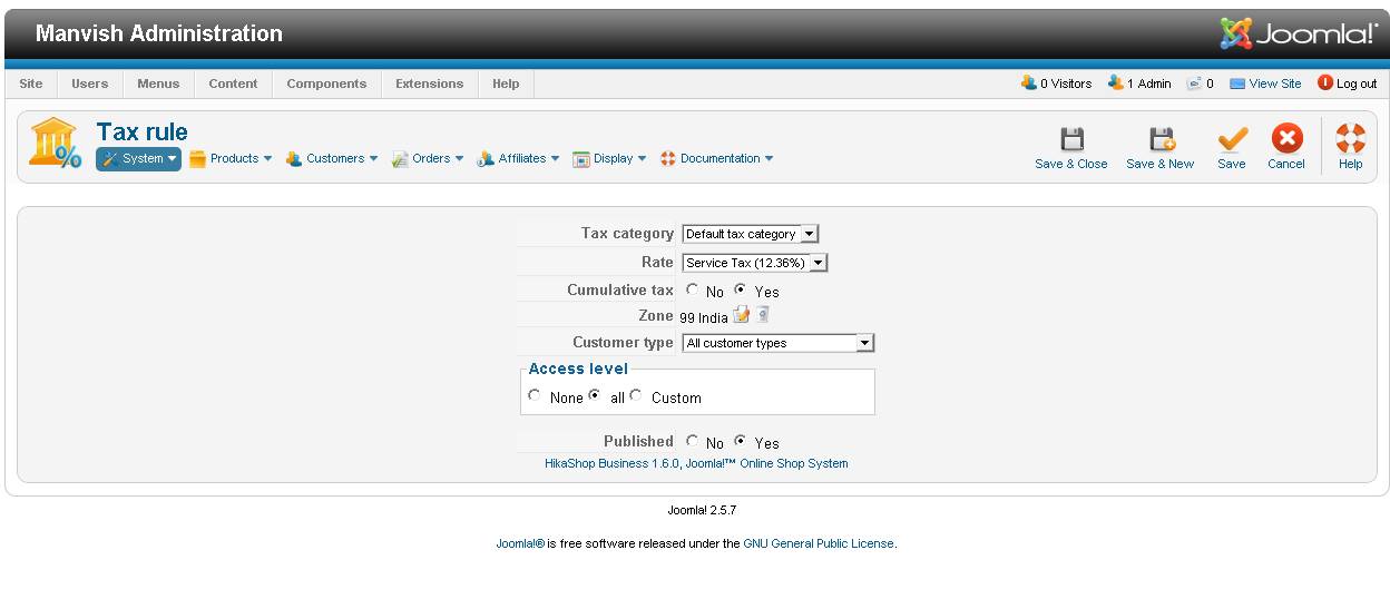

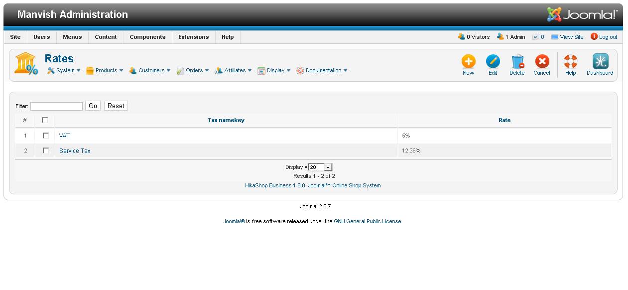

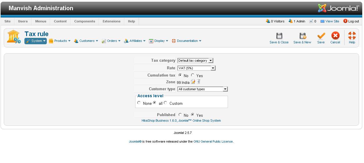

  • Posts: 83
13 years 11 months ago #69700
Thanks for the reply.

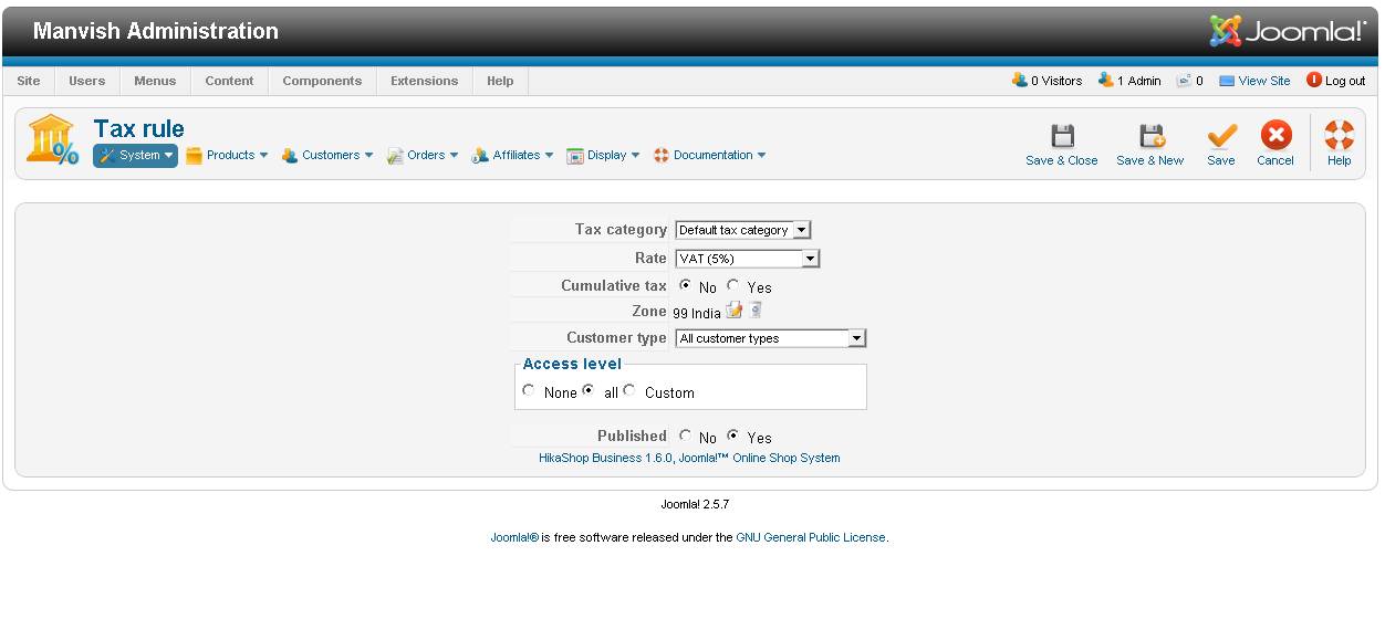

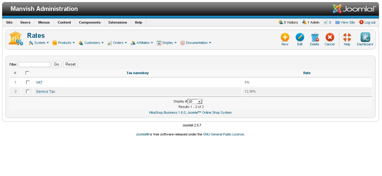

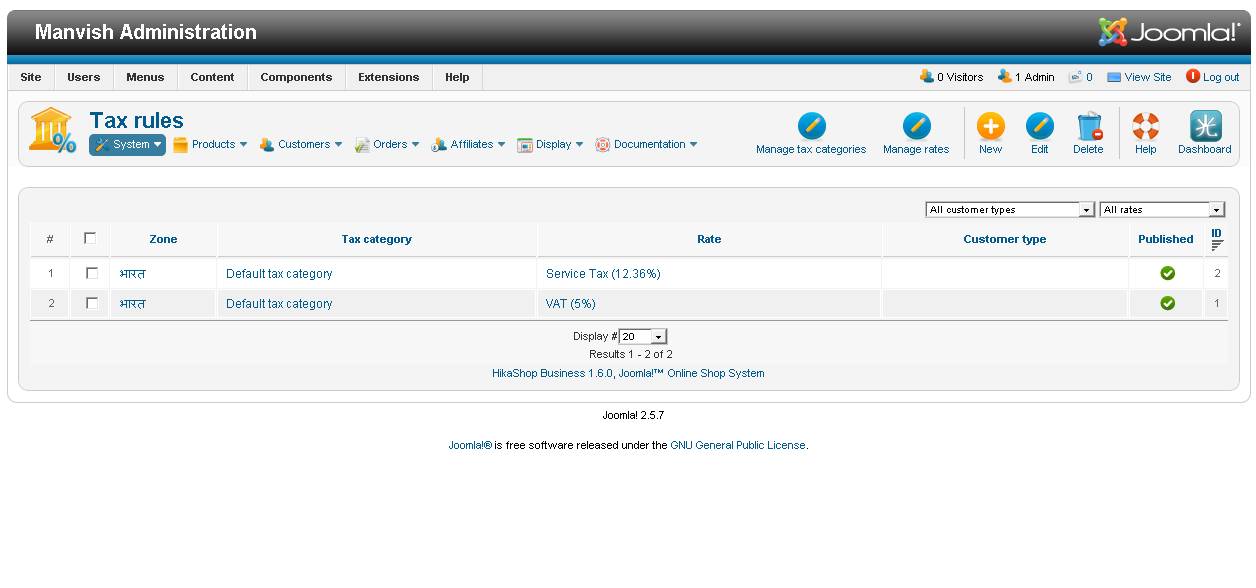

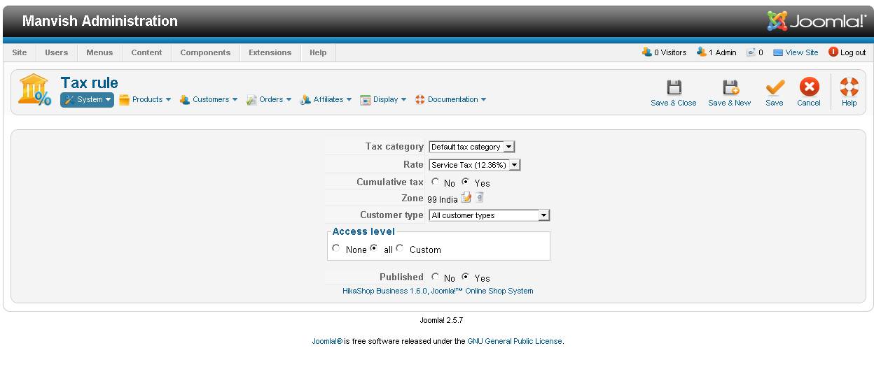

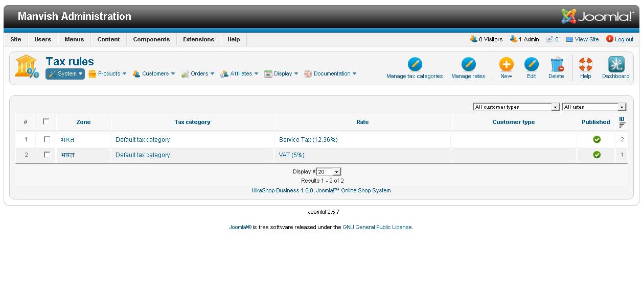

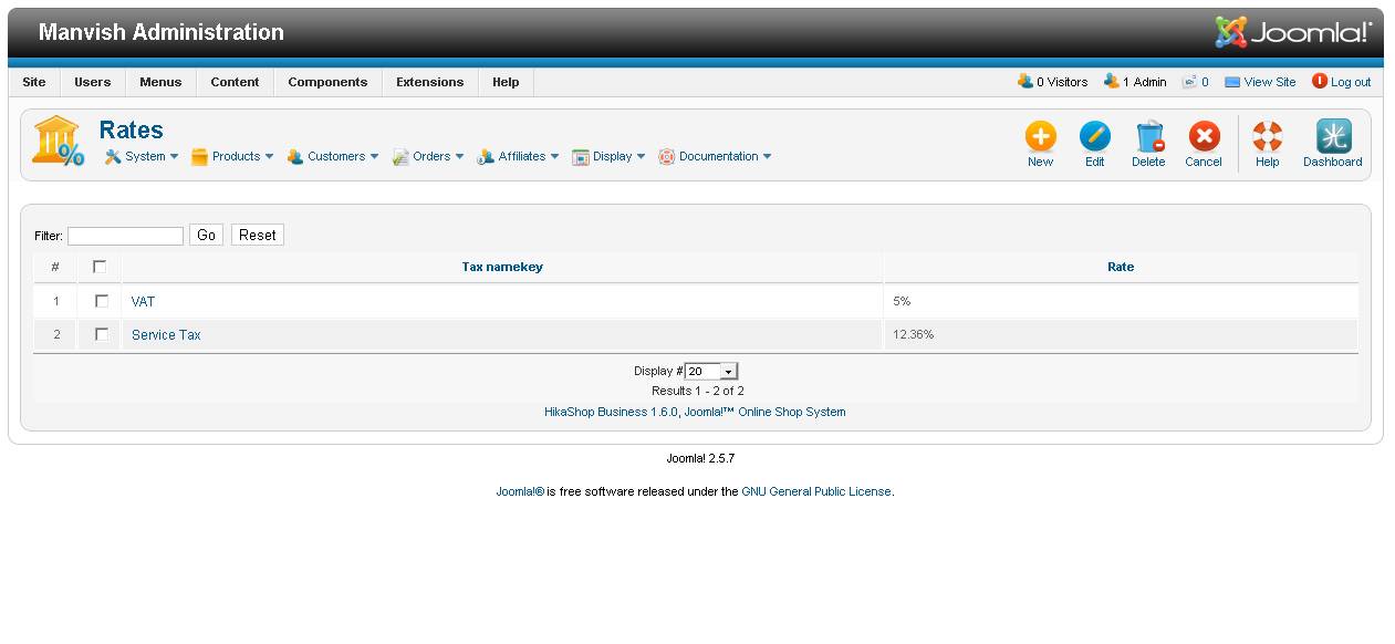

I've attached few screenshots of the pages for creating the tax rules and tax rates.
Please check the same and let me know whether I've done this correct or not as still I've some confusion.
