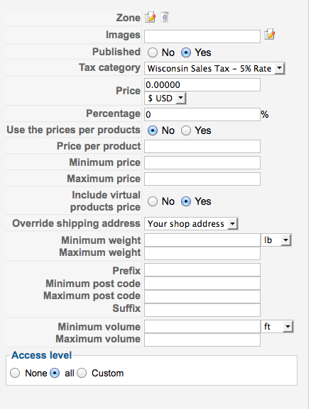

Hi Cyngen,

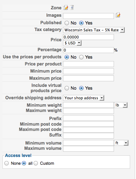

In the Shipping method configuration, you can set the option "Override shipping address" to "Your shop address" it will override the address of the customer.
You can too change the tax category of the shipping method.

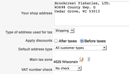

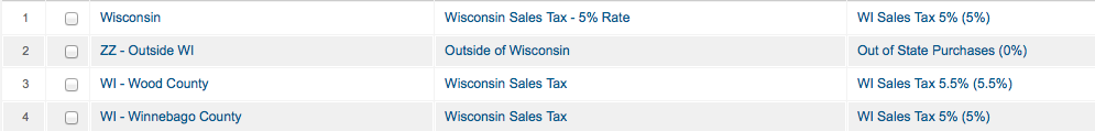

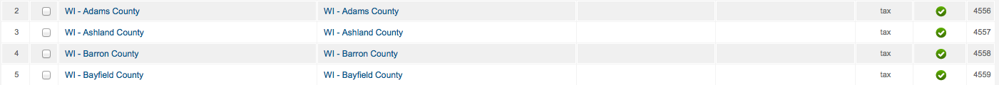

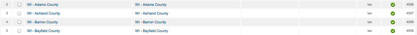

I did all that and I'm not getting sales tax to show up properly. I will include screen shots of what I've configured. The technique should also override all other tax codes including 'out of state' which is zero tax if ordered and shipped there -- except anyone that has a tax exempt number on file.

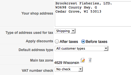

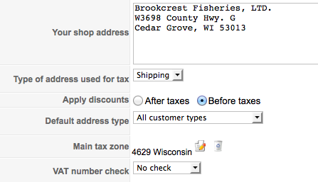

1. Setup of Shop address

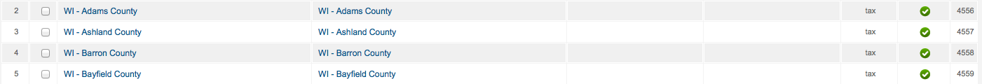

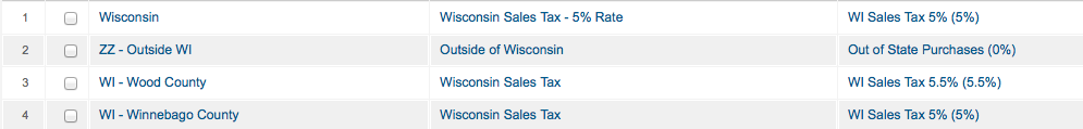

2. Setup Tax Zones -- Each County within the State of Wisconsin can have a different sales tax rate. Based upon Nicolas' input, this was setup. There are 73 tax zones setup, one for each County plus 'out of state'.
3. Tax rules have been established and work fine based upon the customers address.

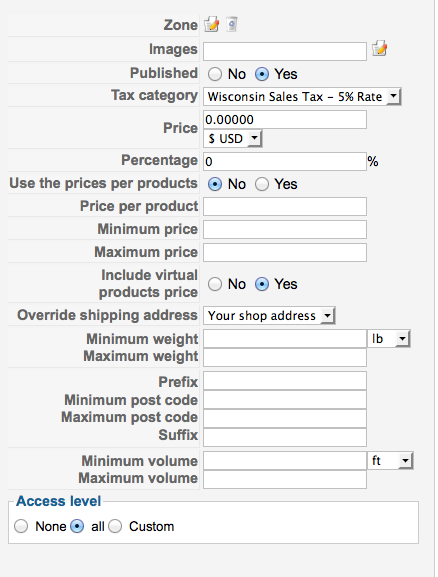

4. Manual Shipping Method - Customer pickup configured.

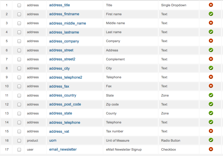

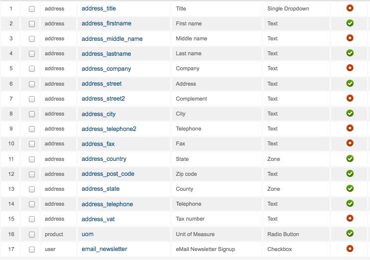

5. Custom fields reconfigured per discussion with Nicolas. The address_country is now 'state' and each state is in the Country zone. The address_state is now 'county'.
Based upon the customer address for shipping with the county set correctly, the sales tax computes properly. I do not get the tax computed properly from the pickup shipping. Thoughts? Where did I misconfigure?

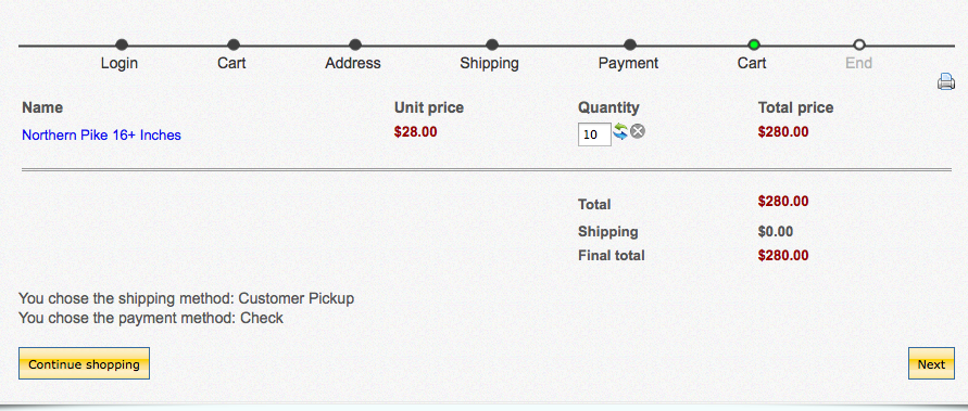

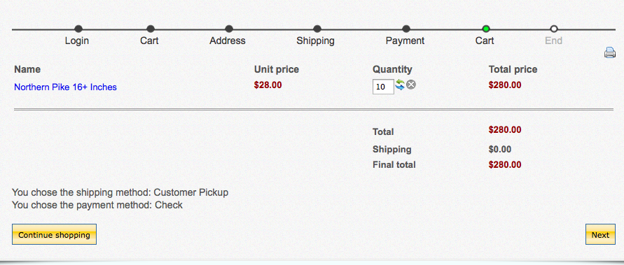

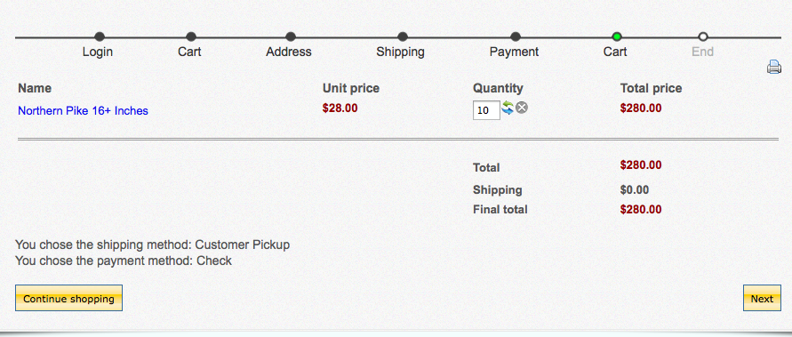

Replaced the code and tests. No tax is showing up ... Now, could there be some other configuration I'm not following properly?
I can give you backend and ftp access to the site to take a look. I'm sure it's something very simple and perhaps taking a look at it will help you help me :whistle:

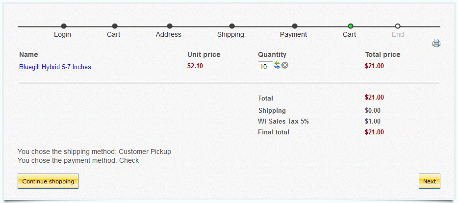

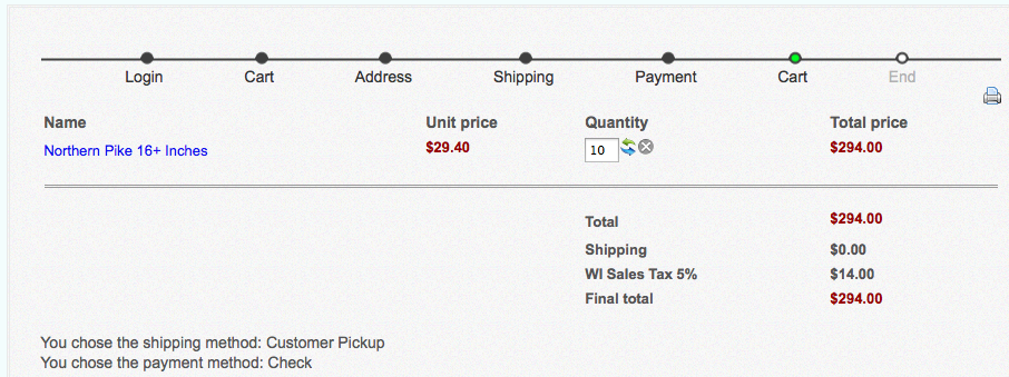

Attached is the shopping cart after shipping has been selectd. No tax is showing and it should be 5%.
I can supply credentials via PM.
Last edit: 13 years 10 months ago by Cyngen.

13 years 10 months ago #70894
Ok, it's seems to be working fine now.
You just had to set a state for the main zone instead of the Wisconsin country.

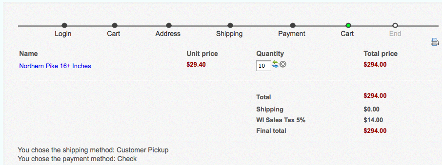

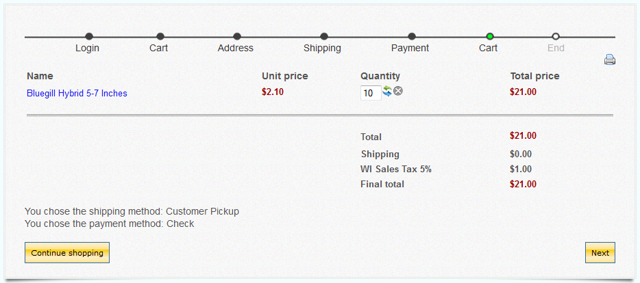

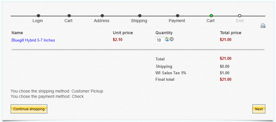

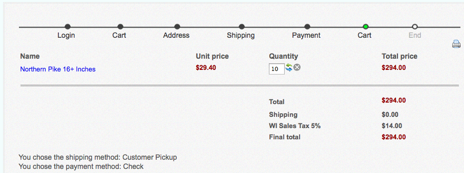

OK Great, I see it showing at the proper percentage however... i see two issues yet that may or may not be related here:
1. The sales tax is not correct. At 5% on $294.00 should be $14.70 and it's calculated as $14
2. The sales tax is not being added into the total.
See the screen shot I've included. Great progress thus far and i'm thankful for the help.
Kurt
13 years 10 months ago #70903
Just tried on my end and the price is correct for me:
The sales tax is already included in the final total, it's just an overview of the informations for the final total.
  • Posts: 49
13 years 10 months ago #70904
Xavier,
The tax should be $1.05 at a 5% rate not $1.00
Also note, the tax isn't added into the final total
Thank you,
Kurt
13 years 10 months ago #70913
The product price is $2, 5% of $2 = $0.10. so the product price with tax is $2.10.
The taxes are included immediately in the product price, that's why the total price and the final total price are the same.
