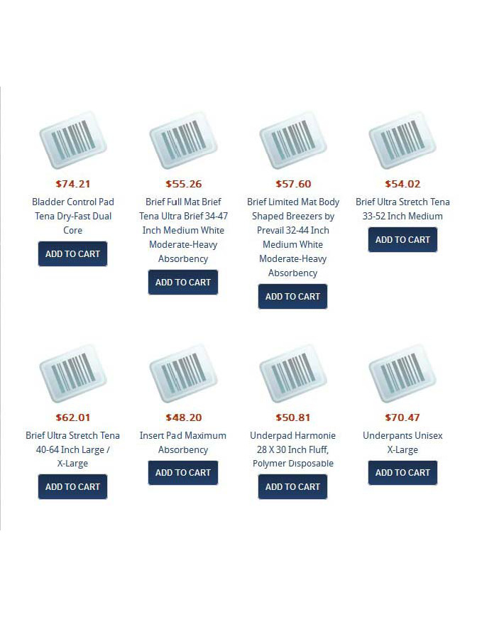

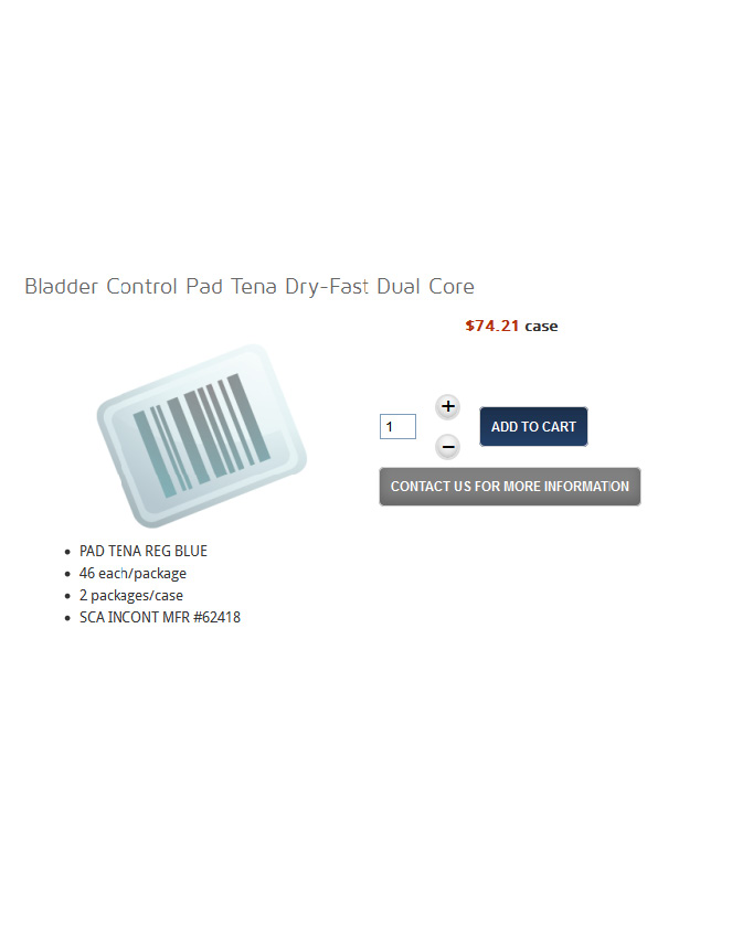

I am trying to get a custom field of "per_unit" or "per_case" into the category view next to the price. I have the correct "per_unit" in the product view, but for the life of me I can't figure out how to get into the category view. So I was wondering if this is possible.

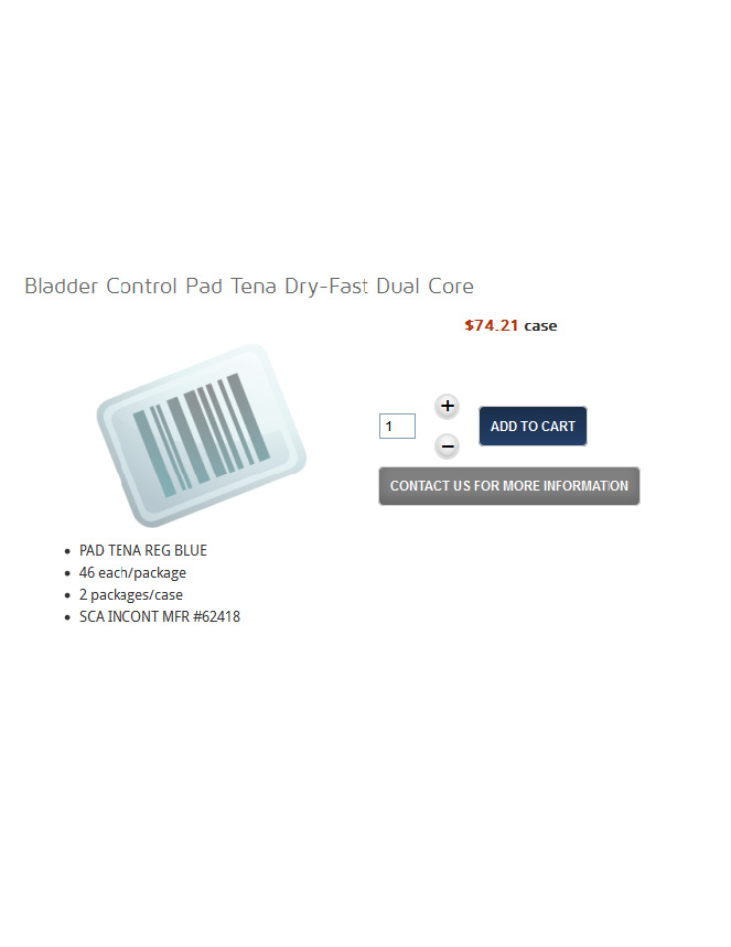

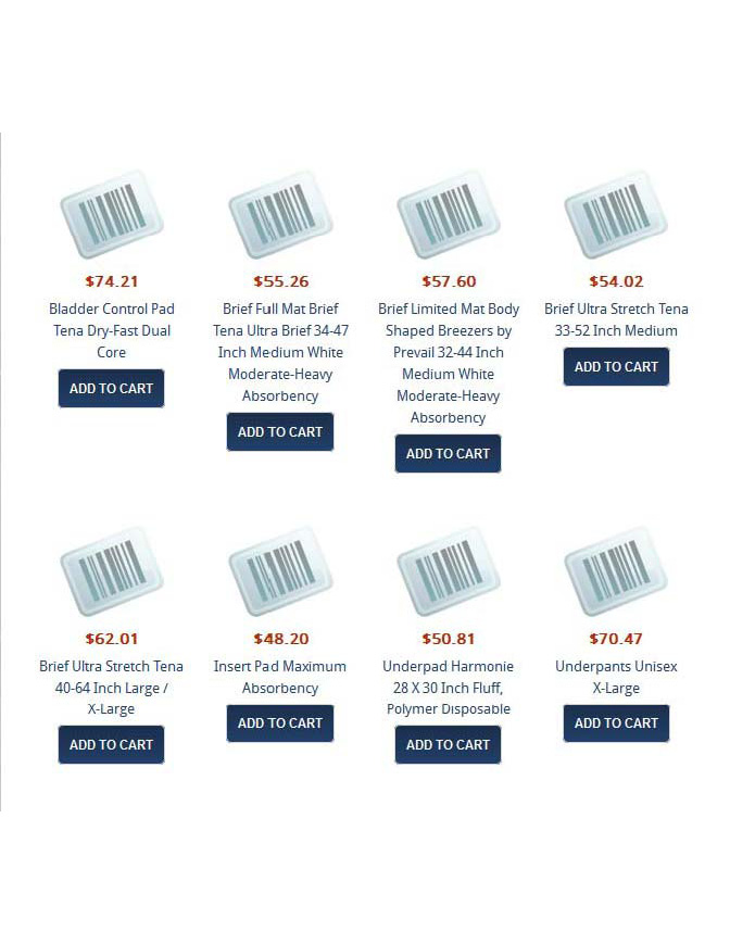

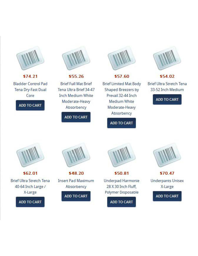

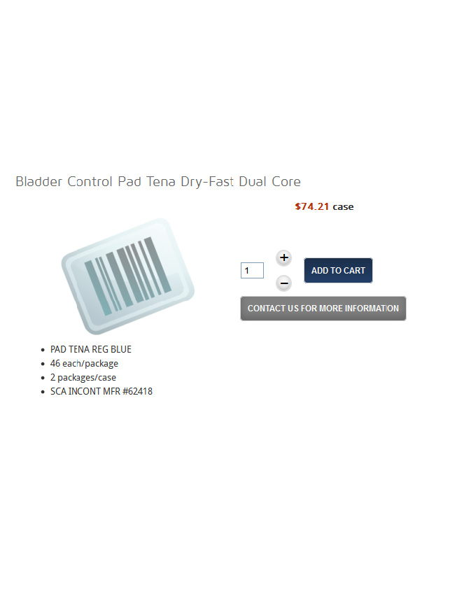

thanks for the reply. I have already seen the FAQ's and changed the necessary information on the site, but for some reason the "per_unit" does not show up in the category view. I've attached two images to explain what I mean.

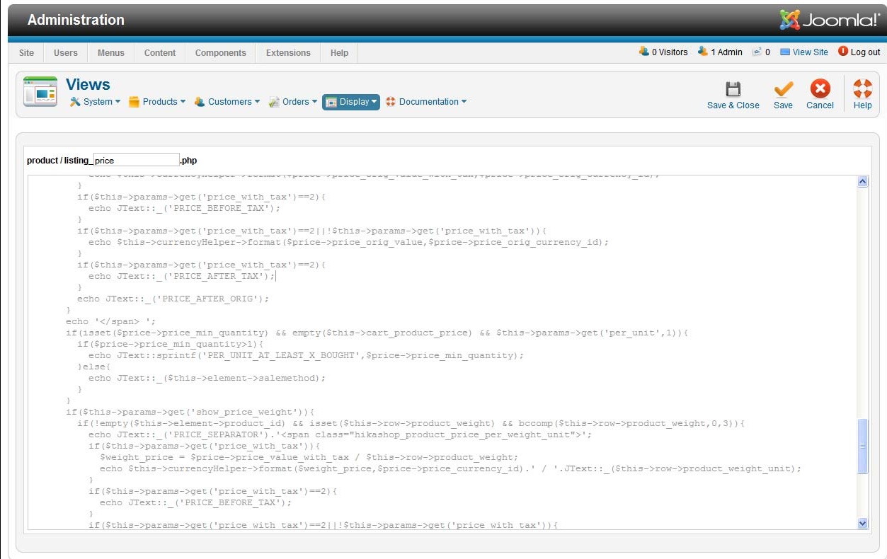

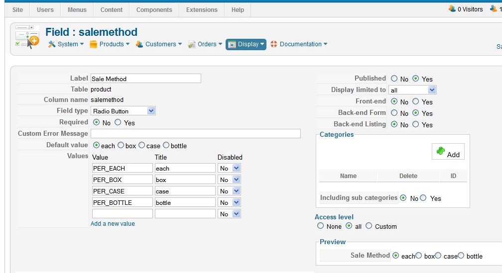

Can you also do a screenshot of the code modification you made and of your custom product field ?

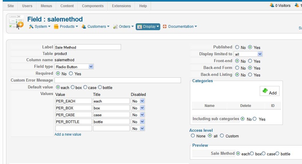

The settings for the custom product field looks like this:
product/listing_price.php:
if(isset($price->price_min_quantity) && empty($this->cart_product_price) && $this->params->get('per_unit',1)){
        if($price->price_min_quantity>1){
          echo JText::sprintf('PER_UNIT_AT_LEAST_X_BOUGHT',$price->price_min_quantity);
        }else{
          //echo JText::_('PER_UNIT');
          echo JText::_($this->element->salesunit);
en_GB.com_hikashop.ini:
PER_UNIT=" each"
PER_DOZ=" doz"

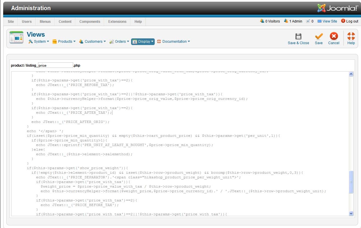

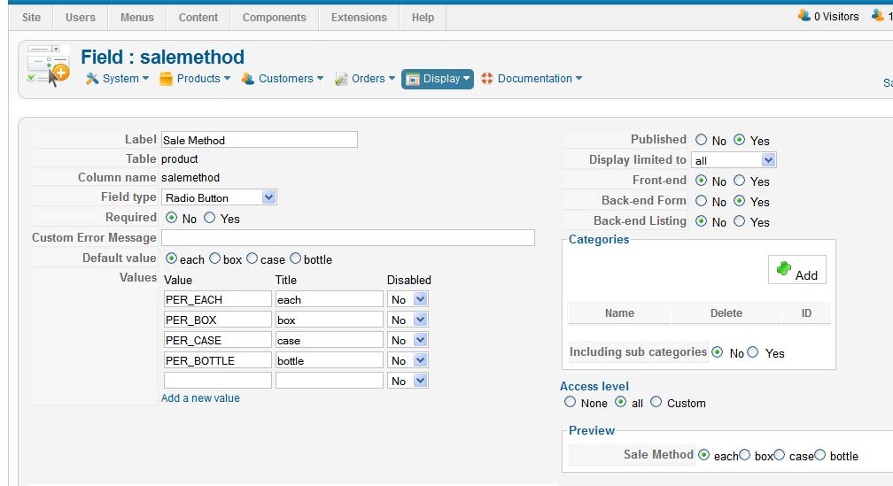

  • Posts: 3
13 years 9 months ago #70406
Here are the screen shots that you requested.
Thank you for the help!
nicolas wrote: Can you also do a screenshot of the code modification you made and of your custom product field ?
