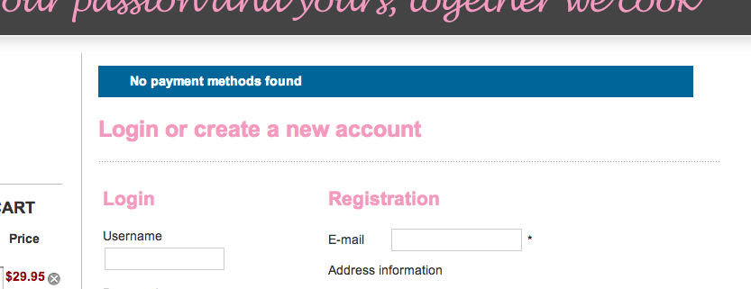

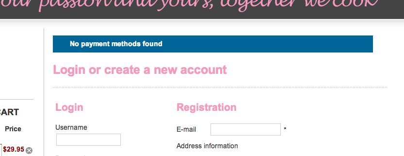

I am having a problem with the checkout. Paypal is configured as a payment option although the message "No Payment Methods" appears until the user logs in. Then when they log in that message is gone and the order can be processed.
Please see the screenshot below.

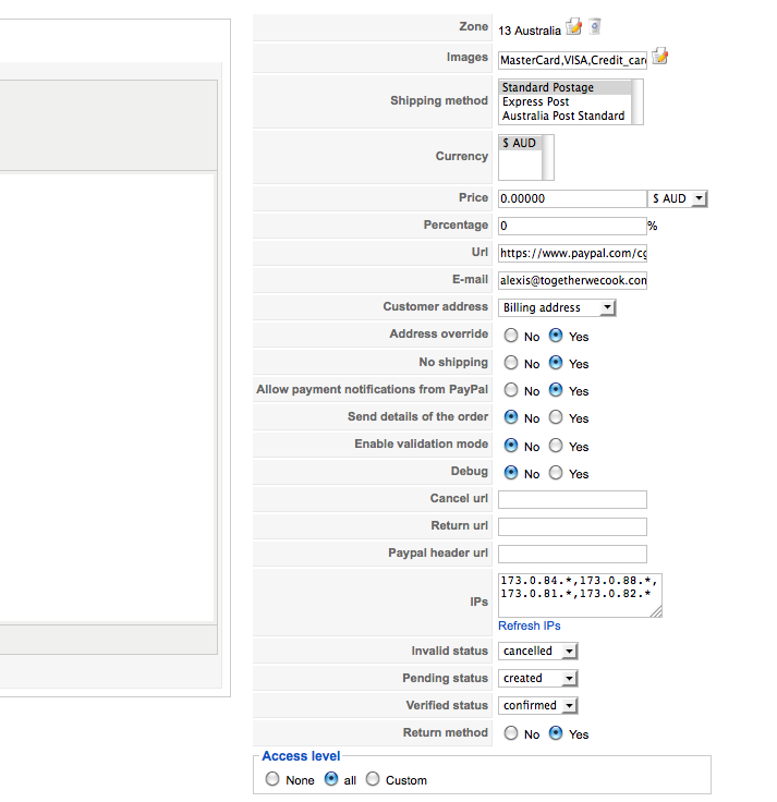

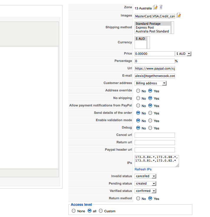

please post a screenshot of the options of your payment plugin.
  • Posts: 136
13 years 10 months ago #70277
Screenshot attached
  • Posts: 86112
  • Thank you received: 14209
13 years 10 months ago #70382
You have restricted your payment method to only display when the address of the user is in australia, and that the shipping method selected by the user is "standard postage".
I suppose that it's not what you want. Please remove the zone restriction and the shipping method restriction that you set.
These two points are clearly mentioned in the FAQ:
5/ If you restricted your payment methods to zones, check that the address you're using is inside those zones ! Otherwise the payment methods will be filtered out.
8/ When you select a currency or a shipping method in the options of the payment method, the payment method won't display unless that currency or shipping method is selected during the checkout. In most cases, these parameters shouldn't be selected so make sure they are unselected. To unselect them, you need to press the ctrl key and click on the selected currencies or shipping methods.

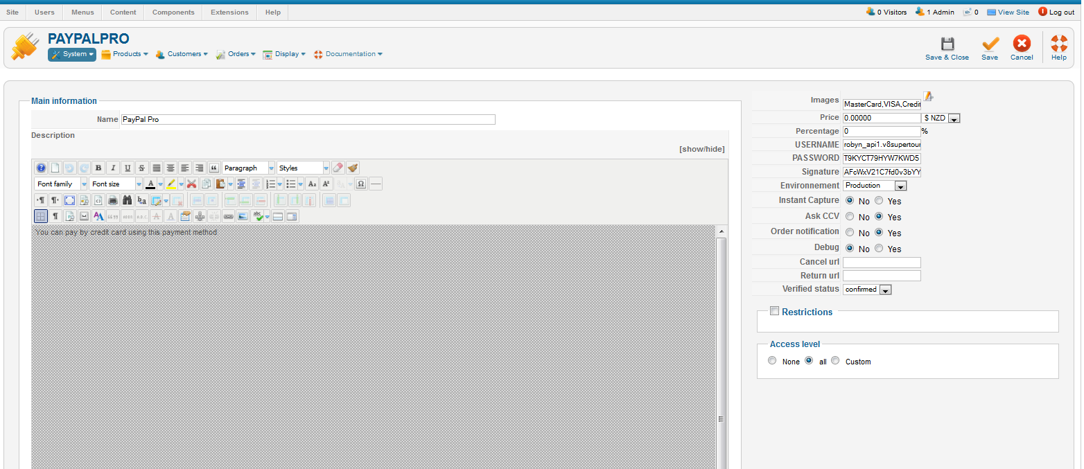

13 years 4 months ago #101082
While I'm having a nightmare time with the cart and address facility - can you explain how I remove 'restrictions' from the Paypal Pro payment option. If I untick the option then save the tick bounces straight back in and acts like nothing happened.
It may be that if I could get past this the rest will fall in to place?
13 years 4 months ago #101105
Regarding the zone restriction, you'll juste have to use the "trash icon" in front of your option, and for your shipping method option you can press "ctrl" on your keyboard and then click on the shipping method :).
Hope this will help you a little.
Last edit: 13 years 4 months ago by Mohamed Thelji.
  • Posts: 11

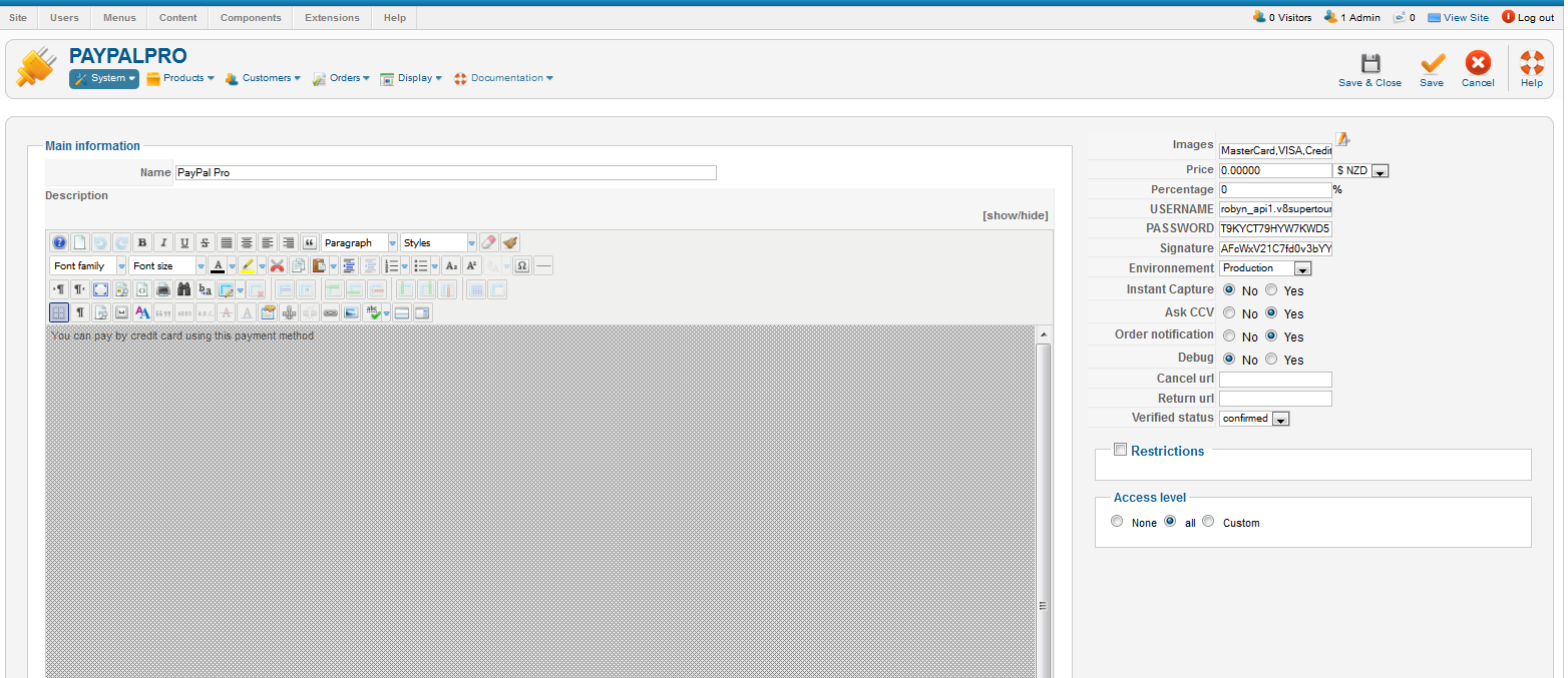

13 years 4 months ago #101116
Thank you - I got it to remove the tick in the restrictions. It's working, but I haven't been able to get the PayPal Pro version to work. Still, one is better than nothing!
13 years 4 months ago #101133
Ok, so can you show me how did you configured your paypal pro payment method through some screenshots ?
  • Posts: 11
13 years 4 months ago #101235
Thanks for your interest Mohamed.
Basically it's configured the same as the PayPal standard except it has the additional 'Username' 'Password' and 'Signature' that you obtain from the PayPal account.
I'm not getting an error that it can't connect, just that when it's selected as the sole payment option I get the dreaded 'No payment options' message as a website user.
13 years 4 months ago #101428
Ok can you give me a temporary access to your back-end for testing purpose through Private Message?
  • Posts: 86112
13 years 4 months ago #101467
I can see that you configured your shop for AUD and NZD. However, PayPal Pro does not support AUD nor NZD. That's why the plugin is not showing up since PayPal Pro will refuse the payment.
You will have to use another payment gateway than PayPal Pro as you won't be able to use PayPal Pro in NZ.
  • Posts: 11
13 years 4 months ago #101573
Always the obvious - although since the standard worked I hoped the pro would too. Many thanks for checking.
