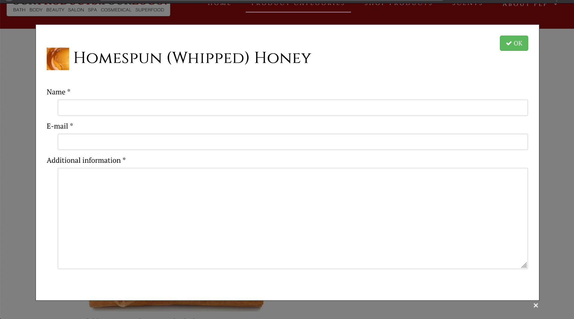

I would like to use the same form as a lightbox pop up. Since this post is more than 5 years old, wondering if there is any easier way of doing it now? Or do I have to modify the file like suggested 5 years ago?
If file needs to be modified, how can I make pop up as a full page lightbox? Please advise (sorry I have no coding experience!!). Thanks in advance

You would still need to edit the view file like suggested 5 years ago.
Which file to edit will depend on which contact button you want to change as there is both the button on the product details page and on the product listing.
To find which view file to edit, you can temporarily activate the "Display view files" setting of the HikaShop configuration and look at the page where you want to change the button:
Now supposing that you use the "default" product layout and that you're talking about the contact button on the product page, it's still the file product / show_default.php that you'll want to edit.
There you can replace the code:
<a href="<?php echo hikashop_completeLink('product&task=contact&cid=' . (int)$this->element->product_id . $this->url_itemid); ?>" class="<?php echo $css_button; ?>"><?php
				echo JText::_('CONTACT_US_FOR_INFO');
			?></a>
by:
<a href="<?php echo hikashop_completeLink('product&task=contact&tmpl=component&cid=' . (int)$this->element->product_id . $this->url_itemid); ?>" class="modal <?php echo $css_button; ?>" rel="{handler: 'iframe', size: {x: 760, y: 480}}"><?php
				echo JText::_('CONTACT_US_FOR_INFO'); JHtml::_('behavior.modal');
			?></a>
Note however that this might not work based on the template you're using.
Please also note that our support is to help you with the setup of your shop, not to do custom development work for free.
If you need more custom development work in the future you can use our contact form to discuss that with us:

Thanks a lot for your time and help. As per your note, your solution did not work probably due to the template I am using as per your concern.
And sorry I did not realise that such a small feature which should be a part of basic hikashop functionality would fall under custom job category.

The modal solution didn't work with the template we're currently working with either but we found that we could simply add the following to the code Nicolas provided previously and the contact button then uses the same styling already loaded for the product image modals.
<a rel="shadowbox" href ... and so forth

Another alternative, when you don't use shadowbox for the image popup could be to use a modals ( extensions.joomla.org/extension/modals/ ) tag to generate the popup.
So it would be:
{modal <?php echo hikashop_completeLink('product&task=contact&tmpl=component&cid=' . (int)$this->element->product_id . $this->url_itemid); ?>}<?php echo JText::_('CONTACT_US_FOR_INFO'); ?>{/modal}
