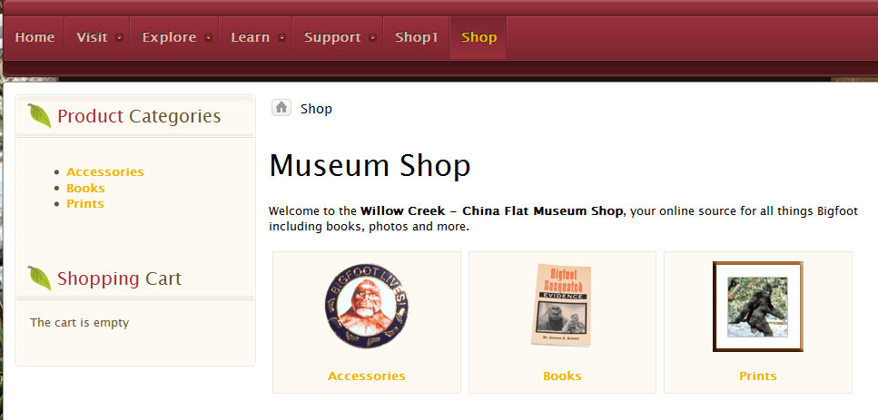

I proceed to create a new Content Module Category Listing named "Product Categories". I chose the type of layout: "List" and set the "Menu" field to point to the "Shop" menu I originally created. This resulted in a correctly functioning List of the categories in a module on the left side of the page. Unfortunately the list of categories in the module is not styled the same way as the other menu's on my site. It is just bullets and links.
I would really like to change whatever code necessary to make this list styled the same way as the rest of my site. I was unable to find any list styling in the frontend_default.css file and I could not find any documentation on using the "Parameters for Lists", "UL class name" field which seems like the place I would setup a class for the module to use.

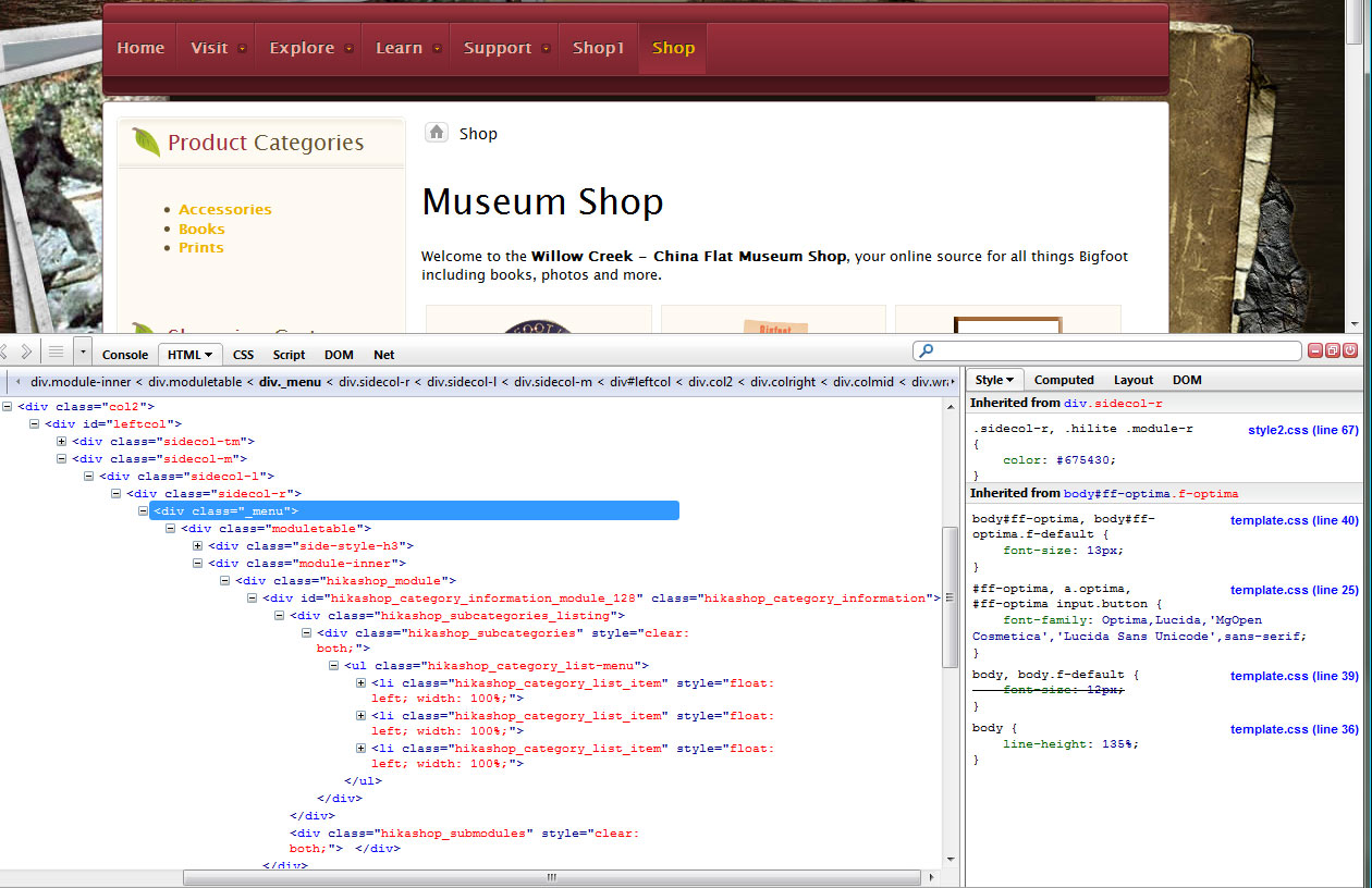

It depends on your template, but normally, you should be ok by setting the option modules class sfx to _menu in the options of your module (not the hikashop options, but the joomla options).
Thus, the module's class will become module_menu instead of module which, for most templates, is the class of the menu module. So your categories will display like menu items.

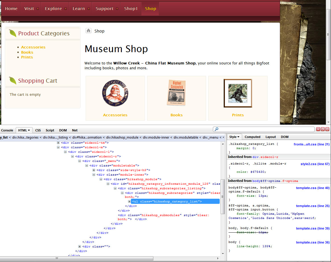

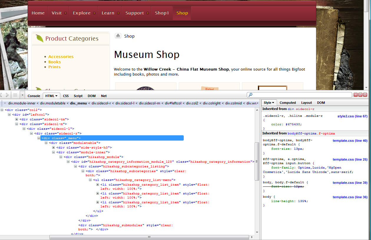

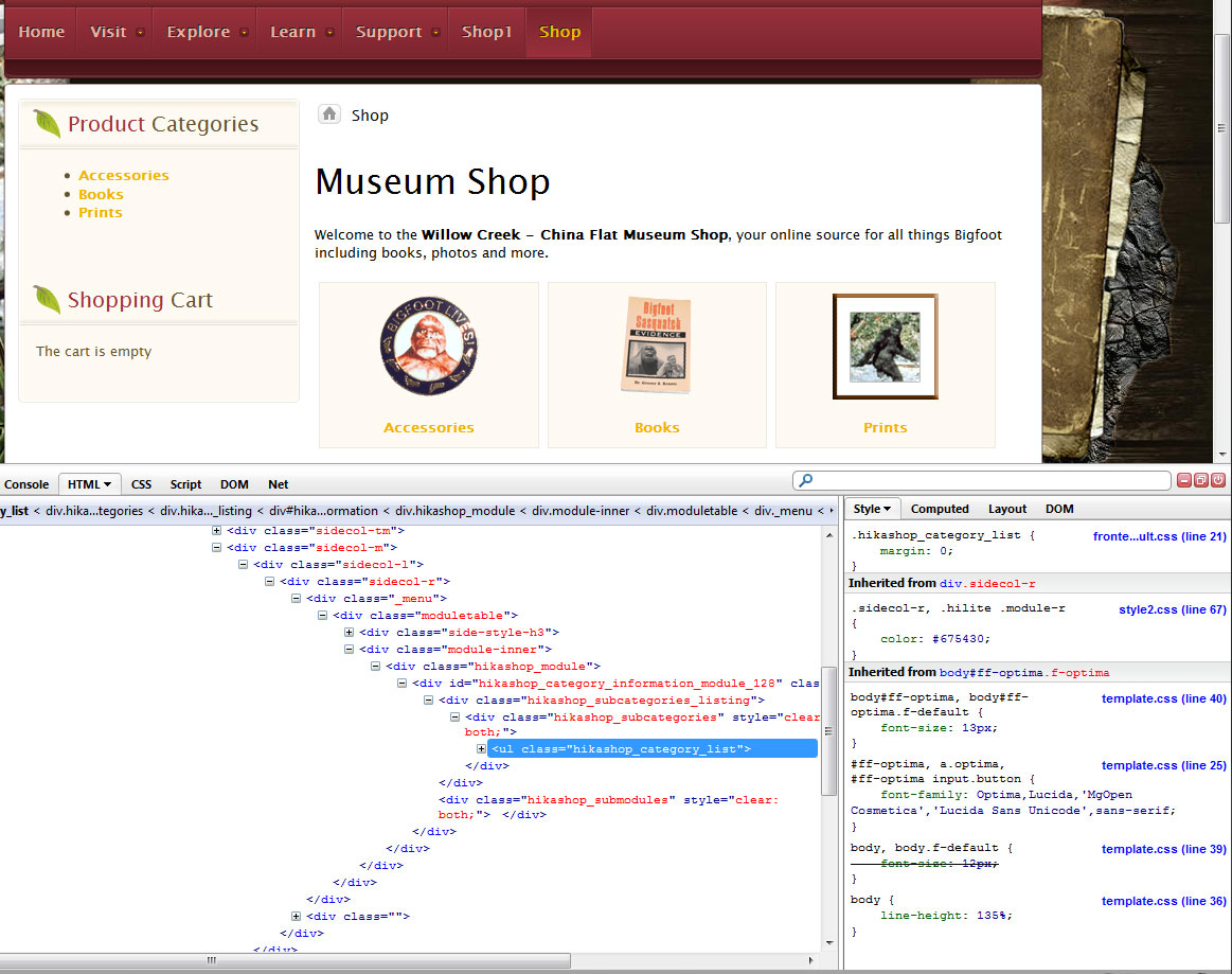

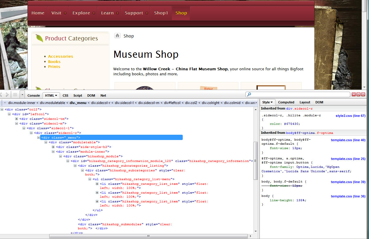

I tried your suggestion but it didn't have any effect.
I am attaching a screenshot of the firebug results after adding _menu to the module suffix.
Last edit: 15 years 7 months ago by wwatty. Reason: Fixed incorrect image

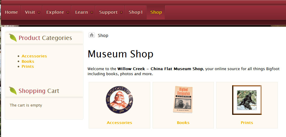

  • Posts: 26
15 years 7 months ago #7062

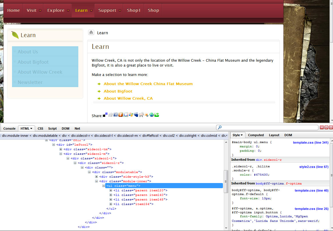

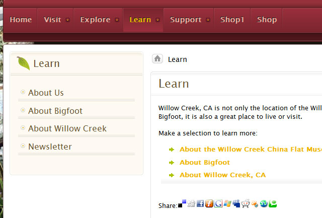

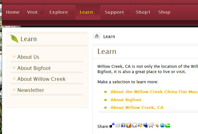

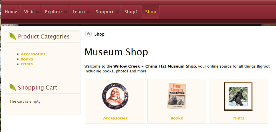

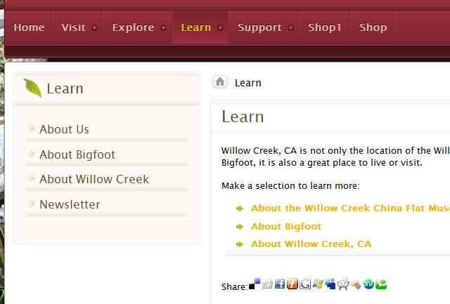

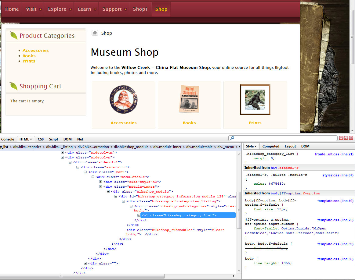

Here are the two modules for comparison:
The menu module for my template normally looks like this:
The HikaShop module looks like this:

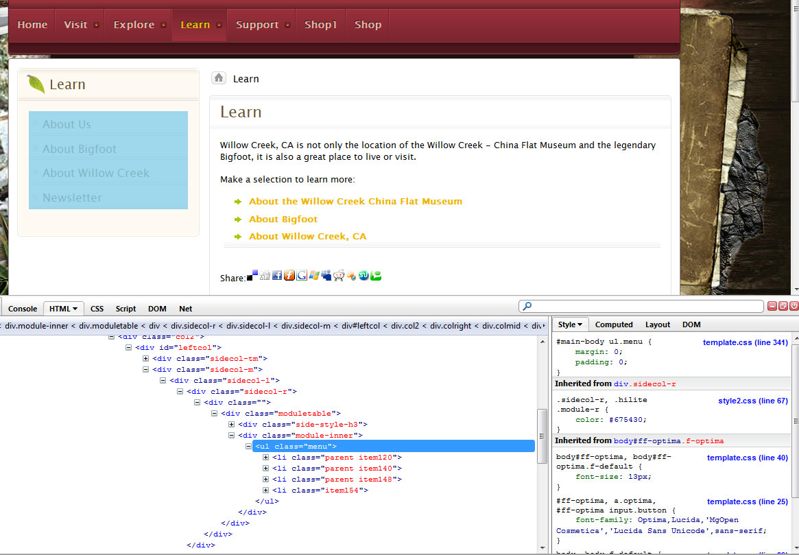

  • Posts: 26
15 years 7 months ago #7063

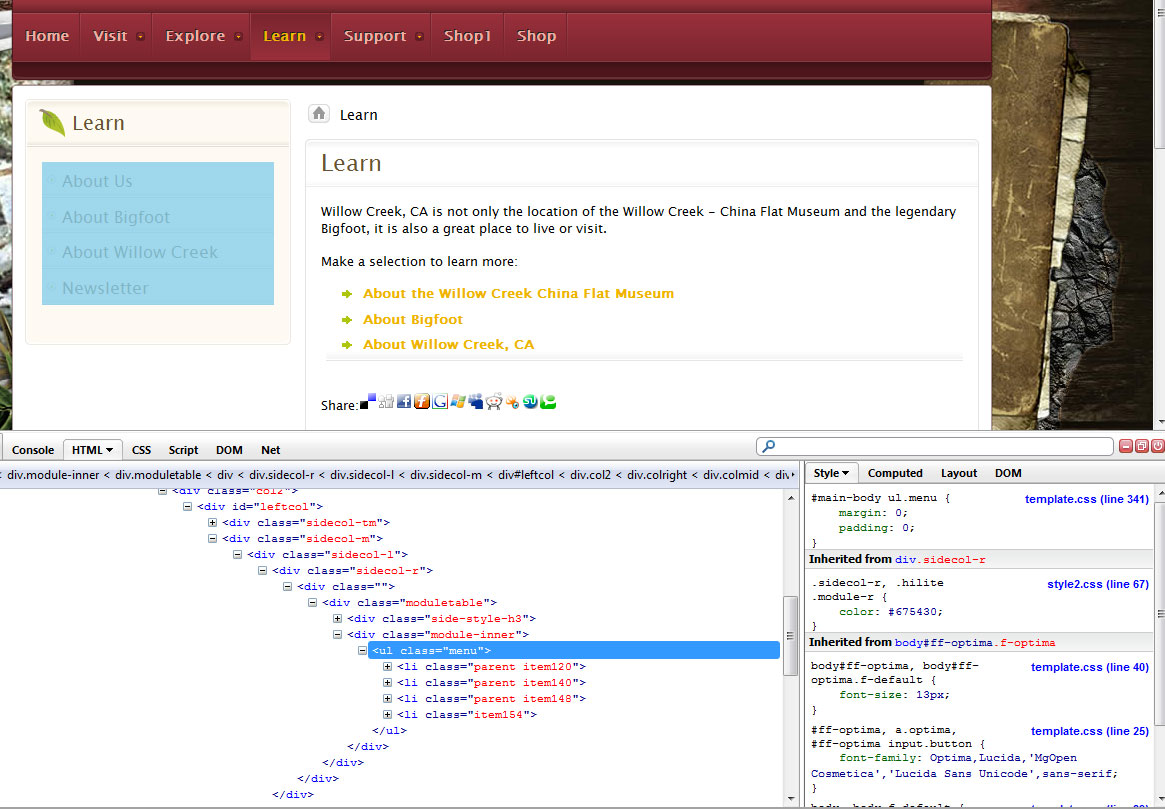

For code comparison purposes this is what the firebug code for the menu looks like. Apparently the ul class looks like the main difference.
In Hikashop the ul class="hikashop_category_list"
In the module I want to mimic the style of the ul class="menu"
  • Posts: 26

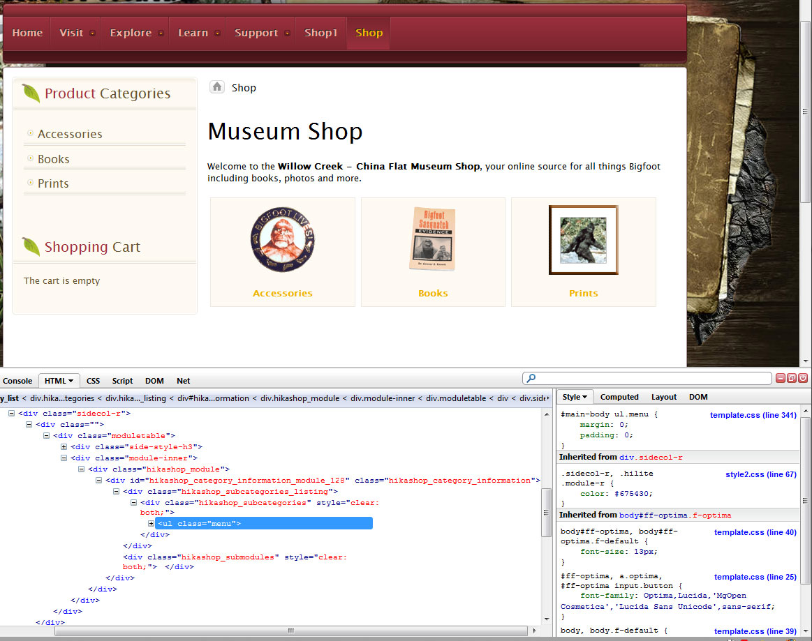

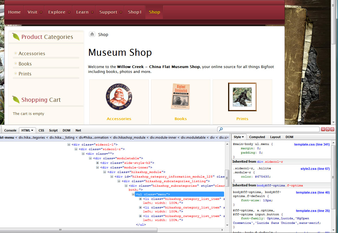

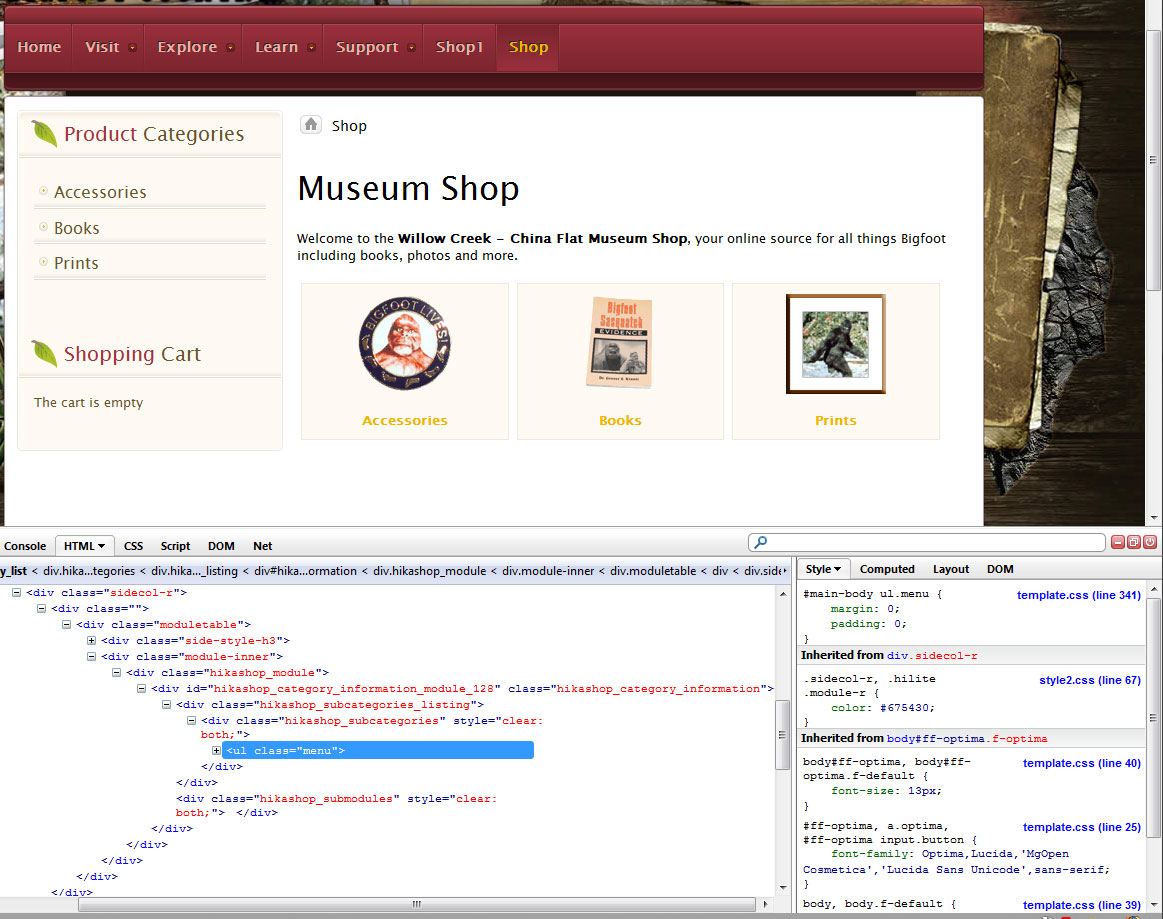

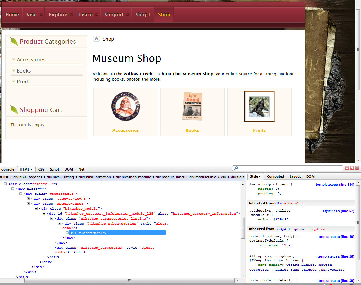

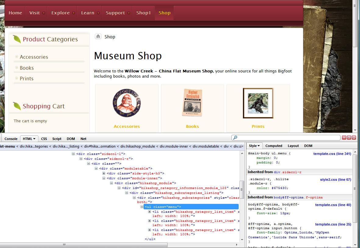

15 years 7 months ago #7064
And in fact making the change in firebug from ul class="hikashop_category_list" to ul class="menu" changes the style to look correct as seen in this screenshot. Unfortunately I do not know where that code exists in Hikashop to change it. If you could let me know which file I need to look in, I can fix the problem.
Last edit: 15 years 7 months ago by wwatty. Reason: fixed image
  • Posts: 26
15 years 7 months ago #7065
I think I fixed it but please confirm if this is the correct way:
In Joomla Admin I opened HikaShop => Display => Views and chose listing_list.
I changed the same code 3 times in that document from
<ul class="hikashop_category_list<?php echo $this->params->get('ul_class_name'); ?>">
to
<ul class="menu<?php echo $this->params->get('ul_class_name'); ?>">

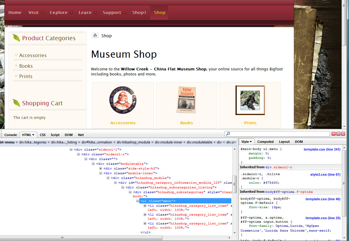

  • Posts: 86177
  • Thank you received: 14212
15 years 7 months ago #7070
You should leave the code and just set " menu" (without the quotes) in the UL class option in the hikashop options of your module.
That way you will have your attribute like this: class="hikashop_category_list menu"
That way, you will have the default class hikashop_category_list and the menu class both used for the UL tag.
  • Posts: 26
15 years 7 months ago #7073
Perfect, that worked. This can be marked solved.
