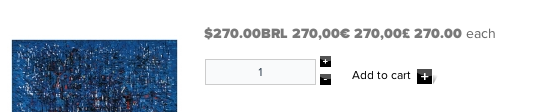

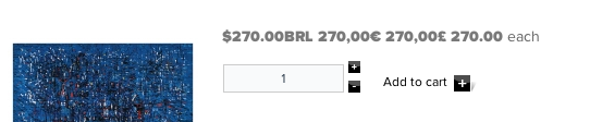

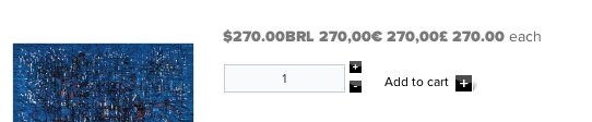

Thanks, i've replaced some of the content in the template with the code you suggested. It now displays all the currencies, though they are in a line and also the same numerical value though the correct currency icon is displayed, just the different values aren't.
Last edit: 13 years 10 months ago by WillPatterson. Reason: add image

13 years 10 months ago #71771
Is it possible to show the "converted currency" prices as well as the main default cost, one below the other?

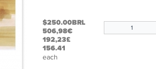

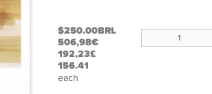

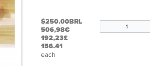

However it seems to put the currency icon in the wrong order (before the line return) so i get the attached picture
If i can get this solved i'd like to be able to wrap the currency icons in a class and the converted prices in another class so i can style them all individually, if you can point me in the right direction to doing this it would be appreciated and i am very thankful for all your assistance with this, regards...
13 years 10 months ago #71842
You can maybe try to put the "<br/>" before, like: echo "<br/>".$this->currencyHelper->format($dollarPrice,$dollarId);
To add classes on the symbol and on the value, you will have to use the PHP function str_replace() like:
echo "<span class='currValue'>".str_replace('$','<span class=\'yourClass\'>',$this->currencyHelper->format($britPrice,$britId))."</span></span>" ;
Be careful on the span order, because some currency symbol are before the value and other after.

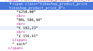

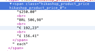

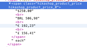

Hi, i've tried putting it before and after but it doesn't seem to make any difference. In looking at the source code of the outputted page it show the output correctly though it seems to change the break tag to a <br>.
  • Posts: 16
13 years 10 months ago #71883

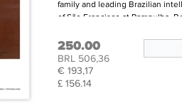

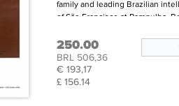

okay, i have nearly got this working how i want it to but it seems to be stripping out some of the information, seemingly the $ sign as the dollar price just doesn't show in the output, as the dollar price just shows the price and no symbol and the Brazilian Real just show the iso code BRL and not the symbol R$ as it's configured in the currency setting. Any ideas as to what would be causing this?, thanks again...
13 years 10 months ago #72025
Are you using the code:
Because in this code, you have to add the currency symbol after "<span class=\'yourClass\'>" like:
echo "<span class='currValue'>".str_replace('$','<span class=\'yourClass\'>$',$this->currencyHelper->format($britPrice,$britId))."</span></span>" ;
For the BRL, with the str_replace you can change it with R$ like:
echo "<span class='currValue'>".str_replace('BRL','<span class=\'yourClass\'>R$',$this->currencyHelper->format($britPrice,$britId))."</span></span>" ;
