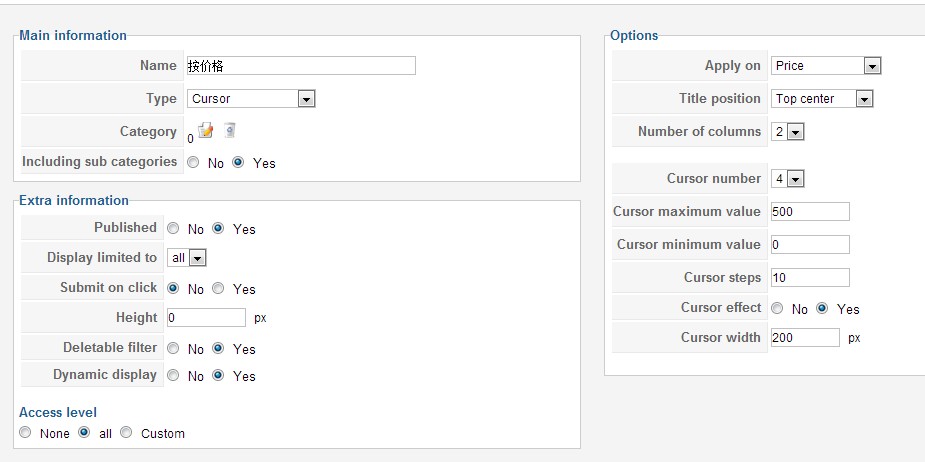

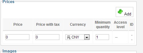

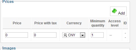

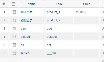

I used a filter for price,
but this filter will disappear my product with price 0
It only show the price >0,
So how can I solve this issue?

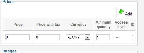

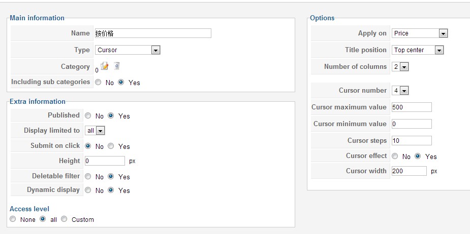

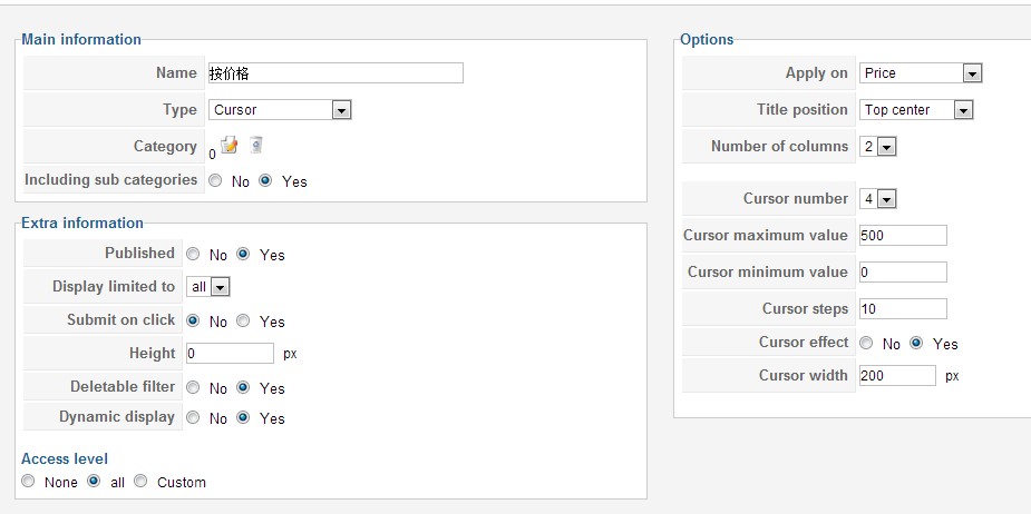

13 years 10 months ago #72712
Can you show me your filter configuration with some screenshots and give me your website address ?
  • Posts: 24
13 years 10 months ago #72721

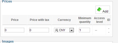

13 years 10 months ago #72742
It's actually working for me with your configuration, can you give me a link where you're using this filter ?

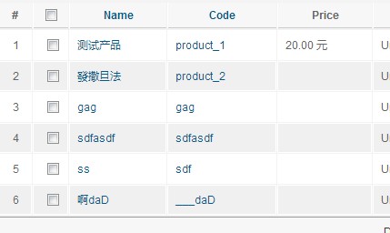

  • Posts: 24
13 years 10 months ago #73406
Thank you,

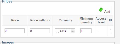

The conflict with widget has been solved by installing easy plugin,
But the issue that the products with price 0 are still disappear.
  • Posts: 86114
  • Thank you received: 14210
13 years 10 months ago #73621
Please add the line:
if($main_currency!=$currentCurrency) $case .= ' when b.price_currency_id IS NULL then 0';
before:
$case.= ' end ';
in the file administrator/components/com_hikashop/classes/filter.php and that should fix the problem.
