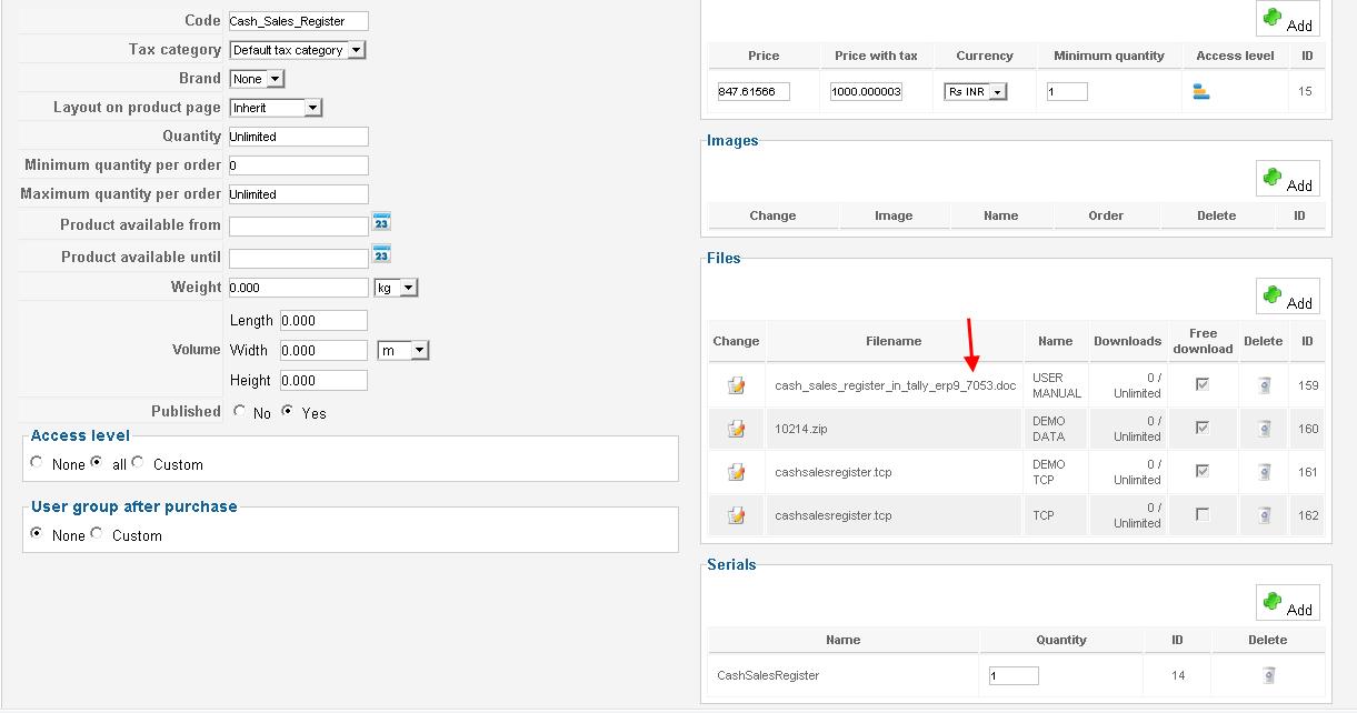

While uploading a file, say some "xxx.doc"; an underscore and a number is being appended automatically after the upload that it looks like some "xxx_1234.doc".
Please find the attached screenshot.
What could be the problem?

It means that the file "xxx.doc" already exists.
HikaShop does not overwrite existing files so it appends a random number in order to have a non existing filename.
