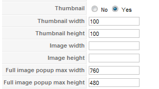

Also, please make sure that you didn't set the image width and height in the config under the tab files. Because that will make the system resize your images to those values. If you don't want to change the images size but only the tumbnails you should set the thumbnails size options on that same screen.
  • Posts: 46
15 years 7 months ago #7376
The thumbnail is on 100 x 100 and nothing in the other field.
But the picture is still thumbnail size on the frontpage.
www.infossa.com/business/product/show/ci...egory_pathway-0.html

If it re sizes a picture on the product page from 150*150 to 100*100, than a bigger picture will be re sized.
I just uploaded a picture that was 364*293 and its 100*80.

It's not resized. The thumbnail is resized yes.
If you want to not have the thumbnail on the product page but the full image you need to look at that thread:
www.hikashop.com/en/support/forum/4-how-...oduct-page.html#3777
