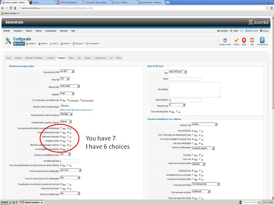

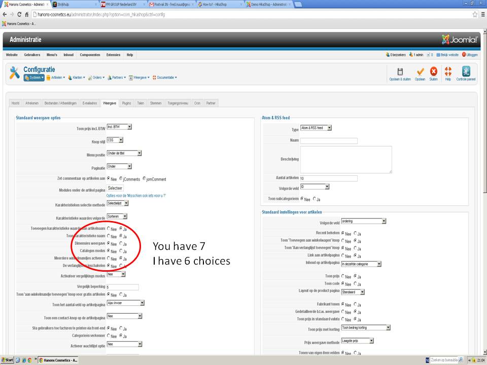

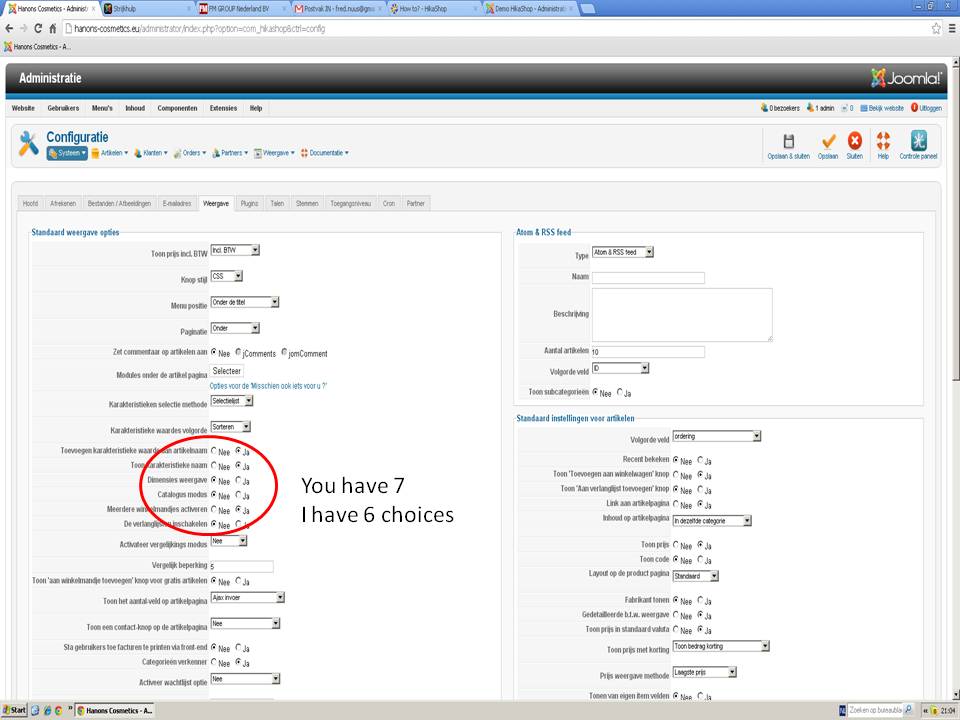

13 years 10 months ago #74331
Thanks for your answer, but i don't have that option. !!!
see the Print Screen
  • Posts: 86114
  • Thank you received: 14210
13 years 10 months ago #74352
That option has been added since HikaShop 2.0.0
For previous versions, you will have to hide it with such CSS:
.hikashop_product_weight_main{ display:none !important; }
