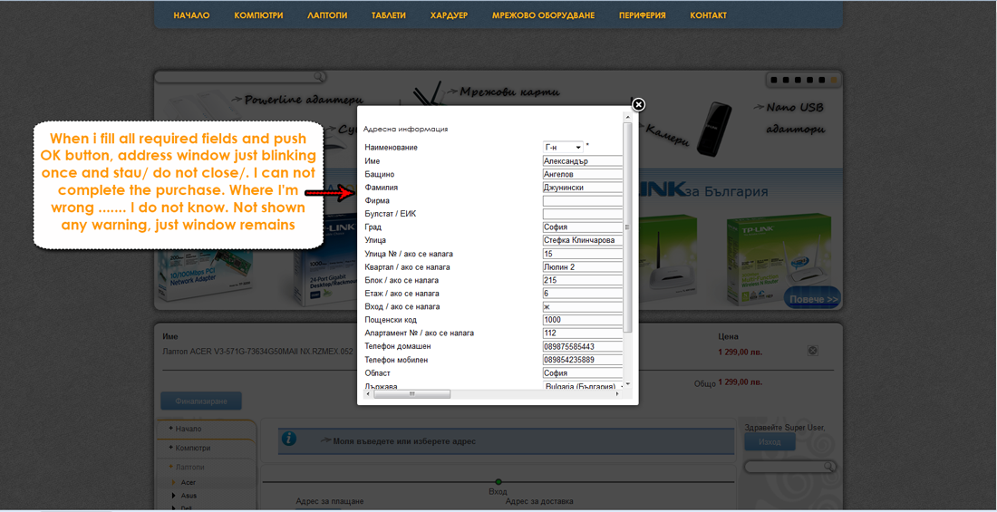

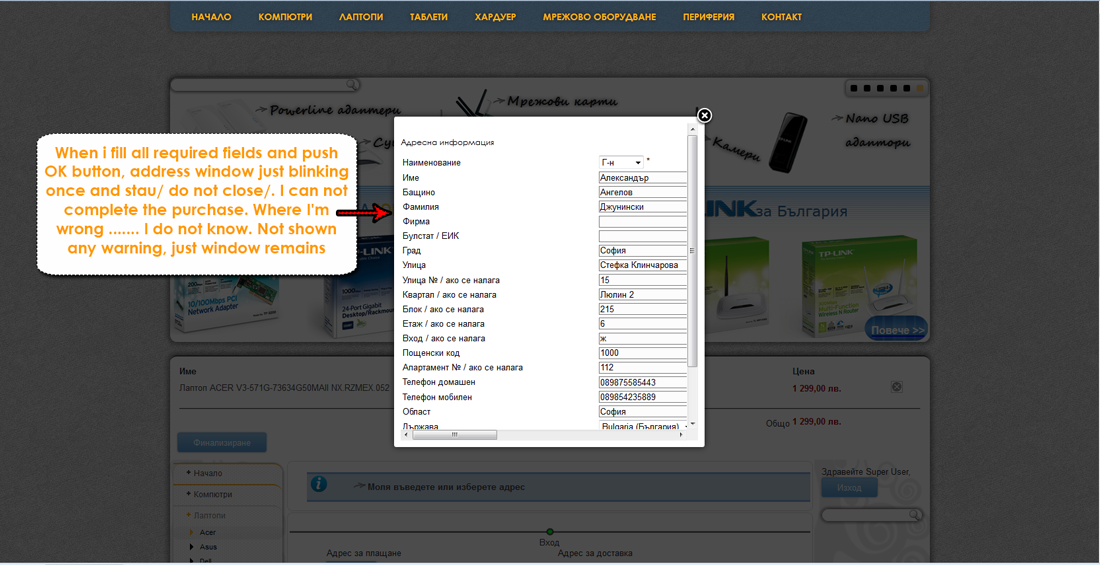

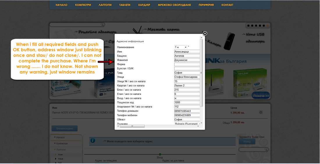

13 years 7 months ago #87845
Hi, i have little problem with checkout address window
Please help me.....:)
virtualnazona.com/ct-menu-item-10/ct-menu-item-14.html This is a link to our site, try to order.... :(

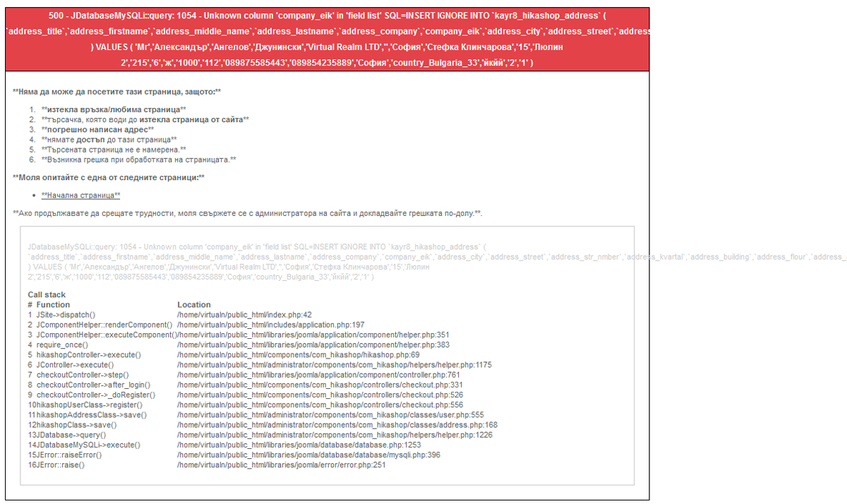

13 years 7 months ago #87914
Can you enable the Joomla debug mode and increase temporary the level reporting to maximum ?
And see if an error is returned.
The following user(s) said Thank You: Vzona

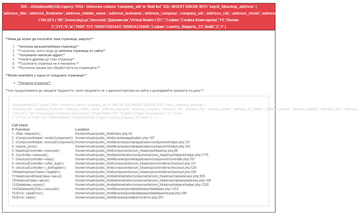

  • Posts: 16
13 years 7 months ago #87916
Deug mode is on and show me this windows
What should I do?

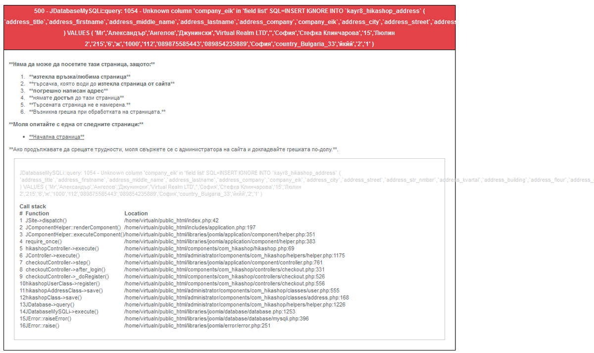

13 years 7 months ago #87958
You have a missing column in your database, the column 'company_eik' in the table kayr8_hikashop_address.
Try to disable the custom field 'company_eik'. Or add the column in your database via your phpMyAdmin
