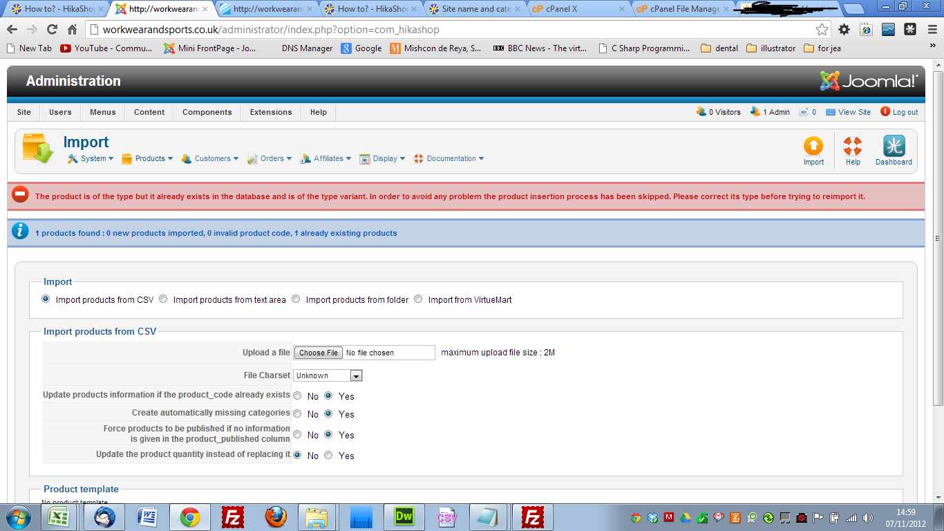

Hi I have major issues for my shop which is in the final stages before it goes live.
I need to update the variant stock levels. Whenever I try to do this I get the error message
The product is of the type but it already exists in the database and is of the type variant. In order to avoid any problem the product insertion process has been skipped. Please correct its type before trying to reimport it.
and also
1 products found : 0 new products imported, 0 invalid product code, 1 already existing products
product_id product_quantity product_code
1085491 91 148757
I have tried importing with and without the product ID.
For the main products to populate the descriptions I simply used product_code and the product_description fields only and this worked fine.
I have attached the file with the entry.
If someone could please help.
Kind regards
Nav

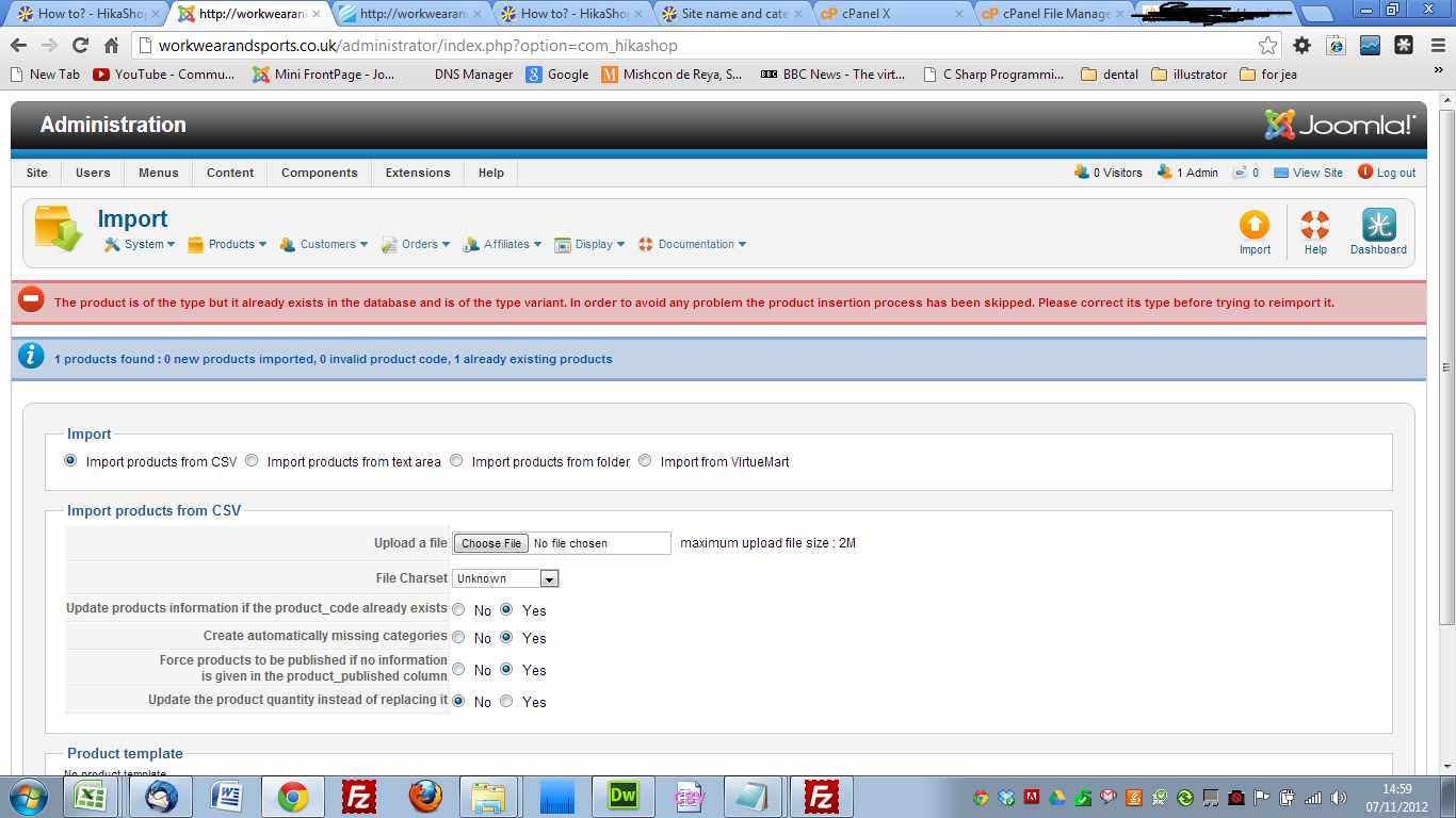

  • Posts: 46
13 years 10 months ago #74774
Hi I have update to the latest version with thanks to Nicolas as usual.
But I still have the same problem, see attached screenshot
