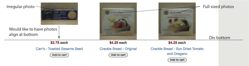

1. For photos that are smaller than the the specified height (Configuration > Files/Images), how do I make the product photos align at the bottom of the view port?

Hi Xavier,
Thanks for the info. I was able to easily modify the checkout strings, but haven't gotten anywhere with the first question. I tried a number of different edits to frontend_custom.css, none of which worked. I'm wondering if I need to edit a style definition elsewhere... I've attached a figure to clarify what I'm trying to do.

13 years 10 months ago #75251
Could you give us a link to your website ?
It's possible that you template override some properties, then try to do the modification in the css file of your template.

13 years 10 months ago #75972
Hi Xavier,
I don't think the template is overriding some properties because I get the same result with other templates (I tried three additional ones). The website is
test.cheese2go.ca/index.php/shop-main
Dave

13 years 10 months ago #76156
That's the correct way to change CSS.
However, to do what you want, it's actually quite complex CSS that you need:
.hikashop_product_image_subdiv{
position: relative !important;
height: 100% !important;
.hikashop_product_image_subdiv a{
position: absolute !important;
bottom: 0px !important;
margin: 0 75px 0 -75px !important;
.hikashop_product_image_subdiv img{
We tested it on your page with firebug and it's doing exactly what you want.
