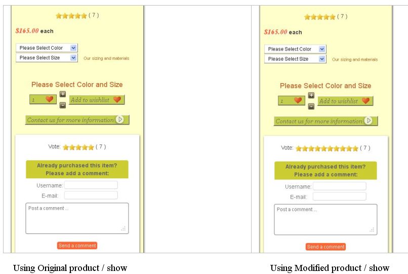

13 years 9 months ago #76275
When I made the change to product/show it added more stars.
My product/show_default doesn't seem to match what you gave me.
Let me attach my versions of the 3 views that you mentioned,
and see if that helps.
Last edit: 13 years 9 months ago by tumbleweed.
13 years 9 months ago #76324
I don't see why more stars appears, because the modifications just moves some code from one view to another one.
Could you do the modifications again, and give me a link to your website ?
