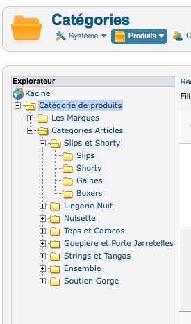

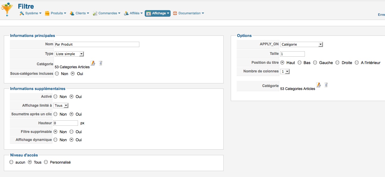

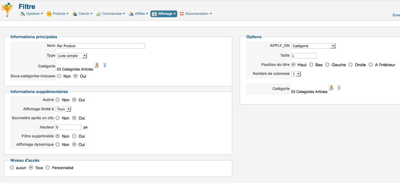

I have one category1+ 5 subcategory2 (below category 1) + 5 sub-subcategory3 (below sub category 2). I created one filter based on category1. My products are classified into sub-subcategory3. I also created one menu with category1 displaying perfectly all products of all subcategory2 or 3. This menu is hidden.
The filter displays properly the list of subcategory2 but on click any produtc displayed.
Thanks for your help

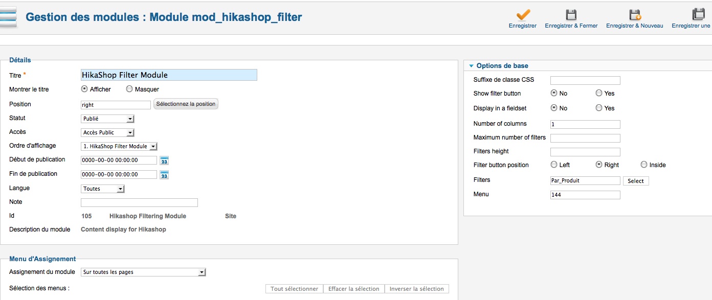

13 years 10 months ago #75708

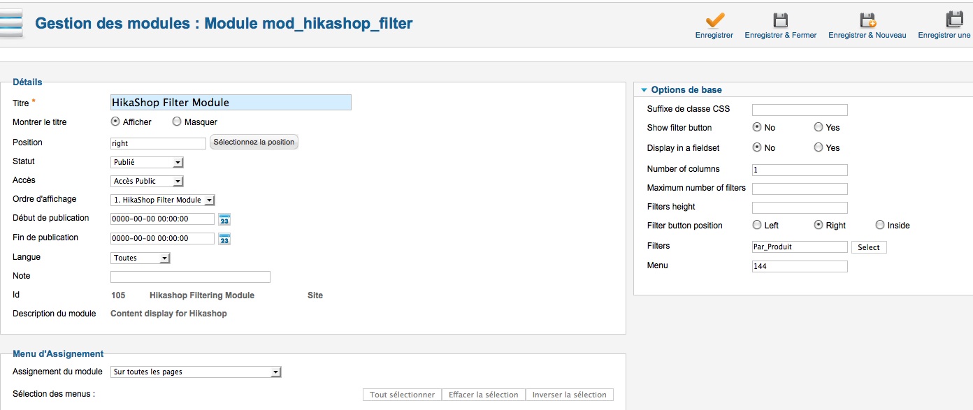

We will need information on how you configured your filters/filter module in order to help you.
Could you provide screenshots of your filters options and your filter module options ?
  • Posts: 149
  • Thank you received: 6
13 years 10 months ago #75828
Here are screenshots

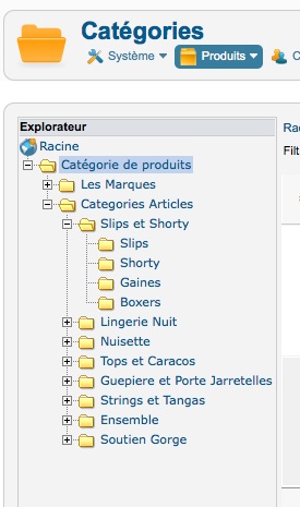

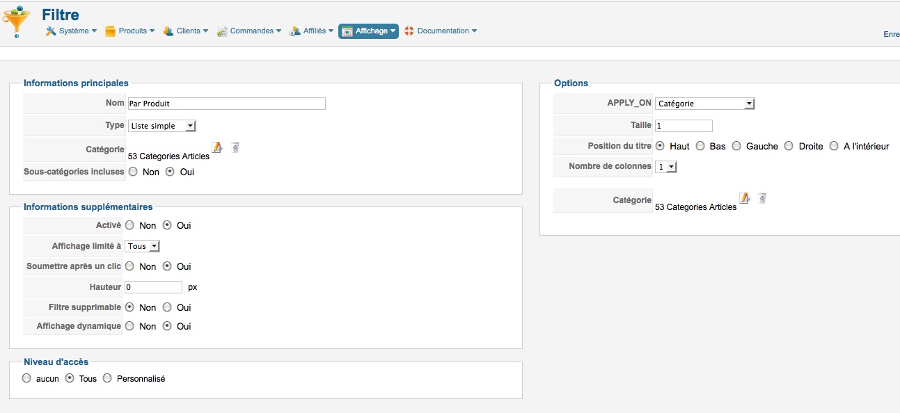

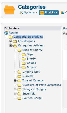

13 years 10 months ago #75829
so ryy extensions were not right
  • Posts: 149
13 years 10 months ago #75832
  • Posts: 149
13 years 10 months ago #75833
  • Posts: 149
13 years 10 months ago #75834

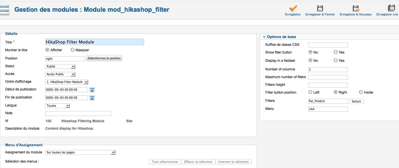

  • Posts: 86114
  • Thank you received: 14210
13 years 10 months ago #76024
Please make sure that the menu item with the id 144 that you set in the "menu" option of your module is a products listing menu which lists all your products.
Also, please make sure that you're using the latest version of HikaShop.
  • Posts: 149
13 years 10 months ago #76140
I checked version : it's latest (2) I checked menu 144 it's listing of products and option "all sub-elements" then it doesn't work. What to do ?

13 years 9 months ago #76513
The menu with the id 144 was unpublished. I've published it for you and it's working now.
