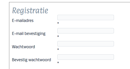

How can i change the position of the asterix in for example the registrationform? This seems to mess up a good lining. :silly:
Tried to make changes in the template but that doesn't seem to work.

The problem is probably coming form the css of your template. You should use firebug of something similar to check if there is some css making this happens.
If you can't figure where does the problem come from, just give me a link to the page so I can check it by myself :)

So it looks like in one of your css file. You have a width: 100%; to remove in these lines:
input[type="text"], input[type="password"], input[type="email"], input[type="url"], textarea
  width: 100%;
  padding: 1px 0;
  font-size: 13px;
  font-family: Nobile, Arial, 'Arial Unicode MS', Helvetica, Sans-Serif;
  font-weight: normal;
  font-style: normal;
