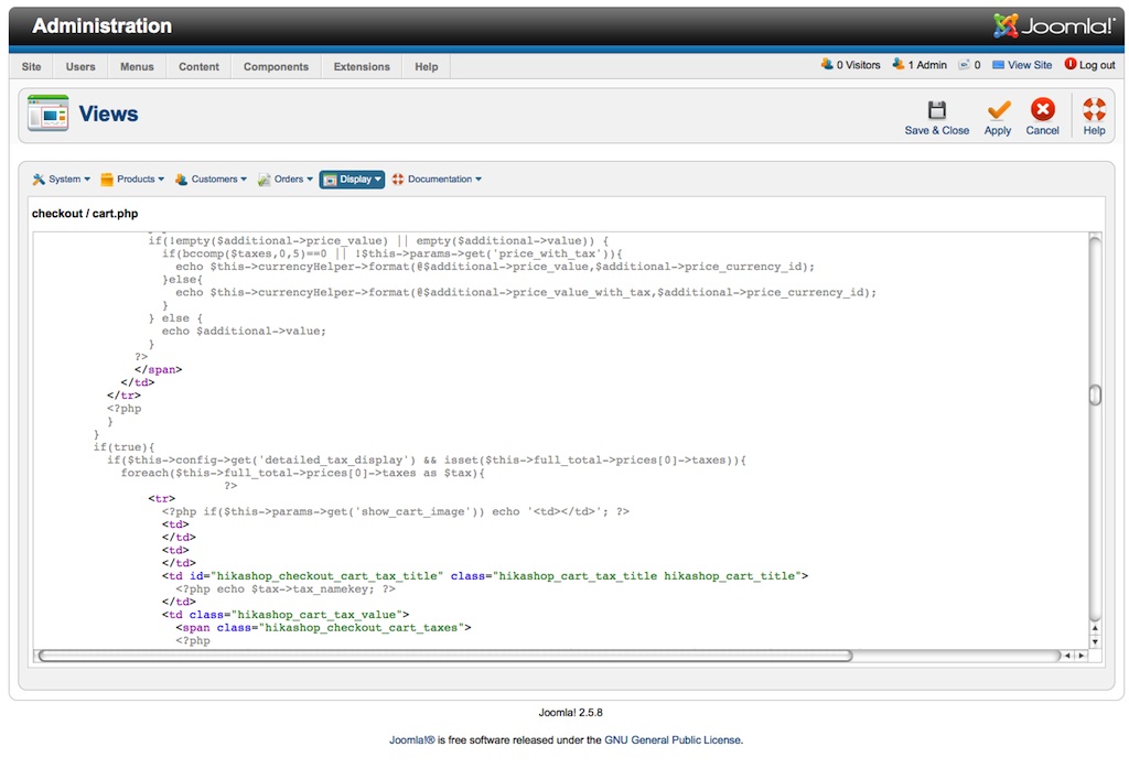

  • Posts: 55
  • Thank you received: 4
13 years 9 months ago #77095
That didn't seem to work. Sorry, I can't give you any more info other than the zero tax doesn't show up after making that change.

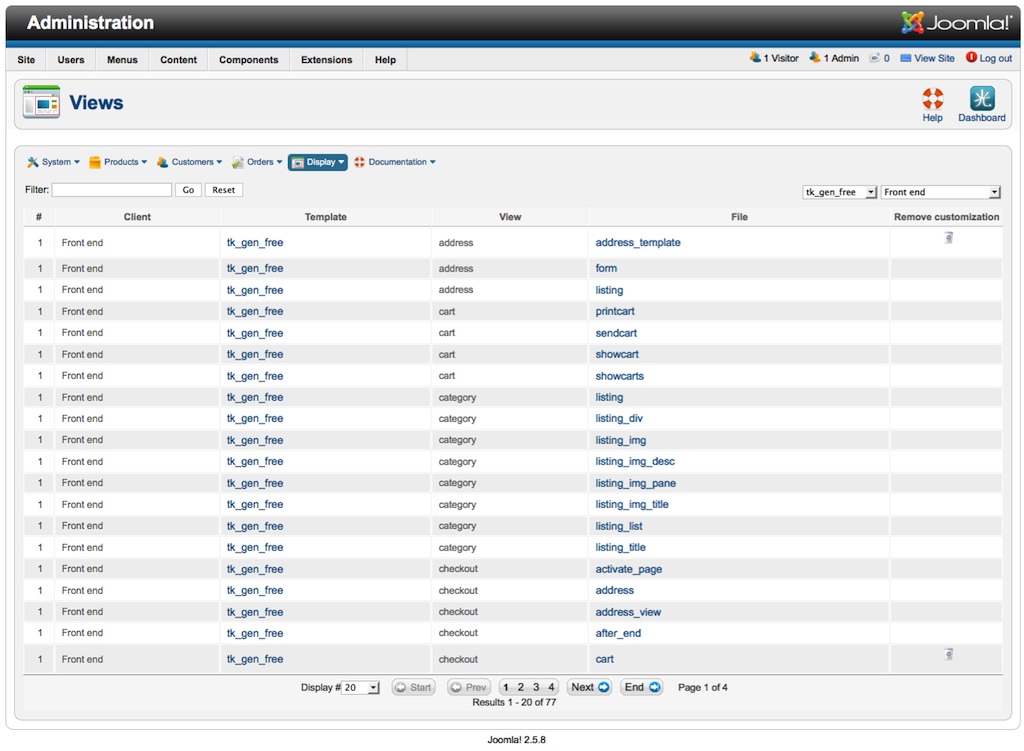

  • Posts: 55
13 years 9 months ago #77232
Yes, I'm as sure as I can be. After going to Display > Views, I select the template and 'Frontend' from the dropdown menus at the top right. I then edit the checkout/cart option (last line in the screen shot ZeroTax1.jpg), and make the change you suggested at line 185 (or so).

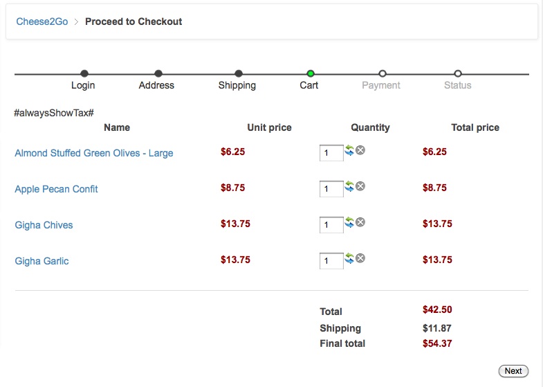

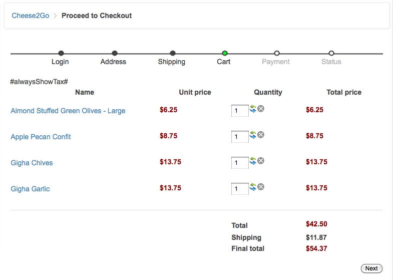

  • Posts: 55
13 years 9 months ago #77745
Yes 'Detailed Tax Display' is enabled in Configuration > Display. The added tag also shows up on at checkout after editing the same file as before (see attached image). Still no zero tax.
