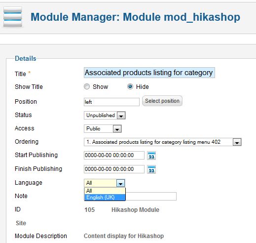

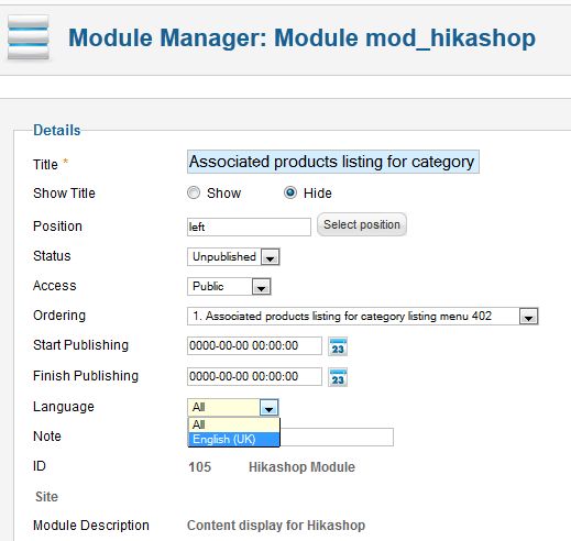

  • Posts: 9
13 years 9 months ago #77061
Here's what I see under details, just found it by the way :blush: I"m running 1.5.25 by the way.
Last edit: 13 years 9 months ago by Sysgen.
  • Posts: 26385
  • Thank you received: 4077
13 years 9 months ago #77165
Here a screenshot of a Joomla Module.
As you can see, there is a Language option.
