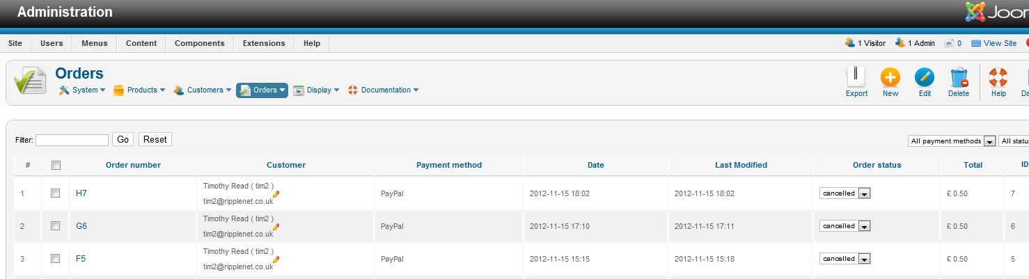

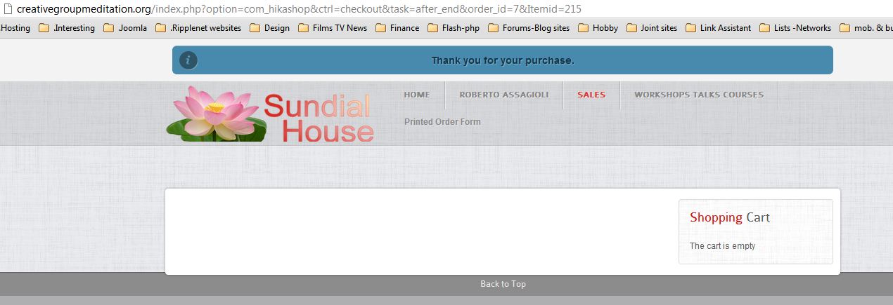

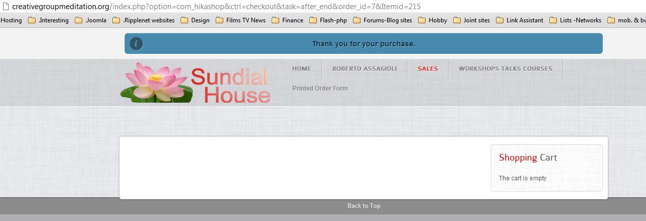

I can go through to paypal and then pay - and paypal takes the money out my account. I get a confirmed payment message (attachment 2), but I get a cancelled order status (attachment 3)
And there is no way to download the virtual product file.

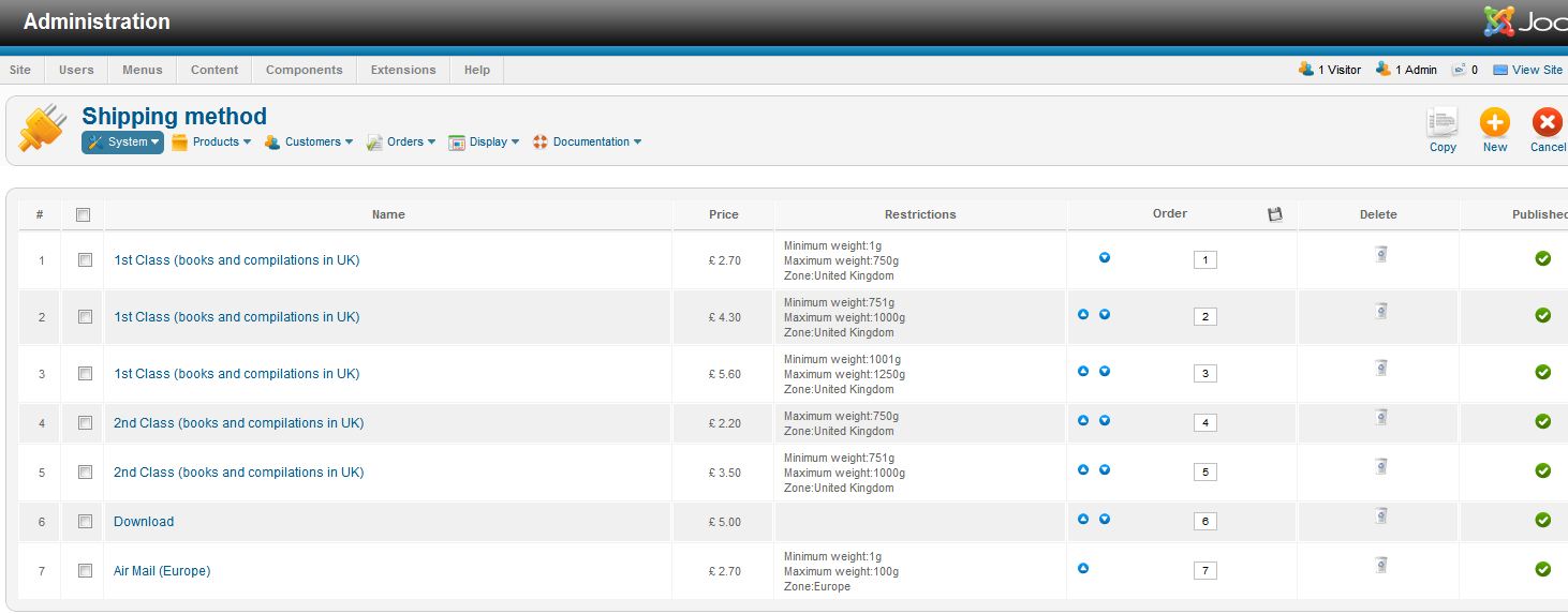

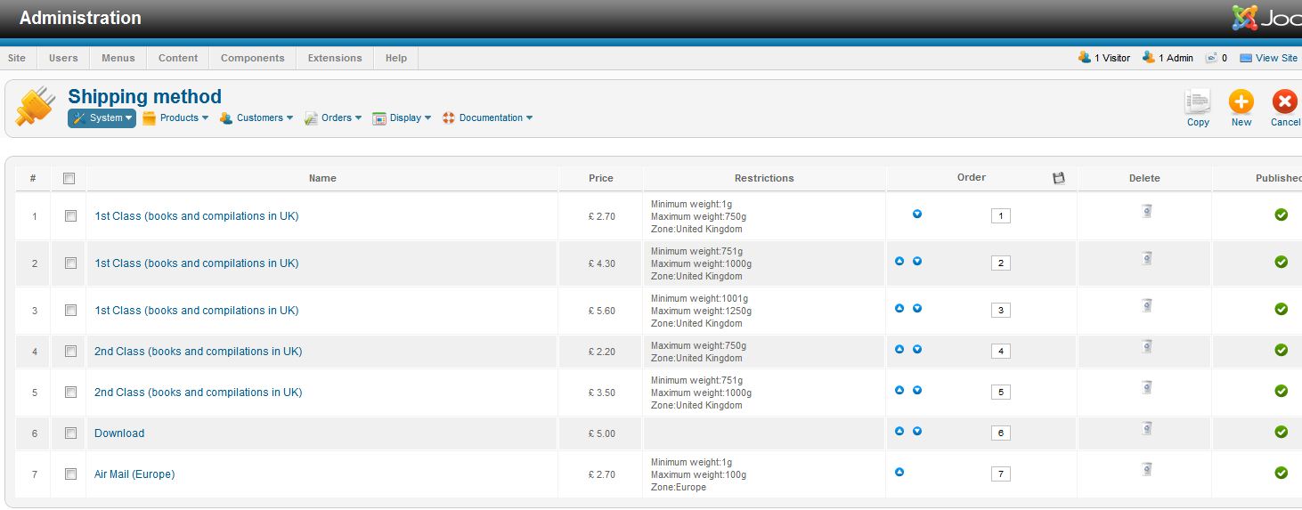

I set up the manual shipping plugin - (attachment 4)
Can you point me to where I am going wrong?

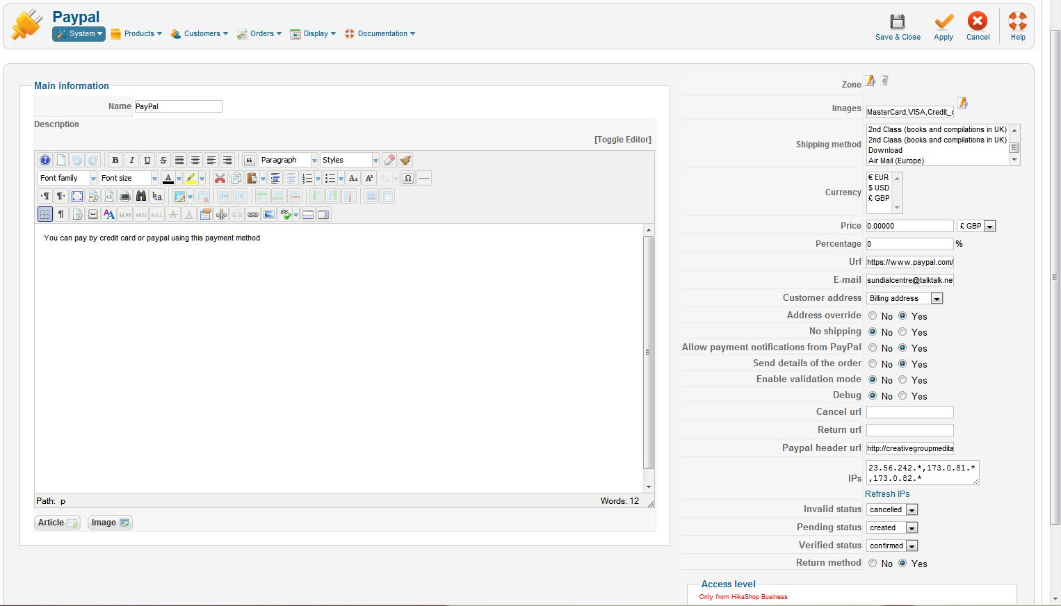

Could you please do a screenshot of the options of the paypal payment method options screen via the menu System->Payment methods ?
  • Posts: 12
13 years 9 months ago #77214
OK - here you are:
Tim
